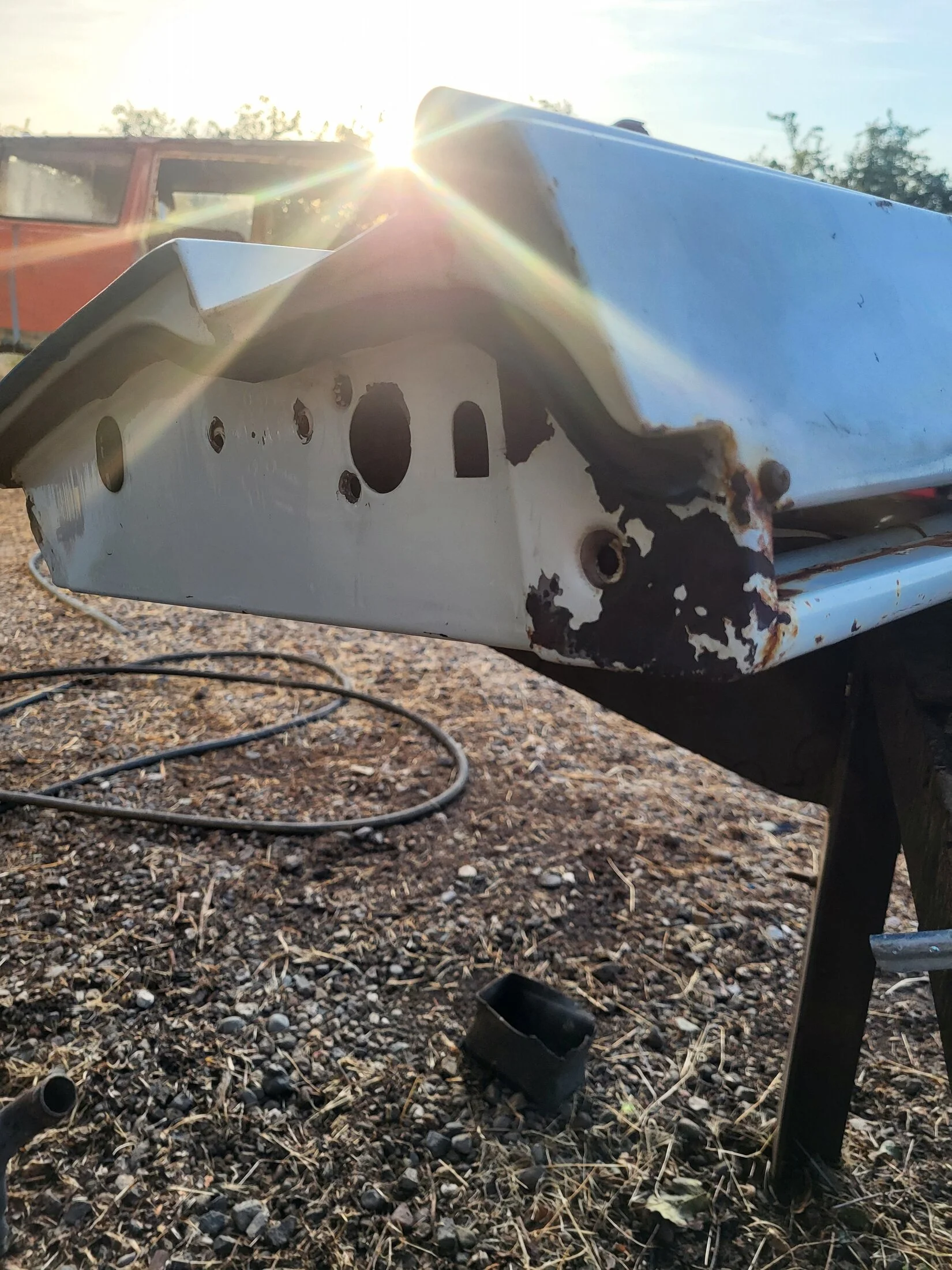

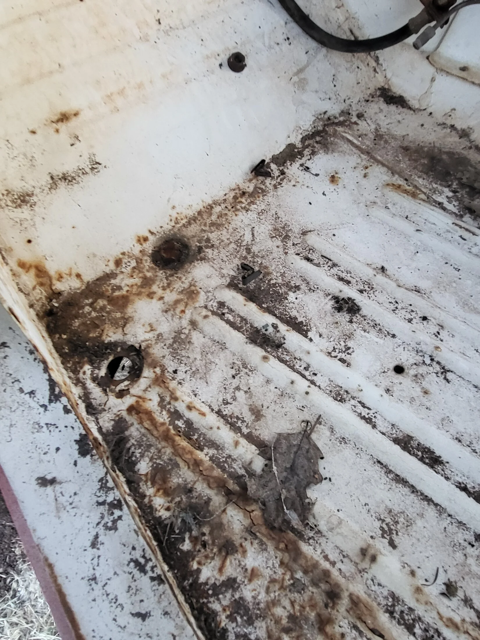

#1 nearly zero rust. It's got 2 tiny sections that need a patch, but everything else is very solid.

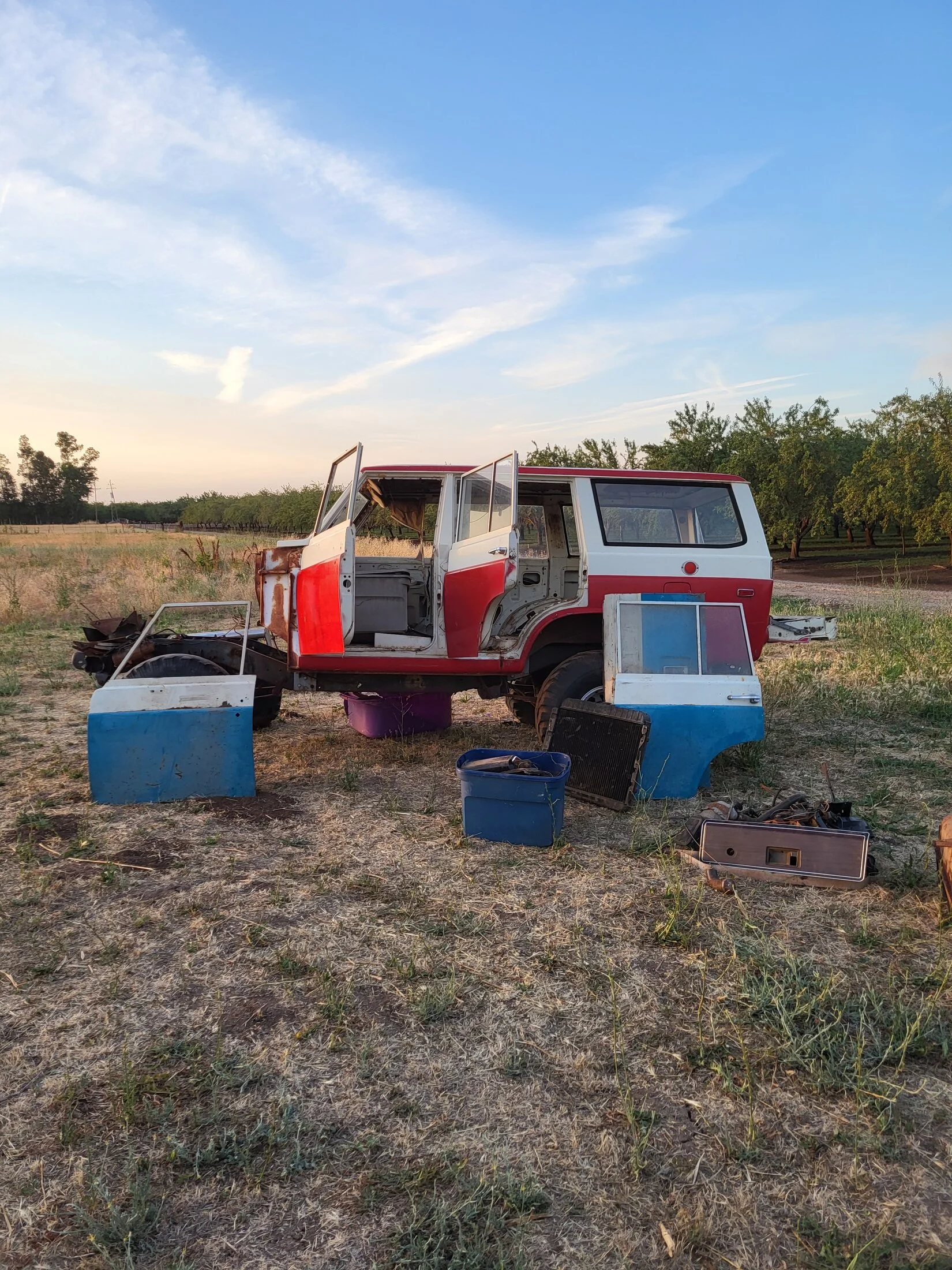

Surprise! Someone stripped this landcruiser down and stashed all of the parts, plus some K5 blazer parts, and some other junk which isn't any more or less useful than scrap metal.
There's actually 2 landcruisers worth of parts stashed inside.
Estra doors, extra hood, new, straight, front clip.

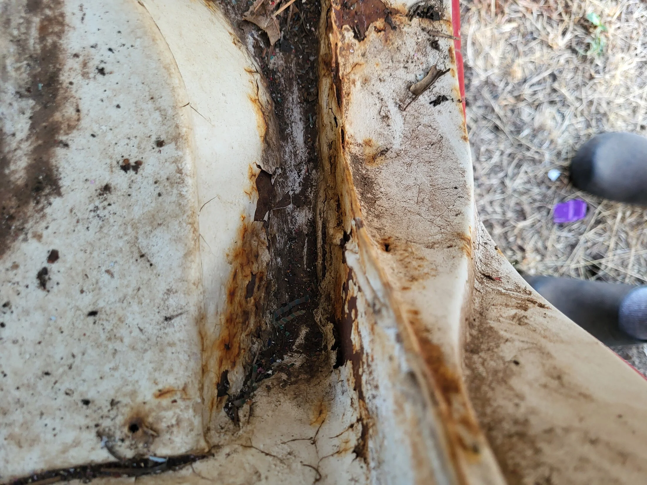

This new truck has less rust in it than my green truck had when I bought it 22 years ago. The rust that it does have is on the surface and has only penetrated in a few minor localized spots.

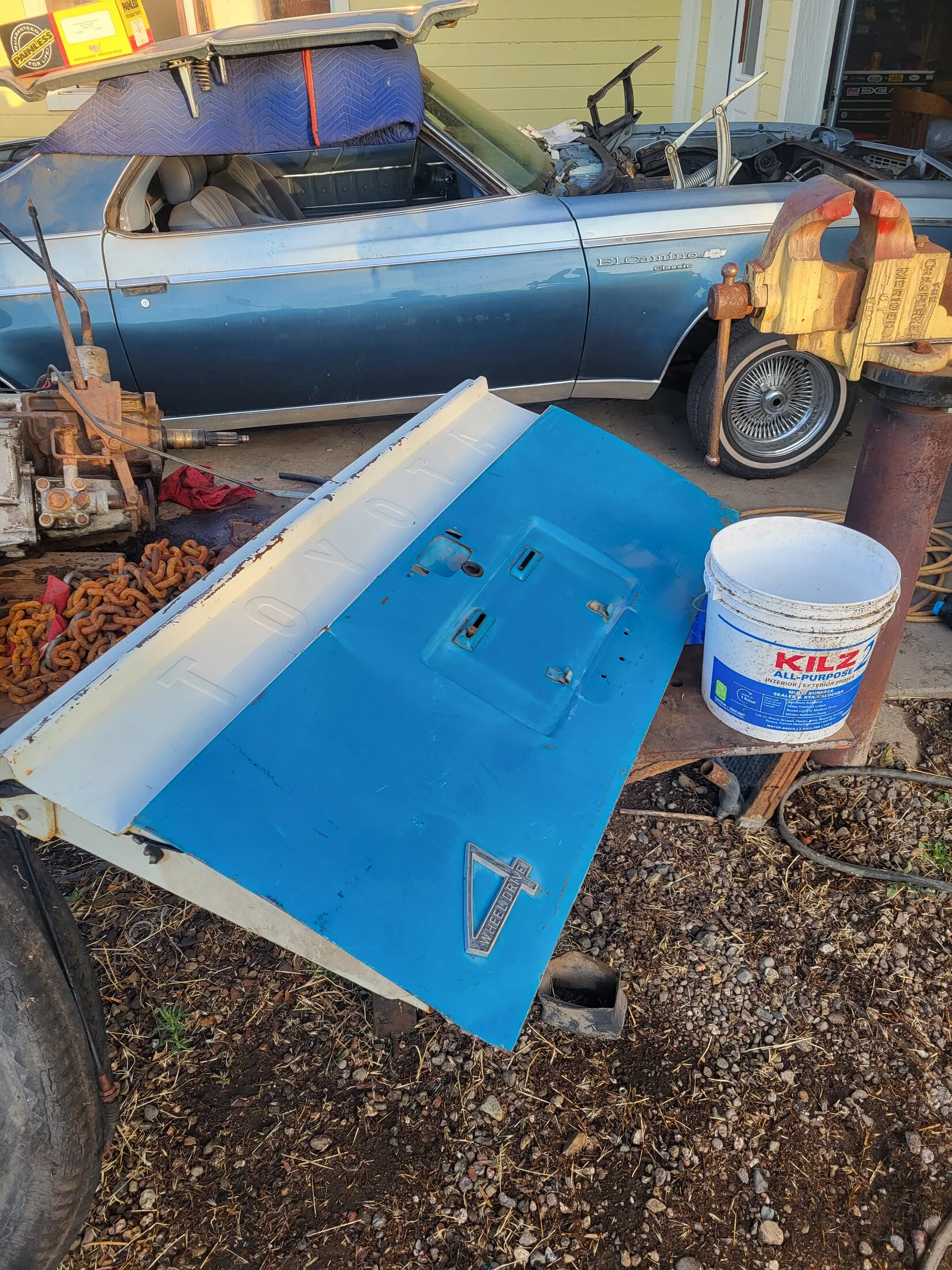

I bought a gallon of CLR for cleaning the old rig up, I used a bit on my sister's El-Camino and it worked well for engine bay grime, so I brought this fj55 tailgate to the front and scrubbed it up with scotch Brite pads and CLR.
It came out great. The rust requires some scrubbing to get rid of it, but it eventually gets knocked down to a dark colored non flakey surface, and the rust stains on the paint lift right out, with elbow grease...

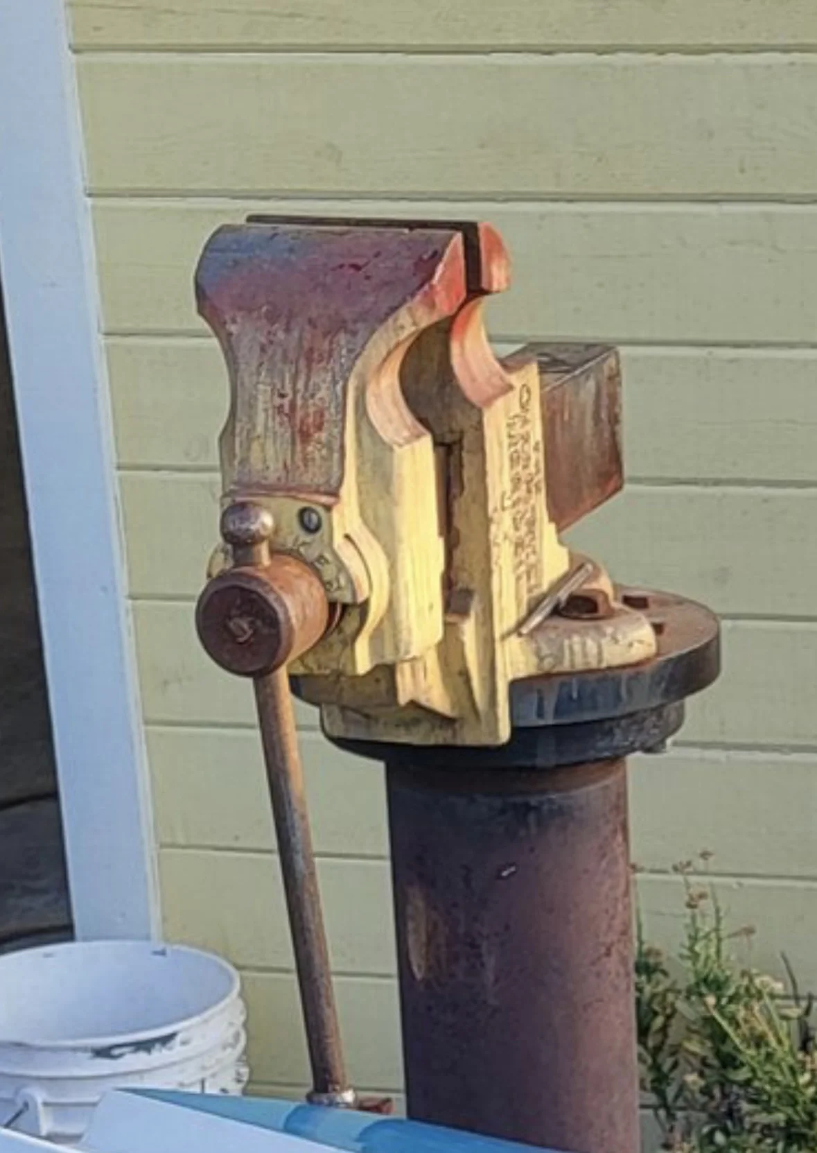

And the star of post #17…
Sweet Parker! 😃👍🏼👍🏼
That vise has taken quite a beating.
It's set there in 4, maybe 5 feet of concrete atop an old well casing.
I've had stuff clamped in it, while standing on my welding table (for the elevation) to swing a 12 lb sledge, at wheel bearings, stuck hubs, or any other stubborn parts.
I've also used it as a press with a cheater bar to press things back together.
Seems to take all the abuse I can dish out.
