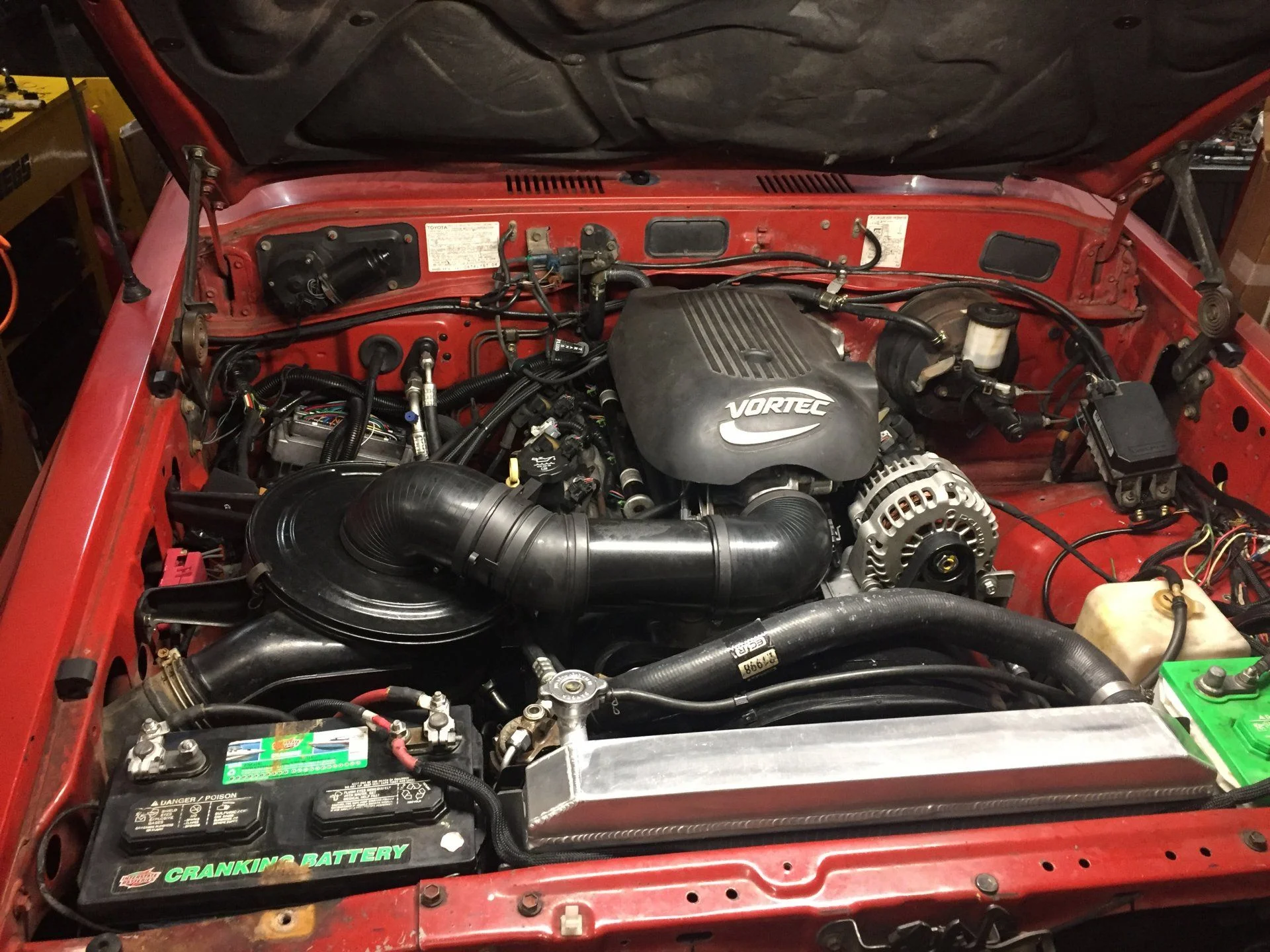

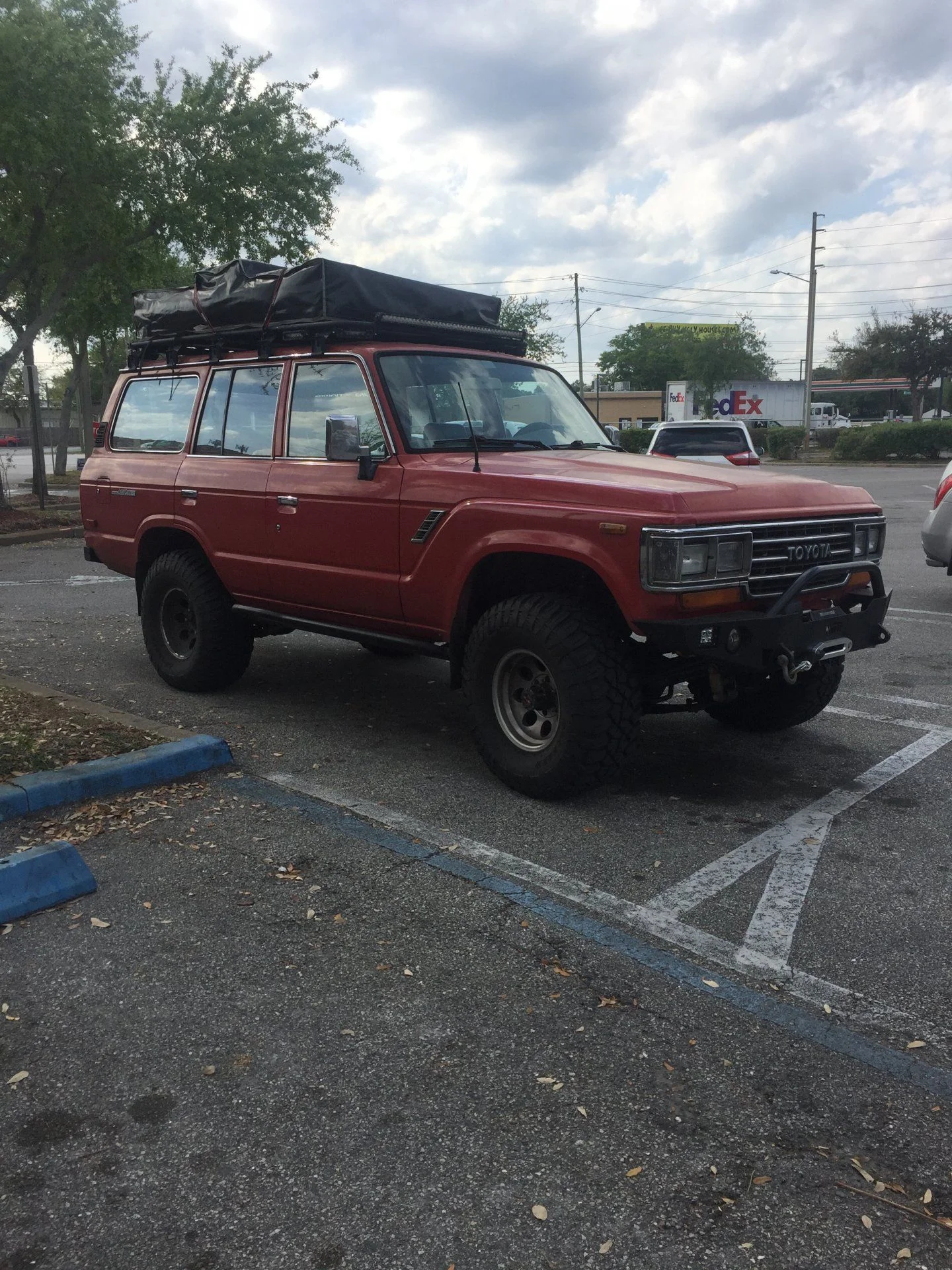

Just finished up this 5.3/4l60 conversion into a FJ62. The engine is a 90k mile L33 (H.O aluminum block). This conversion had about a 8 week turnaround time.

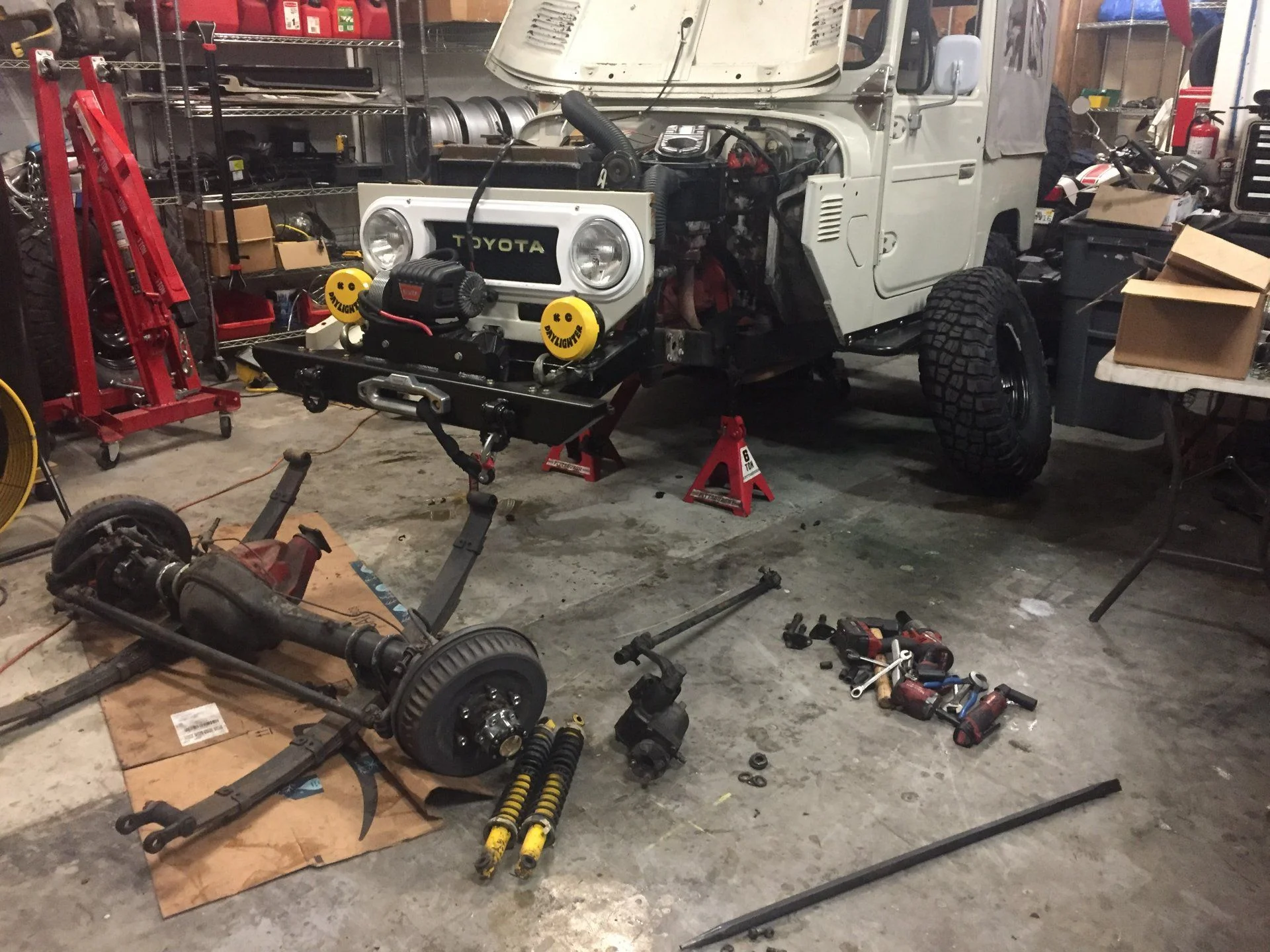

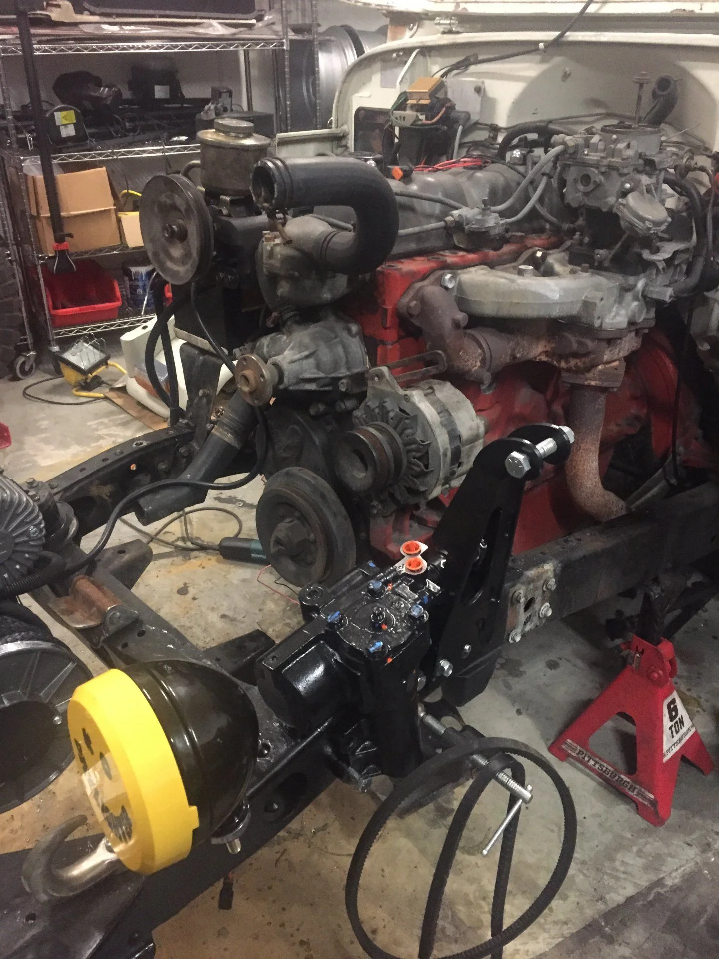

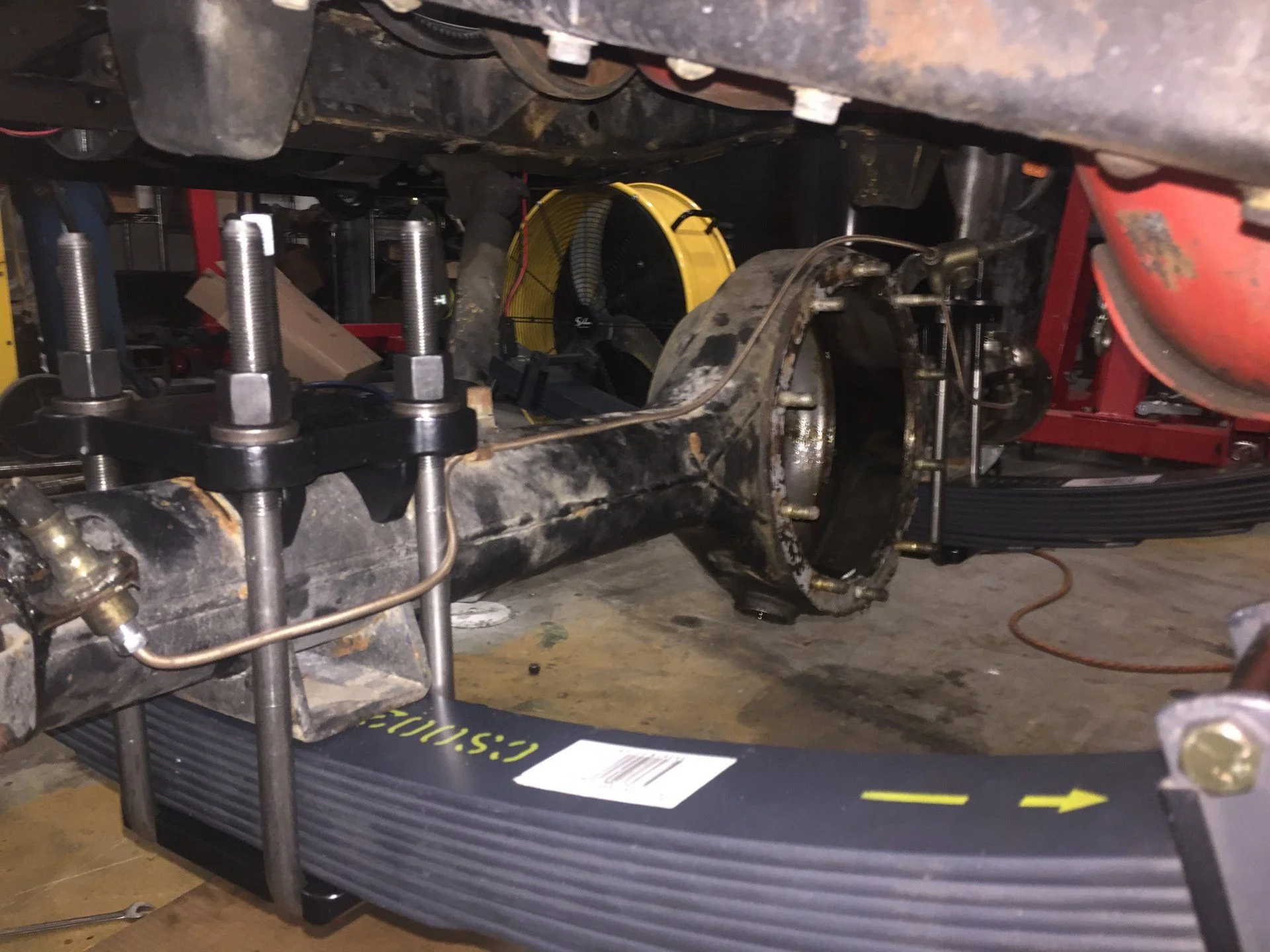

I have also been working on a full FJ40 build-up for @papabeach . It's getting the works. front disc conversion, FJ60 rear axle, FJ60 power steering, new OME springs, Bilstein shocks, the *entire* 4-Plus catalogue, ARB lockers F/R, 4.11's, brand new 8274, a whole host of goodies from Matt@Vintage TEQ parts, new Toyota steelies and hub caps with new KM3's etc
Don't worry, the motors coming out to get rid of the red. :)
Great work. Is that your own truck or a customers?
Thank you John. That was a customers. I did the conversion into my truck with the same engine but with a 5-speed manual transmission (NV4500) in 2018
