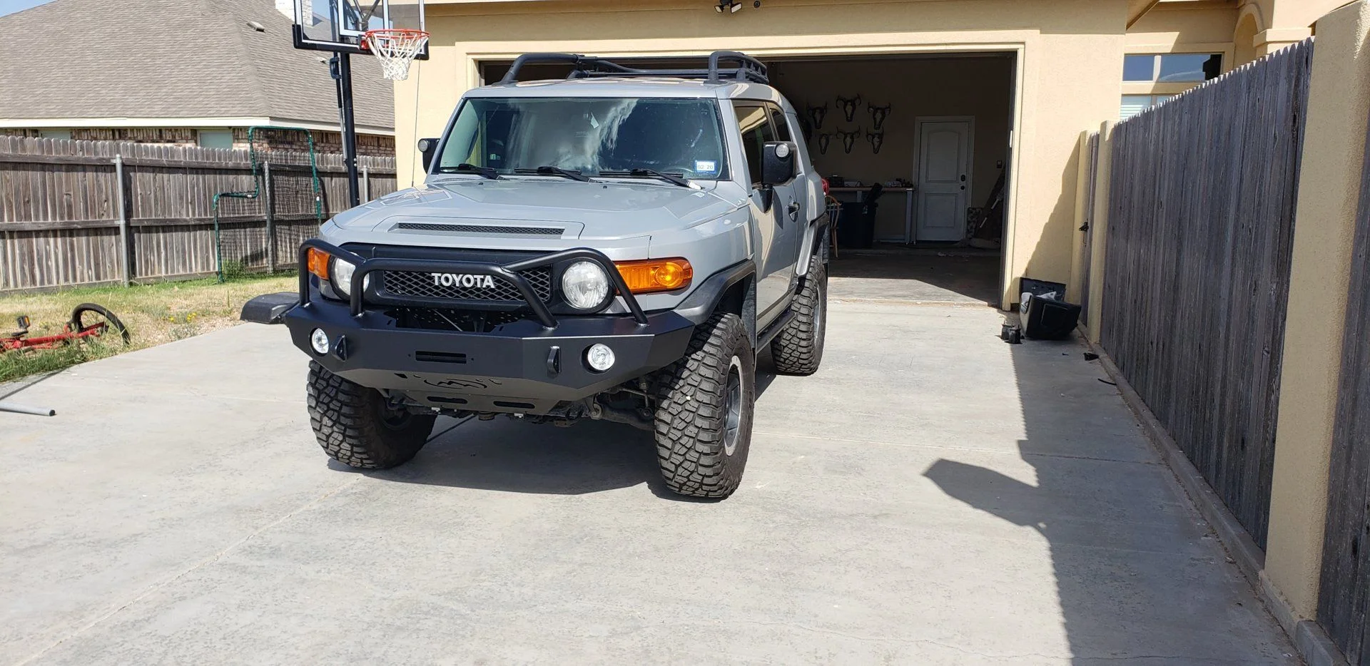

I only purchased a 2013 TTSE for the solid cement color. I agree with everyone else because I have already changed bumpers and lifted it and the only real difference is badging, solid color and suspension. As far as the best year goes I owned an early model 07 when they first came out and absolutely loved it. I never had issues with it and I wheeled it pretty hard being young and dumb. The extra Power in the later models honestly isn't noticeable to me. I think the later models 2010 and up also have a larger ring gear in the rear end. But again I never had issues with my 07 on 35s and I pulled a boat with it all the time too.

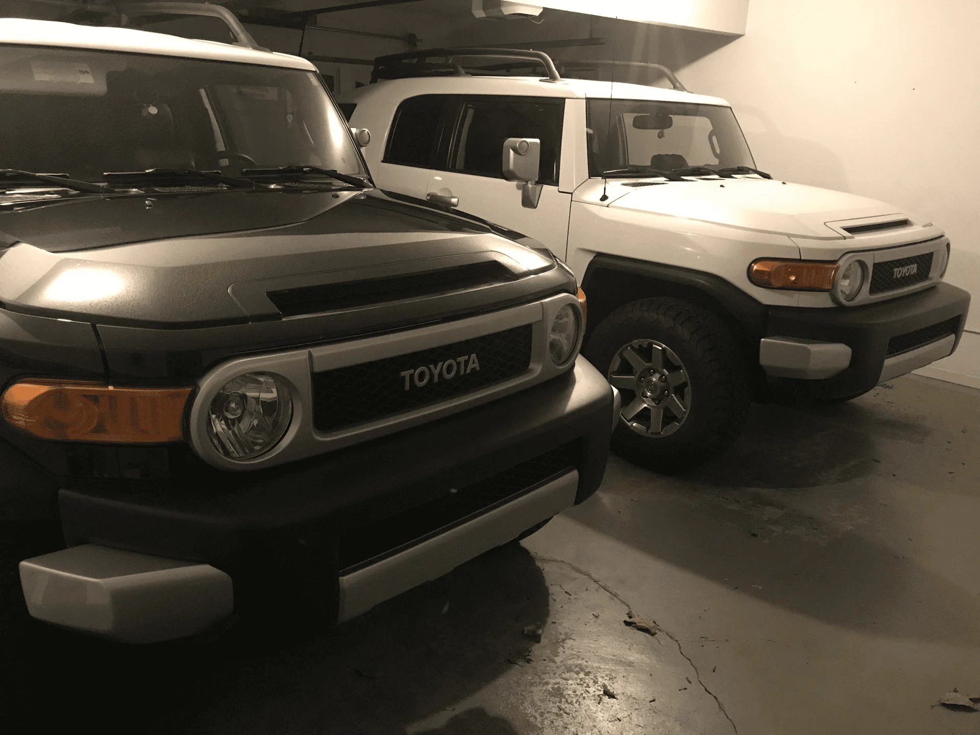

She'll be happy with the FJ.....mine sure is. Heck, I liked it so much, got the wife one.
