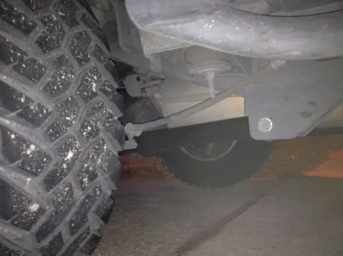

New rear lower links.
brad, you got the the toy outfitters? how much was the uppers and lowers?
