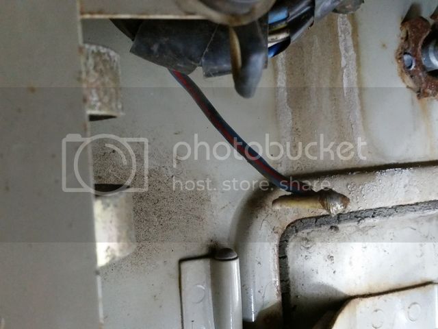

What wire is this? Its behind the fuse box and goes directly into the harness i have no idea where it should be going. Its blue with a red stripe.
If everything on your rig is working I'd check the BR wire for power, if it's powered cut soldered end cap and tape. You shouldn't have open wires dangling around.
It all works. Lol. That's why it was odd to find. Only thing I'm having issues with is pass turn signals

If you unbolt the fuse block and see which position it mounts to it will be easier to track down what it is supposed to go to. The cover will tell you the device.
It was just hanging there taped on the end so not sure how important it is or was
