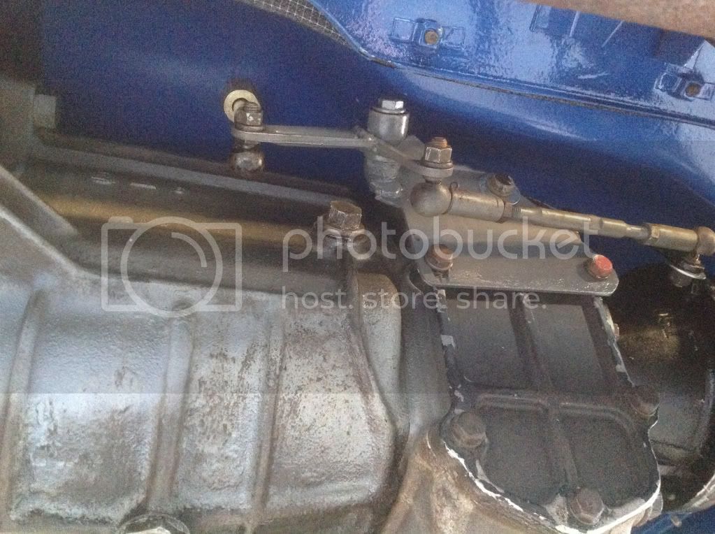

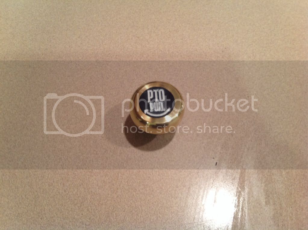

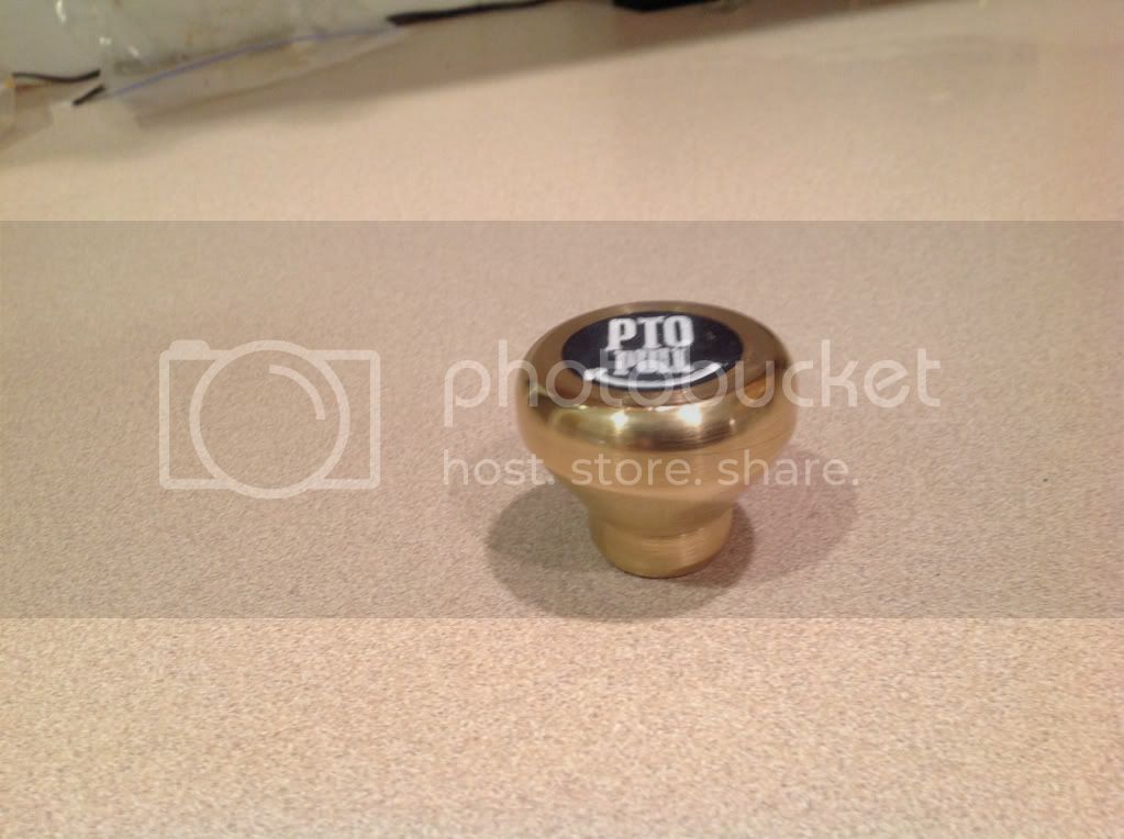

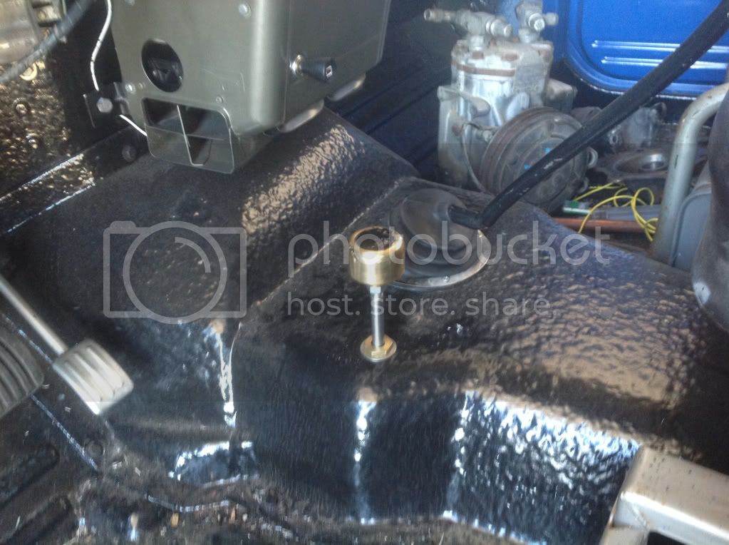

I finished the first part of the installation, the pto gear box. I rebuilt the box with new bearings and seals. I then made a spacer for the transmission output shaft. Put it all together and the box was very stiff going into gear. After taking it on and off a few times I found some small burrs on the gear that didn't look like much but after removing them it shifts fine. Then made a shifting lever, kind of combined the cable and shift lever idea into a push pull knob with linkages. This morning I made a the knob and plan on engraving PTO pull on the black epoxy that is inlet in the brass. Just waiting on the epoxy to cure before I finish it.
Here are some pictures.
I also purchased a York ac compressor from the junk yard. that will be one of the things it drives. You can see it on the floor board behind the gear shifter.
