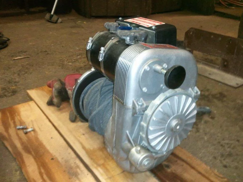

I have had this bad boy on my first cruiser back in 88 , then on my 90 cummins ram and took it off and put it away since 98

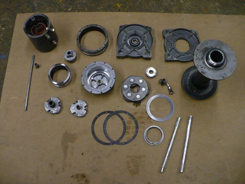

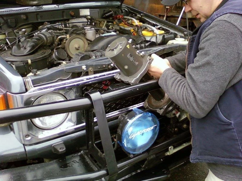

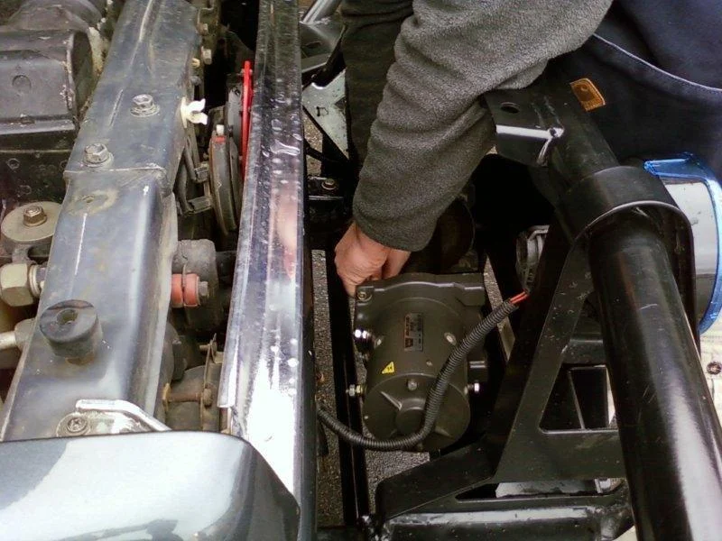

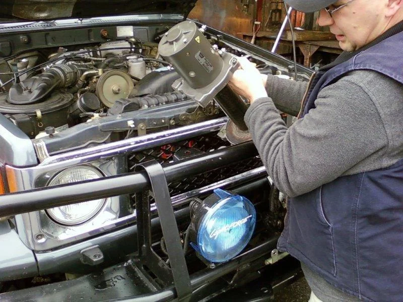

I do like my low pro 24V 8000 it has around 450hrs on it . I do a refit/lube every 6 months
Clearly, you're not married and have lots of time to enjoy your toys! :)
Nice to see someone actually servicing their toys and making sure they work when you need them.
