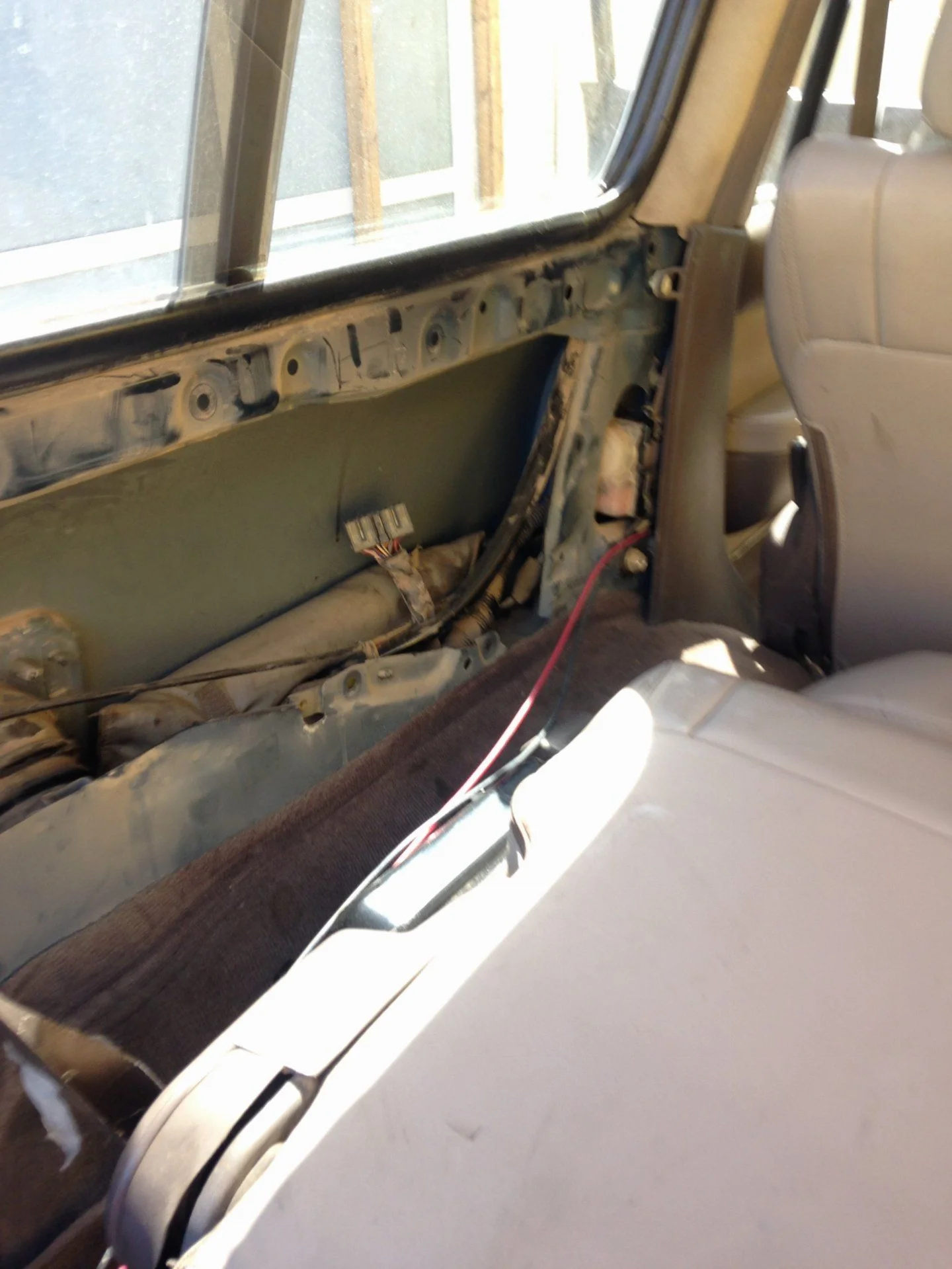

Any ideas of the purpose of this connector?
If it is on the left hand side I would think it has something to do with the subtank..if it is on the right hand side (don't think so) then the secondary AC and or subwoofer...my guess...
My LX450 had some kind of connectors back there which were for the "mobile phone system" antenna that was back in that pocket and on the side window. Maybe that's what it's for?
Check for power at each of the wires to see if they could be used for triggering something later on.

Thanks @CrikeMyke , Do you know if there are some type of schematics of all the connectors in te vehicle? Indicating its electrical circuits?
Agree with what @panamacruiser said. I am 99% certain that is for the ECU for the OEM Subtank
All used wiring and connectors on US 80s can be found in the EWD, but you won't find this subtank connector in the US EWD

i don't know if the subtank signaling is all it does but there is another ECU that is mounted there when the subtank is installed.
When I investigated it two years ago all of the wire colors were present on the "Mobile Telephone" EWD page
