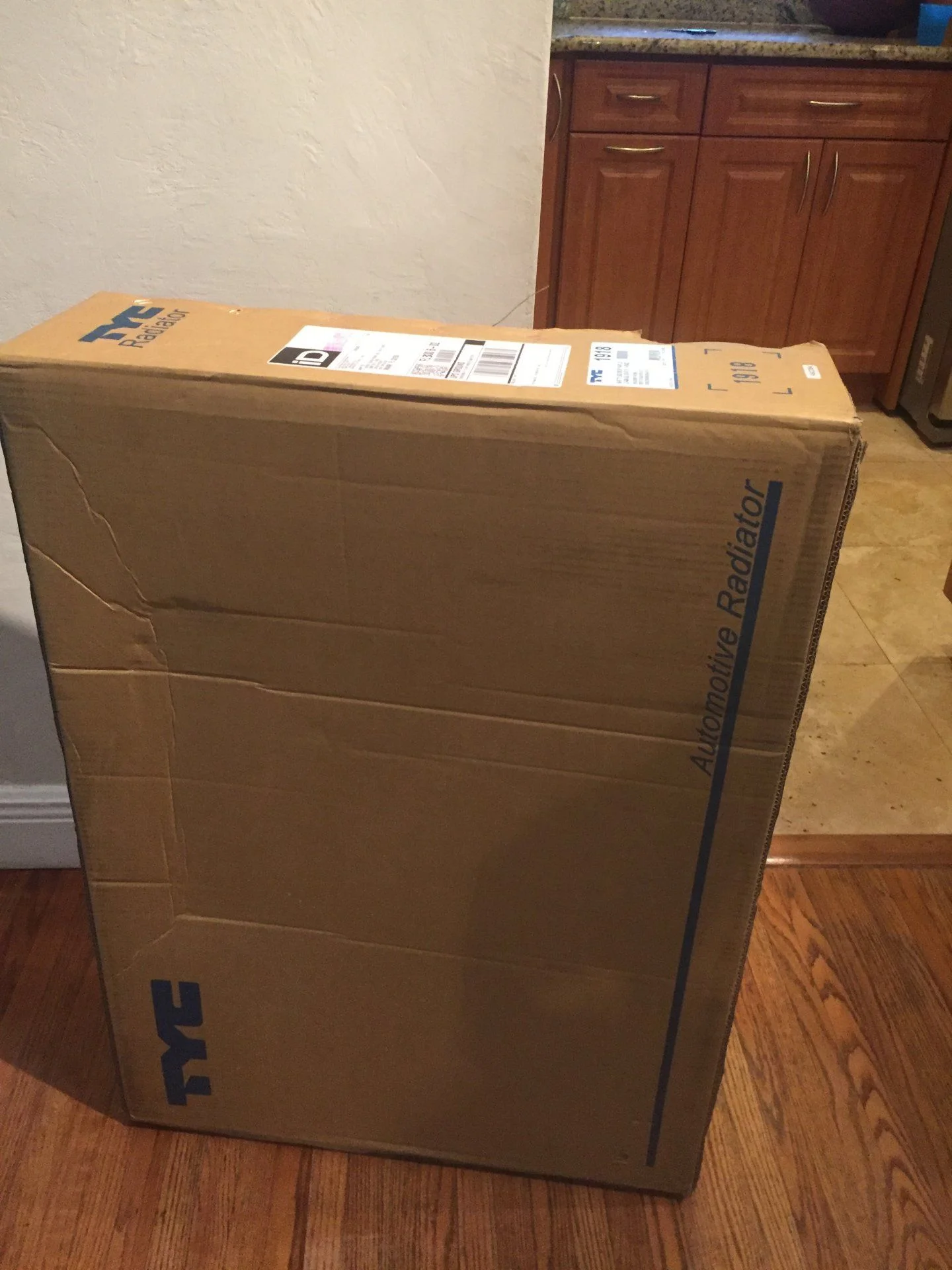

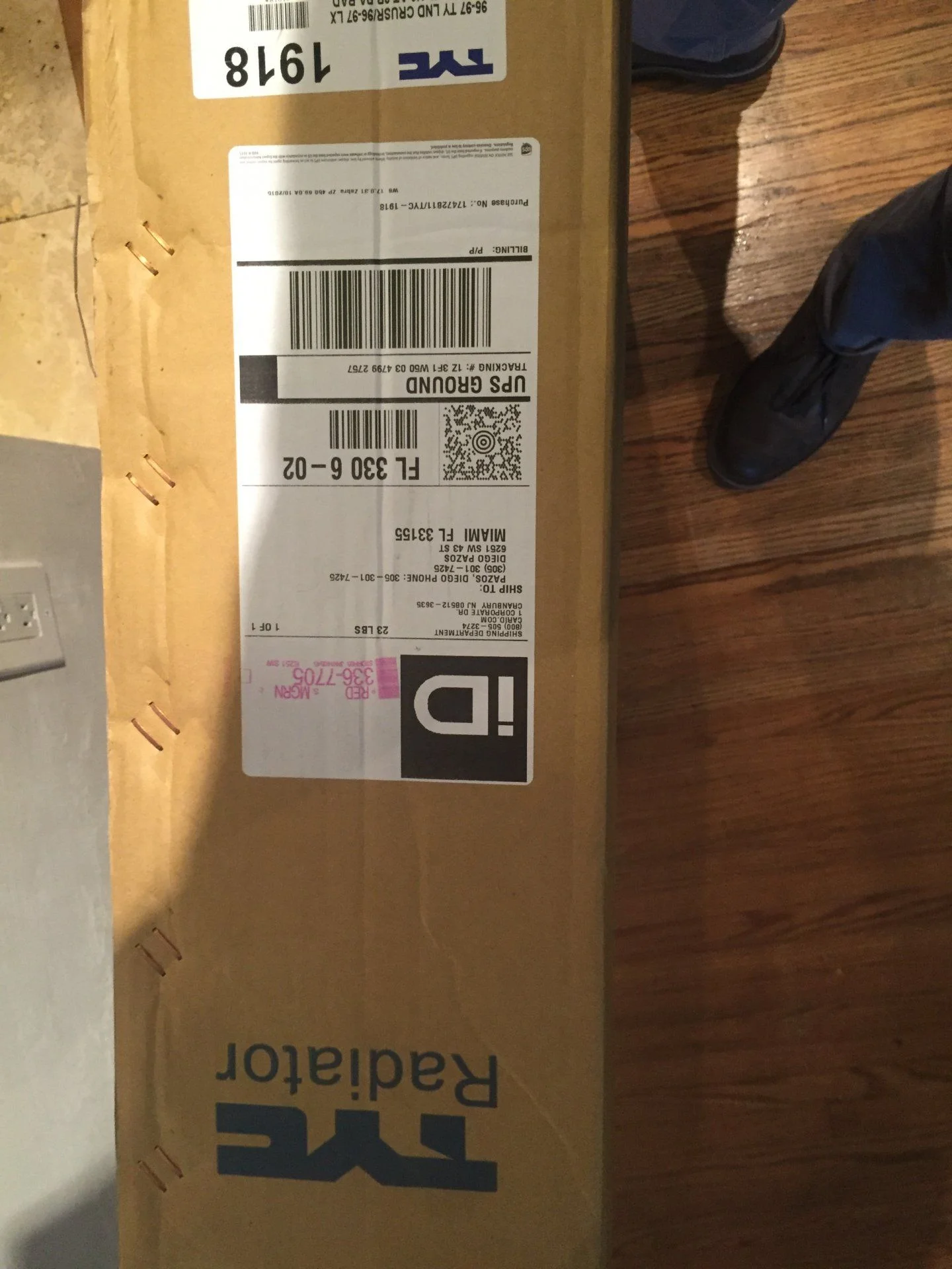

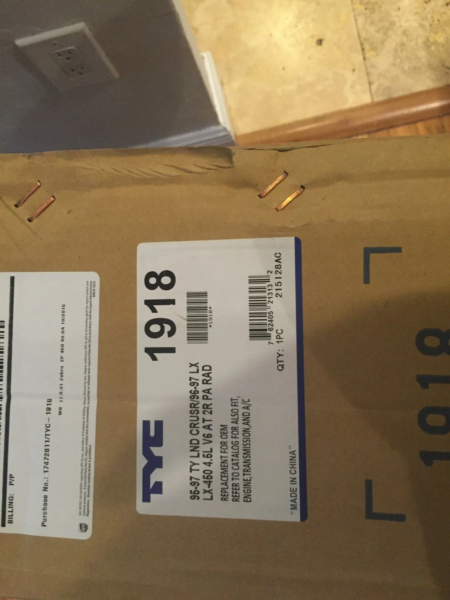

I just ordered a KOYO 1918 from CARID and Received a TYC 1918 in a TYC box and label. I called and they said their distributor was out of the Koyo so they sent a TYC. I requested they take it back and they want to charge me for both of the shipping. I guess I will be calling AMEX! Really disappointed. Avoid CARID!!!
This is bull****, pure and simple.
A TYC does NOT = Koyo.
CarID is located in New Jersey, which has some good consumer fraud protection, to include payment of attorney's fees by the company committing fraud.
There are a ton of shark like lawyers who would gleefully rack up 10s of thousands of dollars pursuing a couple hundred dollar claim.
http://www.njconsumeraffairs.gov/Statutes/Consumer-Fraud-Act.pdf
Im not worried. AMEX will get me a full refund. They are great unlike CARID. They would have issued a full refund and I would have been fine. but trying to get me with shipping charges for their or their distribution center mistake is total bull****.

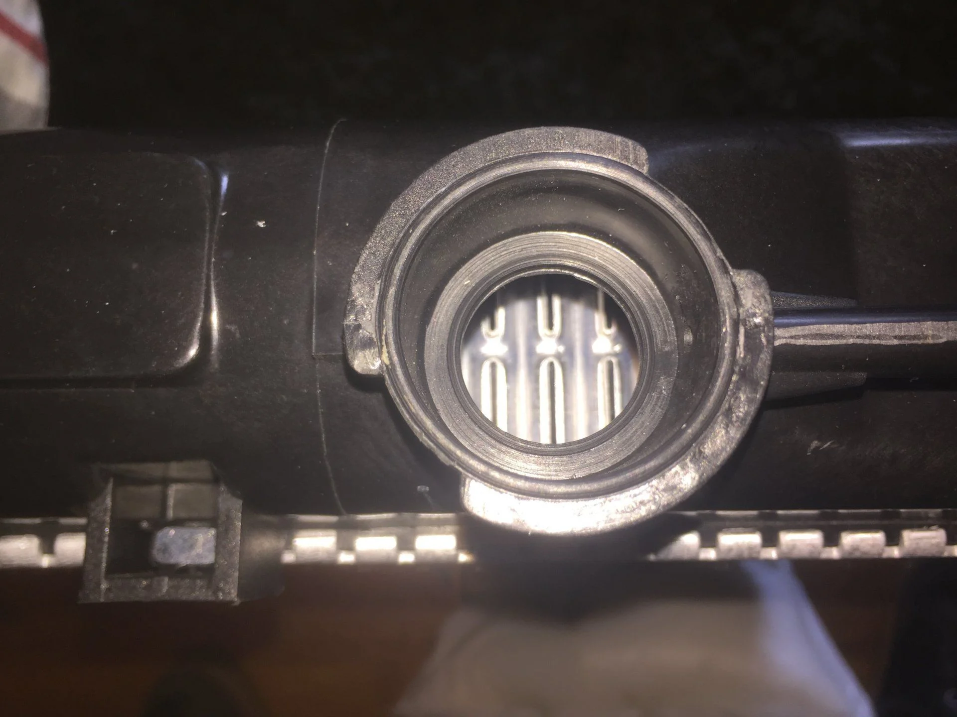

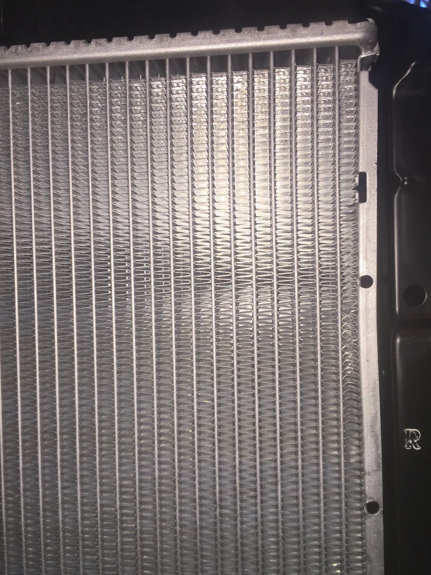

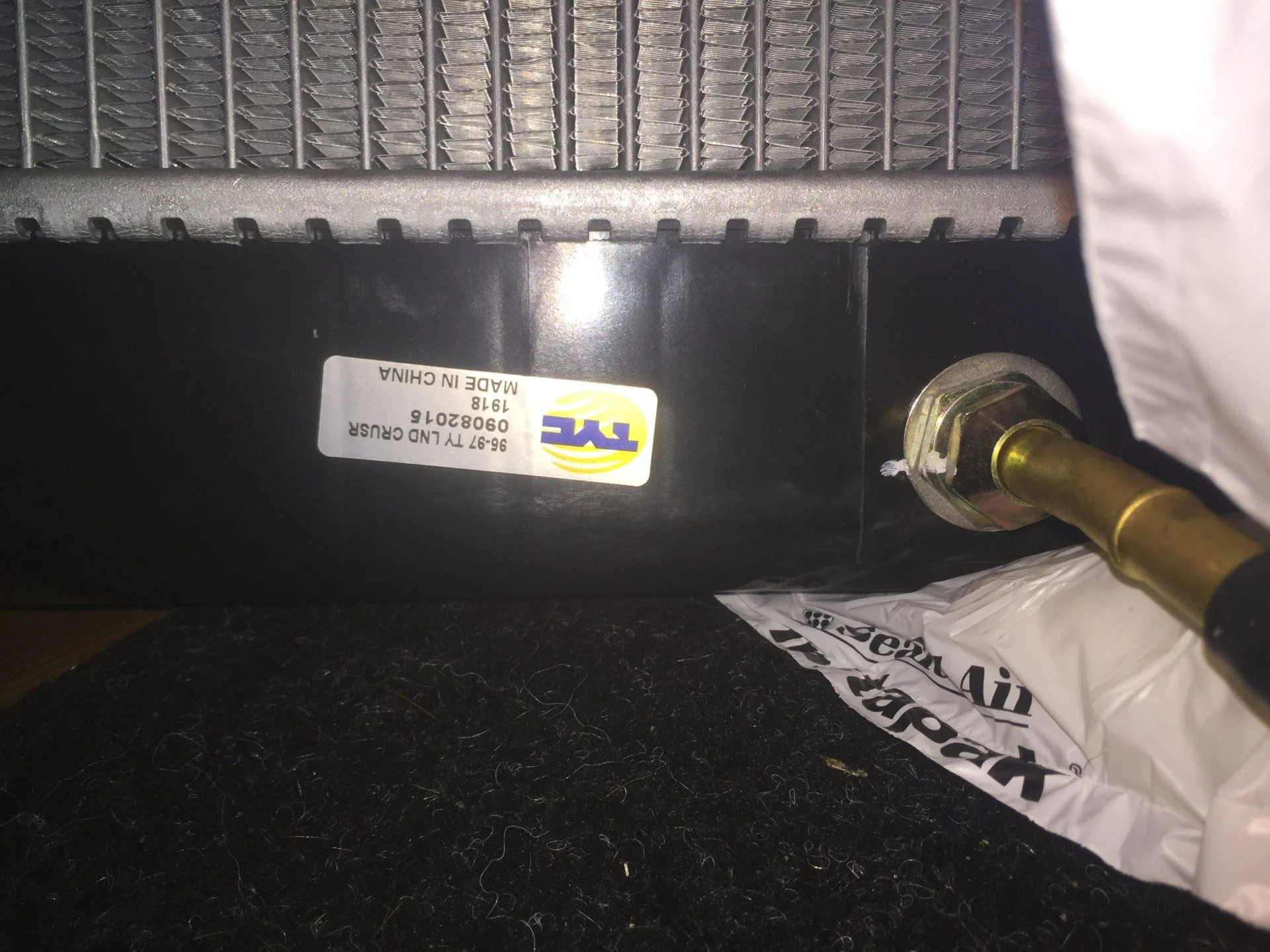

SO I ordered the TYC via amazon today and received a Koyo. I still have the TYC so I thought I would compare. They look very similar at first glance but I noticed the openings of the interior rows of the core on the KOYO and TYC differ. Also, the sides of the Koyo core are much more substantial. One side of the TYC actually seems to have bent. Also the transmission line connections on the Koyo are full brass. The TYC has a combination of Brass and a different metal in the rest of the hardware. The top and bottom tanks seem to be made of different plastic composition. The TYC has much more of a shame while the Koyo is more mat in finish.
The crimping of the cores and tanks seems about equal.
