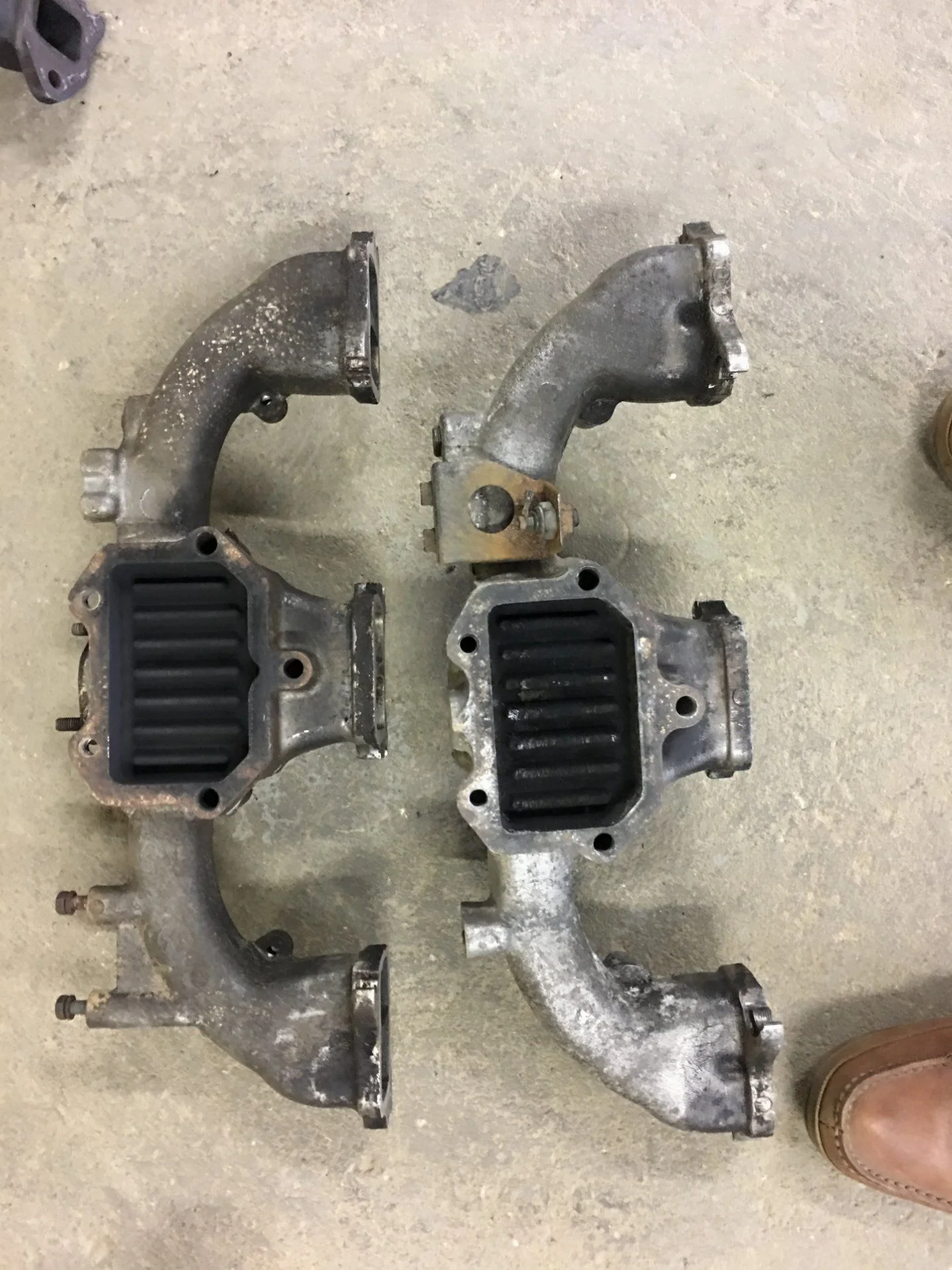

So i bought what i thought was a 2f FJ60 manifold. Its darn close but putting side by side and trying to use my block off plate they are clearly different. Any Idea what the Left on is from? International FJ60?

Part number is 61010 vs 61021

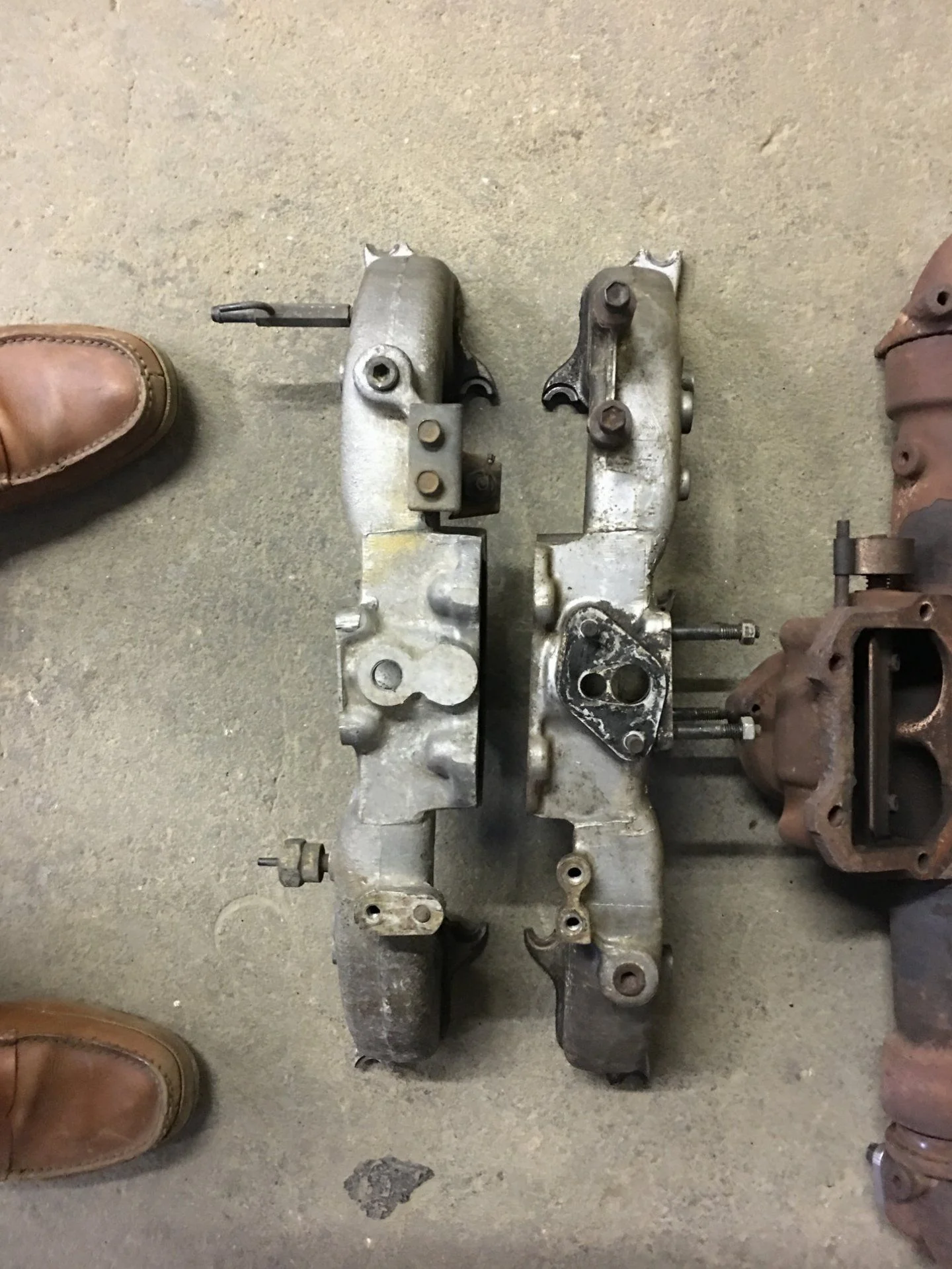

What's difference really will the 61010 work all I can see is bolts go bottom up vs top down and there isn't an extra hole were the EGR tube comes in.
Honestly only thing i can see is where the EGR pipe goes in there is a threaded hole vs non threaded for pipe. Everything else looks to line up identical. The bolts holding the intake manifold to exhaust come bottom up instead of top down.

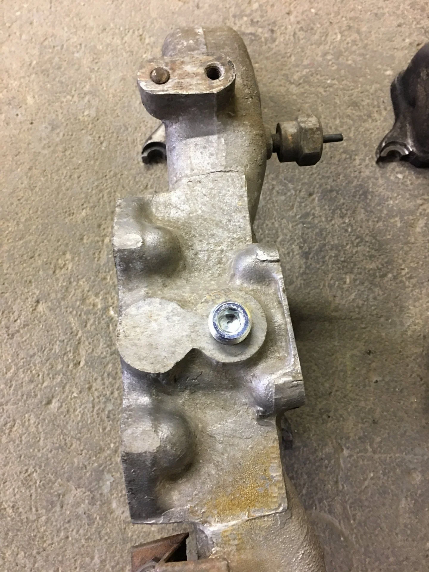

I have an extra bvsv plug from my kit that fits perfectly in the hole threaded. maybe cap that with the plug and some teflon tape or jb weld vs the egr plate.

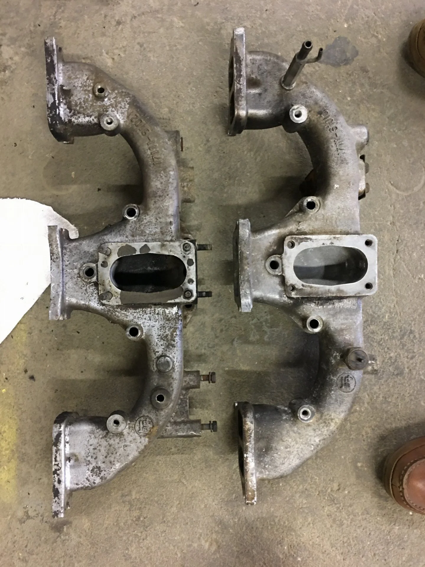

here are some more shots comparison.
Good to see this. I was hoping you hadn't blown money on something you can't use.
Looks like it will work? Have you asked @beno or @orangefj45 or even @cruiseroutfit? Seems like those guys could say yay or nay w/ one quick look.
Those bolts that go up instead of down? Seems like a huge difference?
