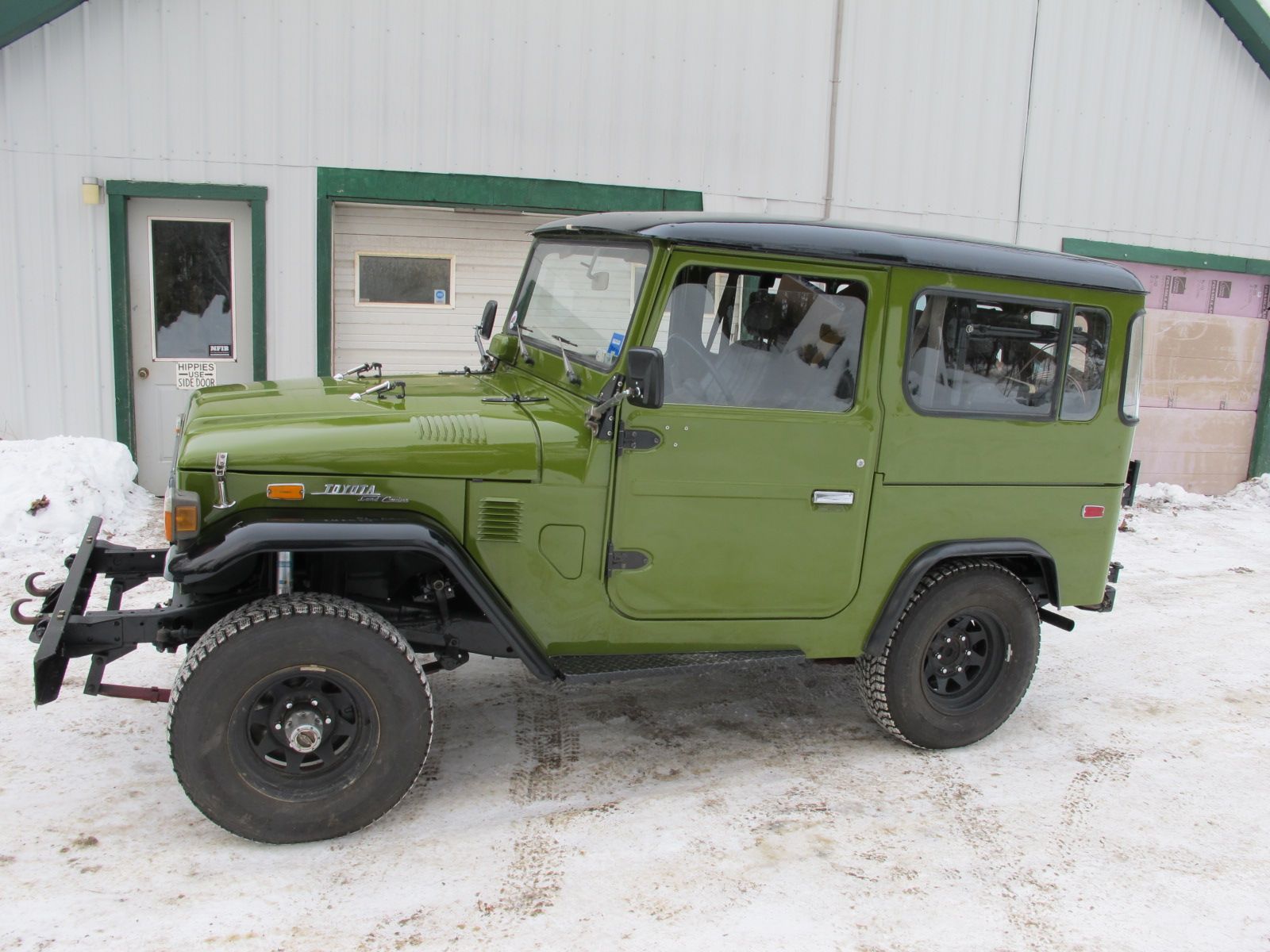

First day out of the shop and on the way home. After a test drive found that Aqualu's provided transfer shifting lever cover knocks it into neutral, had to cut the transmission cover to provide more room for the linkage and manufacture a different cover. Timed it at 7DBTDC @650 rpm, felt like it was dialed in with the new Trollhole Carburetor. Five miles into the Seven for home started up an incline, top end of third and it loses all power and had to pump accelerator to keep the motor running, down shifted and kept it going. Got home and it wouldn't idle without the choke on, spitting and coughing. -5 degrees below zero, now adjustments will have to be made outdoors, no warm shop now. Could be fuel delivery, could be vacuum leak, trying to find diagrams of Trollhole carburetor with no luck so far, something to clear up questions for this non savvy carb guy "What does this adjusting screw do?" Sure feels nice driving a cruiser again!!
