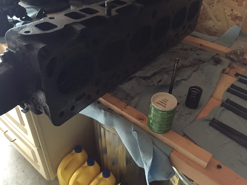

Monday night:
Lapped valves and installed new valve seals. The old valves seals were completely shot, happy to do new ones. New ones are SOR seals, we'll see how well they hold up.

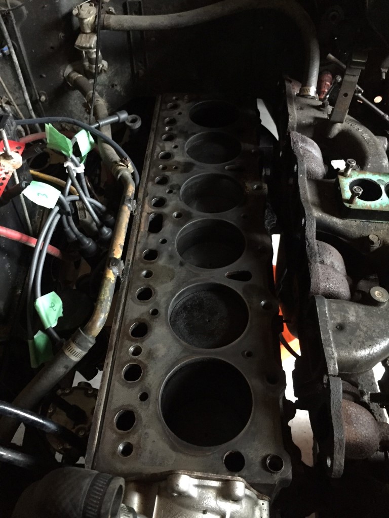

Tuesday night:
Got the head back on and torqued (happy to see an OEM toyota gasket on that block!). Since the train was off, removed all rockers/springs etc from rod to inspect and clean. Lots of scoring, a project for another time as we need this truck for work around the yard before winter hits. Cleaned up as best possible, re-assembled and installed rocker train. Got other bits and pieces back on the (carb, hoses, alternator etc). Changed oil and filter. Filled with coolant (have to get more, low about 2-3 liters). Got a parts washer too! Not sure how we lived without one LOL
Tonight my wife works late so I'm solo with the kids, not sure if I'll get a chance to finish and crank it over for it's first heat cycle.....hopefully soon! Need to get a new battery too, old one barely turns on the head lights......
