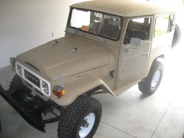

Hi All:
Oh, this weekend I installed the new long-travel shocks in the rear, bolted-up the lengthened front drive shaft, re-installed the skid plate, and patched a hole in the "wind jammer" (rear curtain.)
Need to re-locate the front turn signals and trim the front fenders to clear the front tires (moved the axle forward about three inches.)

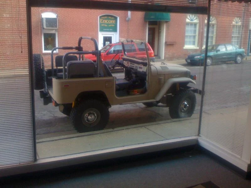

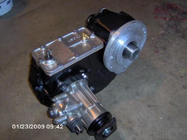

Put the OEM steelies back on. With 33x10.5 KM2's.
Installed the new drive-train for the second time to check to see if the mocked-up body lift would give me sufficient clearance for the drive train. 1" on the nose and the height is perfect, whew!
As long as it was all mocked-up in there I finished up the x-member, and clearanced it for the front d-shaft.
Feels like this project is finally starting to come together :bounce:

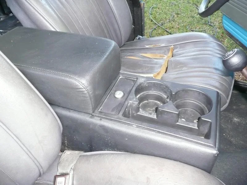

I made a small master switches control panel,using the best top console,still have to order push on/off small switches for the roof rack lights.
