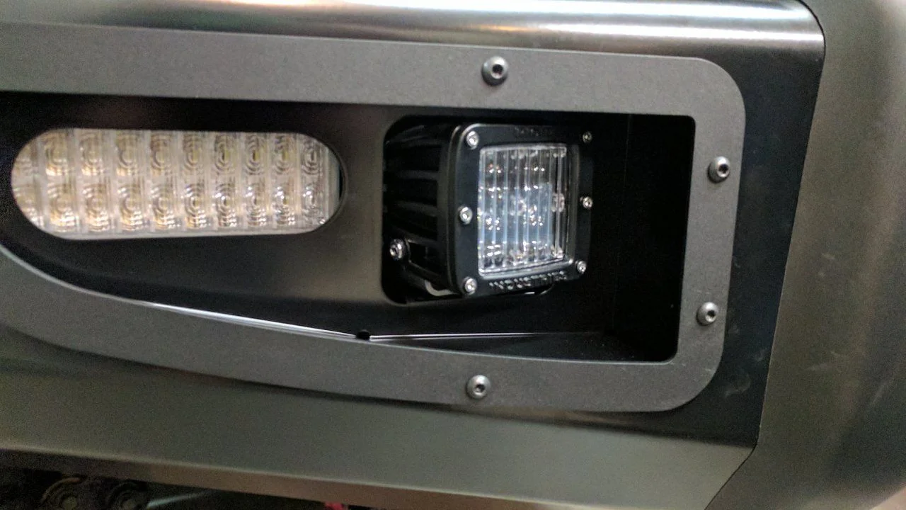

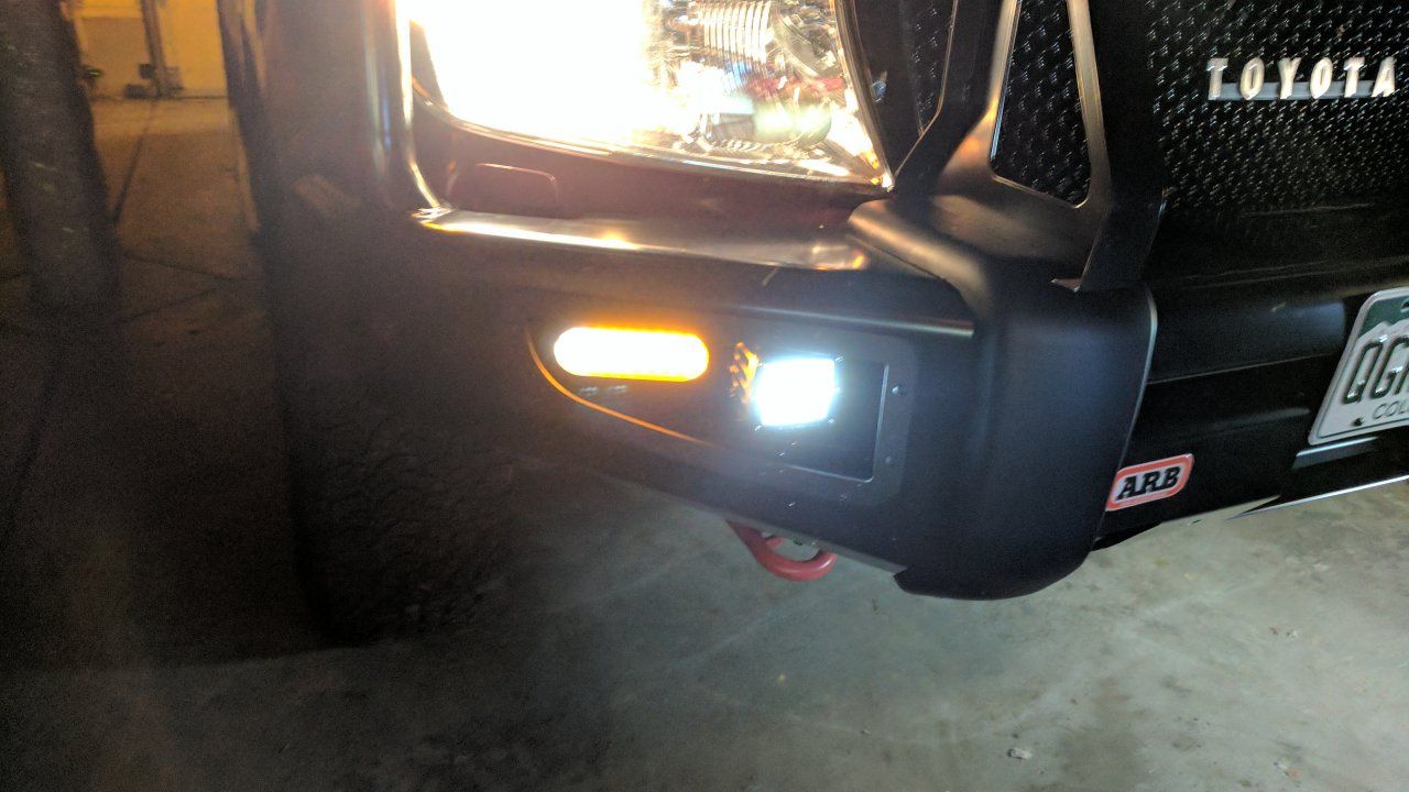

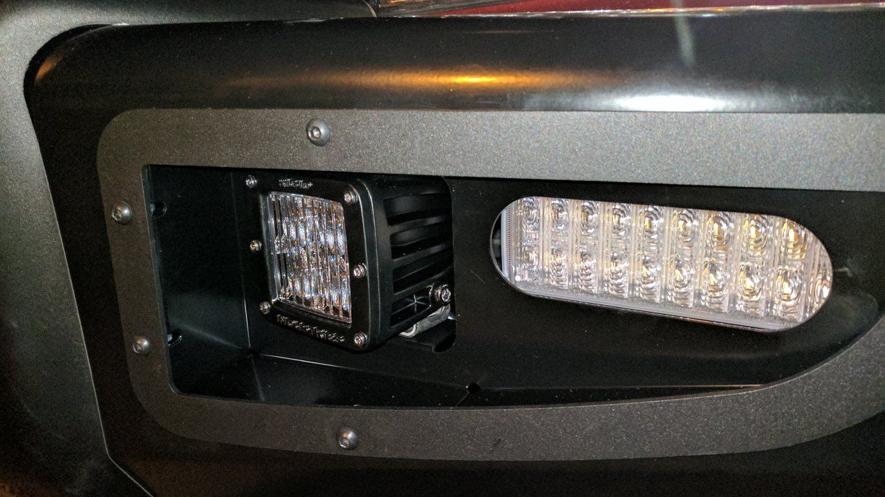

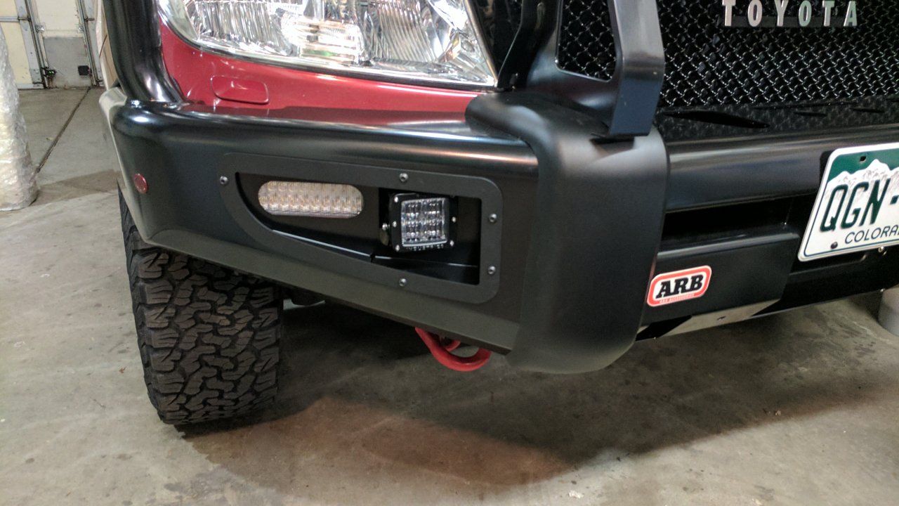

Introducing @sleeoffroad 's Fog Light adapter for ARB bumpers!
This adapter replaces ARB's available fog lights with the much-improved Rigid 50481 SAE compliant D2 flood light. What does that mean exactly? A whole lotta light and 'street legal' for highway driving (most duallys or D2s are technically not street legal).
And when I say a 'whole lotta light' I really mean it - the pics don't do this justice. The beam pattern is level and won't blind oncoming traffic, and it reaches both ditches with nearly 180 degree field of view - the side-to-side span of illumination is incredible. This improvement over OEM cannot be described here - you have to see it to really appreciate it.
Special thanks to Amory and team at Slee for getting the ARB Deluxe Bar installed yesterday with this fog light upgrade! Give him a call if interested in the fog light adapter - as you can expect, every detail is well thought out and the quality is top-notch. Hardware is sturdy and the fogs are adjustable both up/down as well as side/side to match your setup as needed.
Once the weather cooperates (5" 8" snow and sub-zero temps today!) I'll mess around with other adjustments and will look into Rigid's amber lens covers. Hit me up if you want more info or other pics. Or, just call up Amory at Slee and get yourself a set.

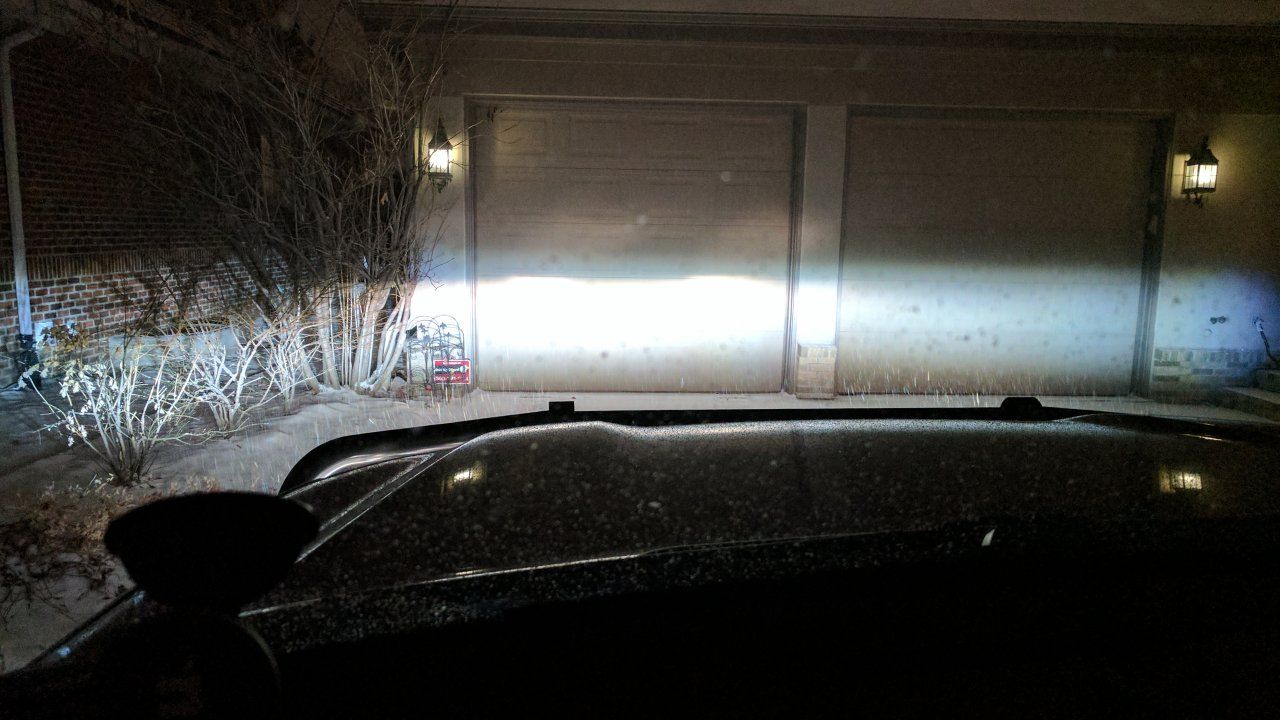

This is without the fogs on:
This is with the fogs (note how much more light is thrown to the side, the camera doesn't even capture the edge of the light):
