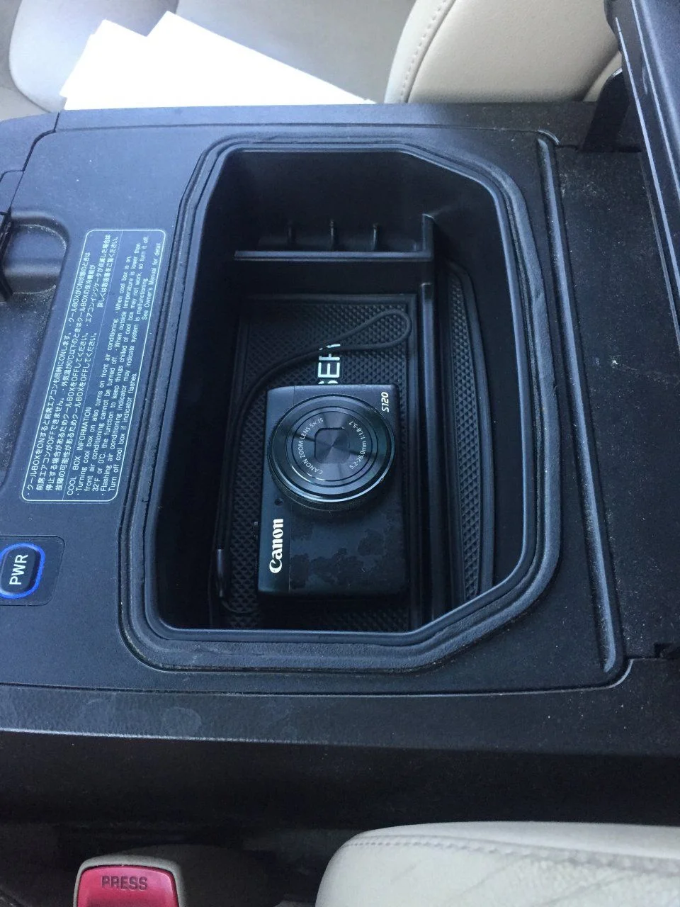

Best low dollar mod I've done thus far.......... thanks for the heads up.

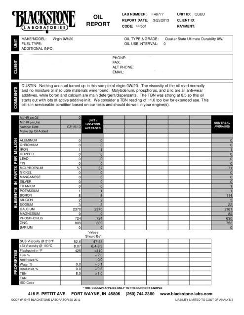

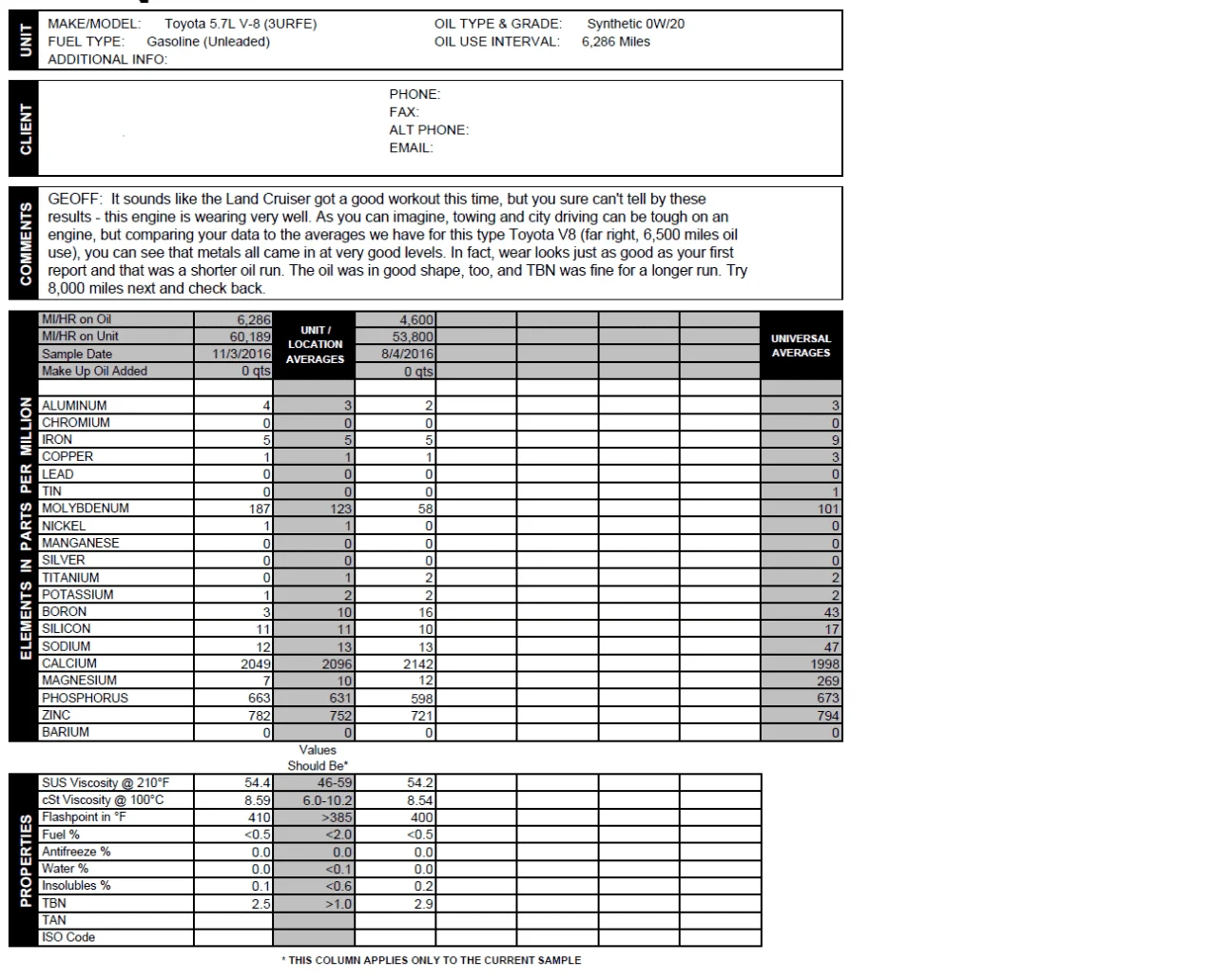

60k oil and fluid change. Diffs, Trans, and Xfer case all went to Amsoil. Engine gets Quaker State 0w20 full synthetic now (I believe the last sample was probably Toyota motor oil as it was changed when I bought the vehicle from the dealer). I wasn't going to send another sample to Blackstone but since more than half my mileage was towing (3500/6200) and another 1/3 was heavy city I wanted to see how well it had held up. I can see why Toyota says it's OK to go 10k between oil changes for normal suburban/highway driving.
Now that I have a good baseline I probably won't test again unless I notice a change in oil consumption or another sign that concerns me. It's interesting but I can't continually justify $38 per test (including the TBN).
bobistheoilguy.com has a VOA for supposedly the same oil as well.

Thanks for posting. Good info - I assume this 60k change service for the diffs, trans, and transfer cases were the first time the fluid were changed out, right?
How much did the dealer/shop charge for these changes?
I assume this was the first full fluid swap as well, based on the CarFax and Toyota Owners history. I purchased the vehicle @ 49k miles.
The fluid cost about $300, including a full 16 quarts of A/T fluid since I wanted to do a full fluid flush. IIRC all the crush washers cost a total of about $6 plus shipping. I do have some fluid left but I thought that would happen and I didn't want to run short.
My mechanic charged me $400 for the oil and filter change, tire rotation, transfer case flush, and differentials changes. He also dropped the truck off at the local Toyota dealer, who charged $125 for the full transmission flush since my mechanic didn't have the right equipment to do it.
As much as I like my mechanic, in hindsight I would probably just take it to the dealer to do the full fluid change in the future so it would be done in one trip. (He's 3 blocks away from me; the dealer is a 25-30 minute drive).

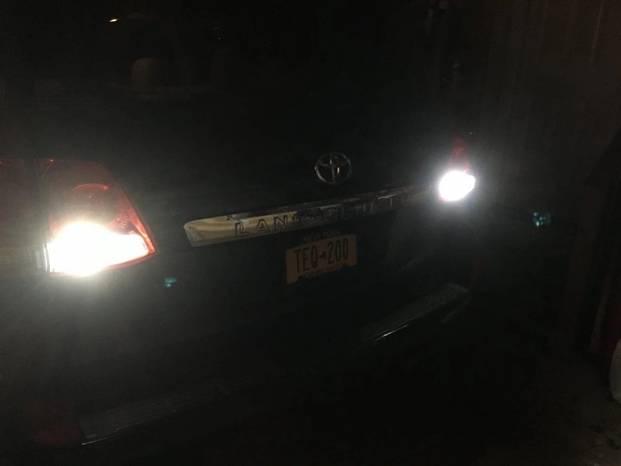

Crazy bright for little back up bulbs!

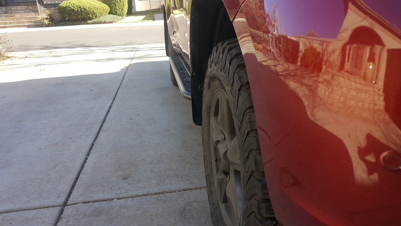

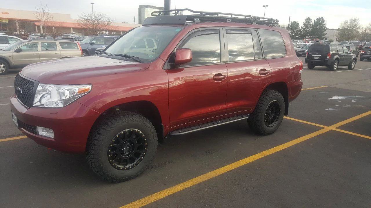

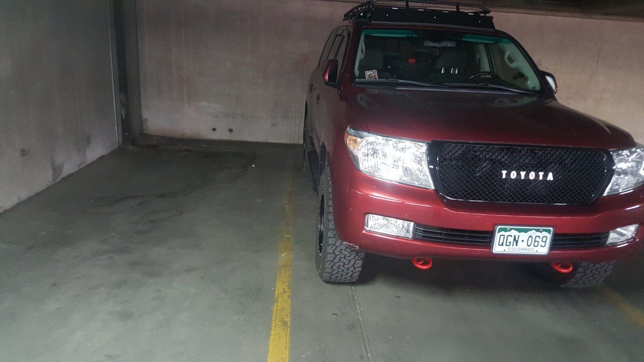

Picked up some Method NV's on Black Friday - 18x9 w/ 25mm offset.
Before, you can see how the OEM wheels line up about 1" or so inward. After, wheels are more flush.
There's a little rubbing on full lock, but only really noticeable in reverse - this will be resolved on the 16th when Slee mounts a new bumper.
Before:
After:
