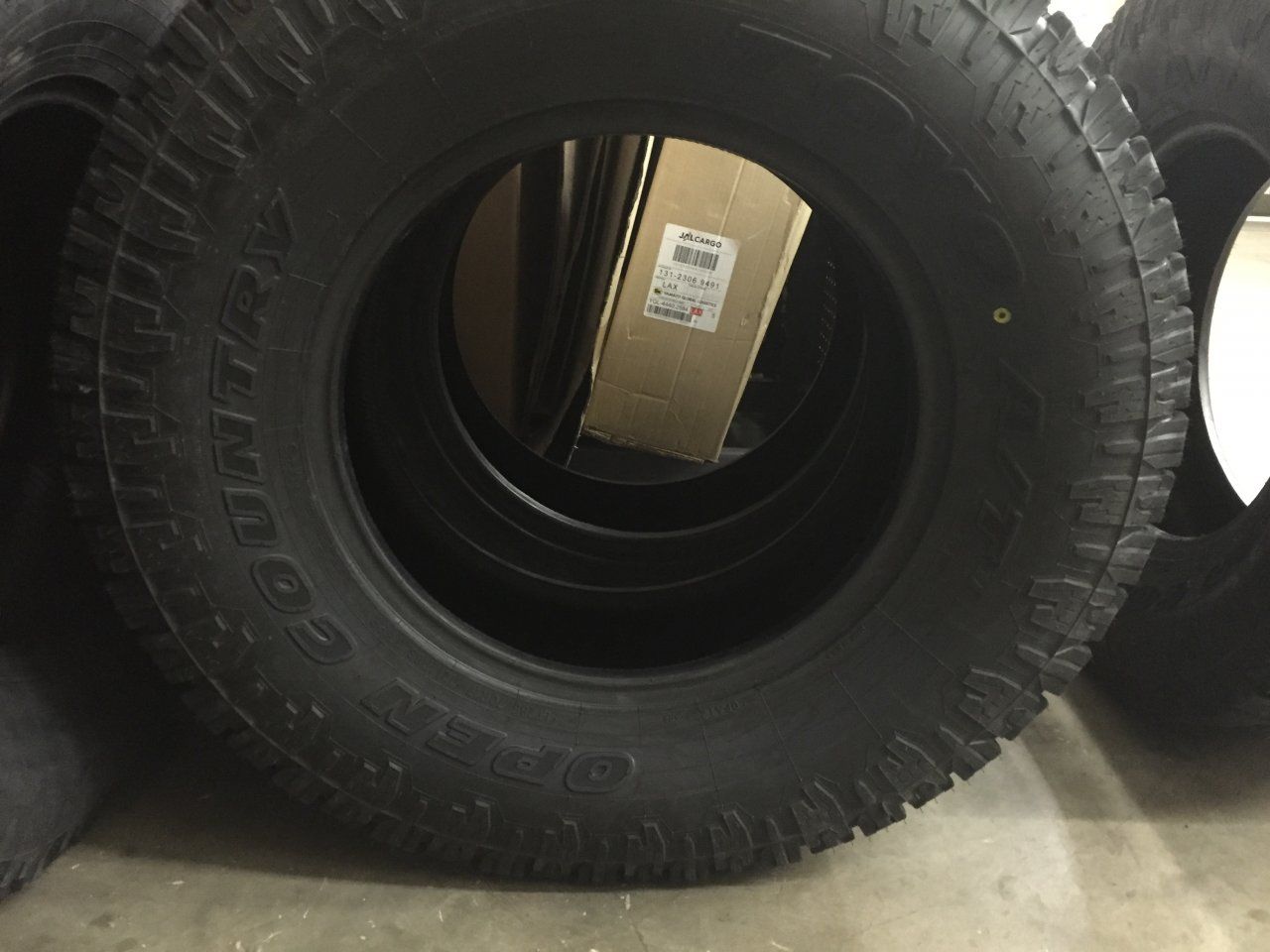

Brand spanky new RW's!! I love it!!
It's so professional looking. Thanks.
