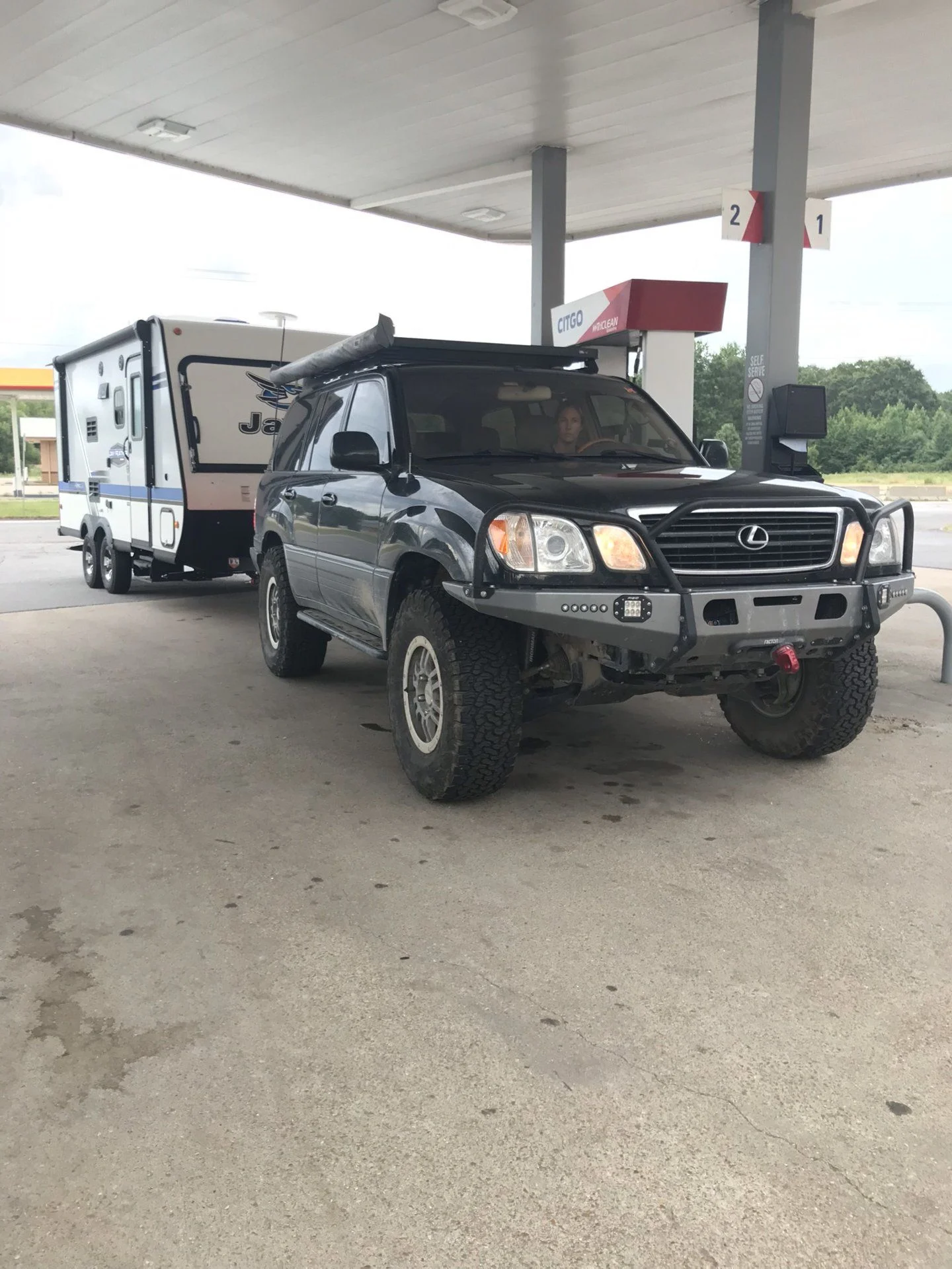

It’s a Jayco Jayfeather 7 17XFD. It’s 3400lb dry and 4500lb fully loaded. We really like it. We towed it from Ga to Silverton, Colorado for HIH8 with my 2000 LX. The Lx is sitting on 35s and geared with 4.88s and it did well.
Before I traded in my 06 TLC on my LX570 we used the 06 to tow most of the time. The 06 was sitting on 33s and did an excellent job towing. My 570 doesn’t even know it’s there.

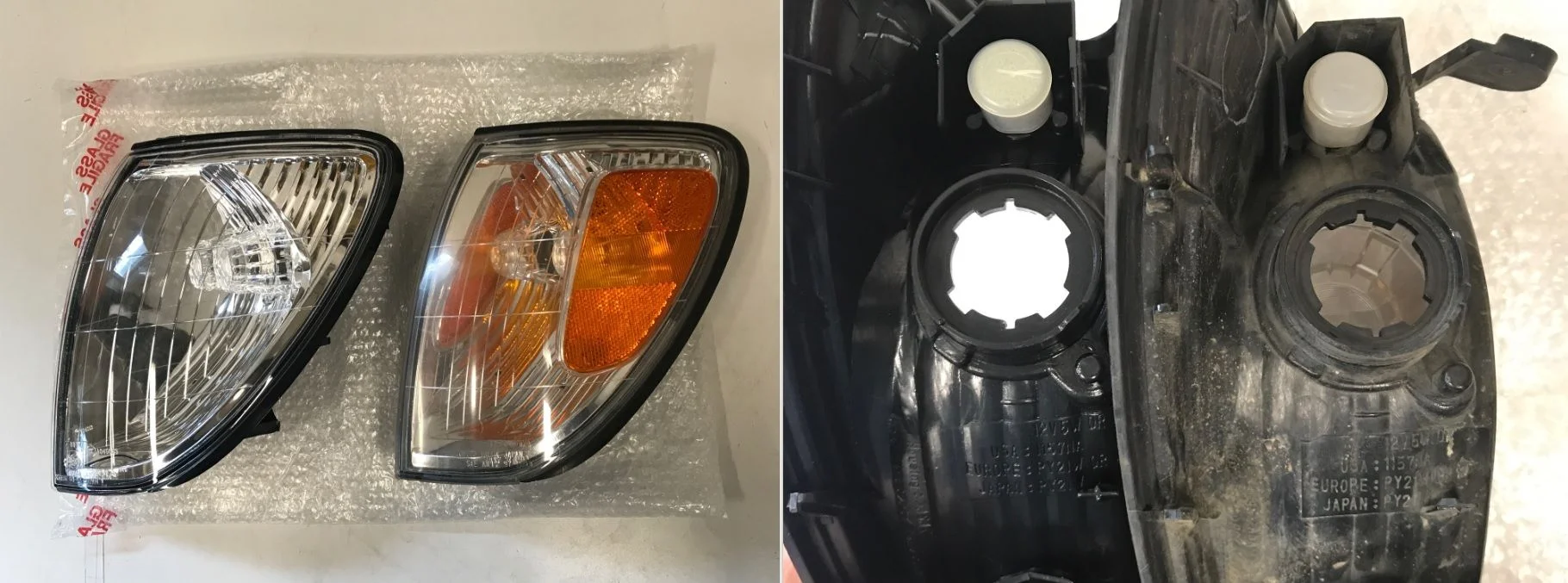

Replaced my front corner lights with OEM clear versions. Pretty much plug-n-play with a couple of small changes.
1904087
The Toyota PNs are:
81511-60490, UNIT ASSY, FRONT TURN SIGNAL LAMP, RH
81521-60360, UNIT ASSY, FRONT TURN SIGNAL LAMP, LH

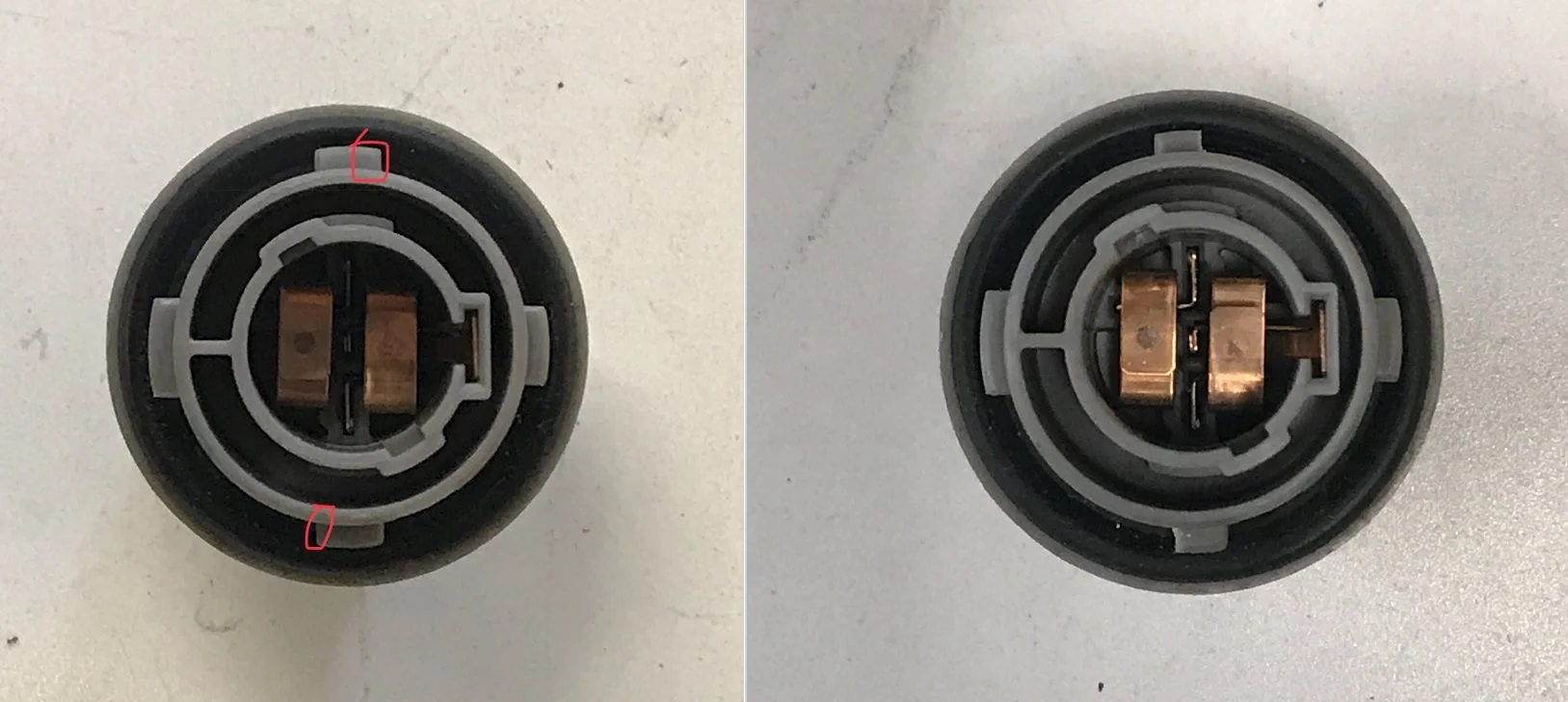

The housings are identical except for two small differences in the socket hole: 1) The bulb socket tabs need to be slightly trimmed in two places, and 2) the socket gasket needs to be slightly thicker to form a good seal.
1904084
Below left: Socket tab trimming shown in red. Below right: After trimming. FYI, I used a pair of nail clippers.

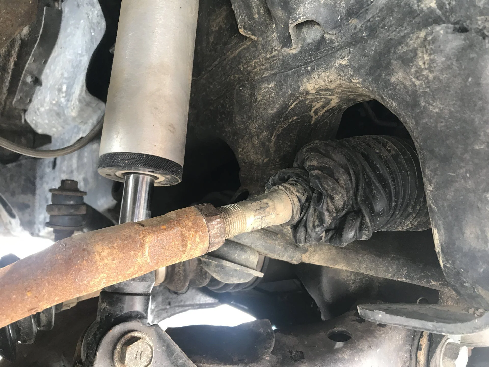

That is a real head scratcher. Where do they find these morons? They should have offered you thousands of dollers NOT to post that picture anywhere.......
Got an alignment done at Firestone. Needless to say after I sent corporate the pics of the work they refunded my money. View attachment 1904430
They should have not only refunded your money, but offered to pay for another alignment at a mechanic of your choice and a new boot.

@Ayune Where did you order those through? I have seen clear ones but the Depo ones.
