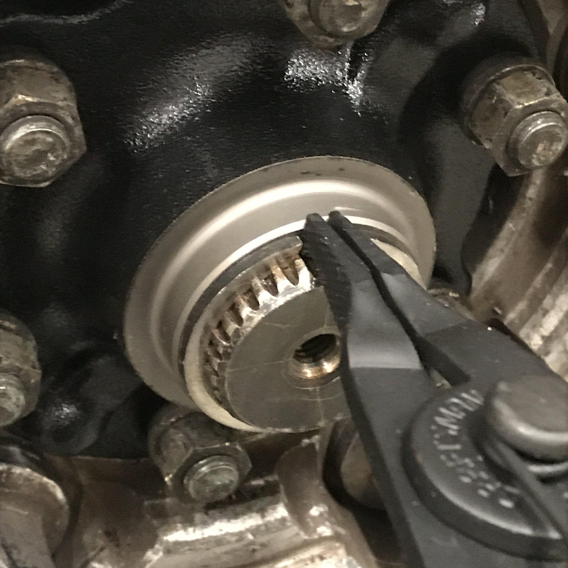

Been trying to figure out the perfect tire size for me...finally settled on Falken AT3W in 285/75/16. Would have liked 295’s but tire selection is very limited. My steering is so much more precise, no longer wanders all over the road, my steering wheel is straight, and the truck definitely feels taller!
Also did the rear rotors, pads, ebrake, and axle seal - found that one of my rear calipers was missing a slide pin 😬. Whoever worked on this last did a pretty terrible job...I’m slowly fixing up the shortcomings.

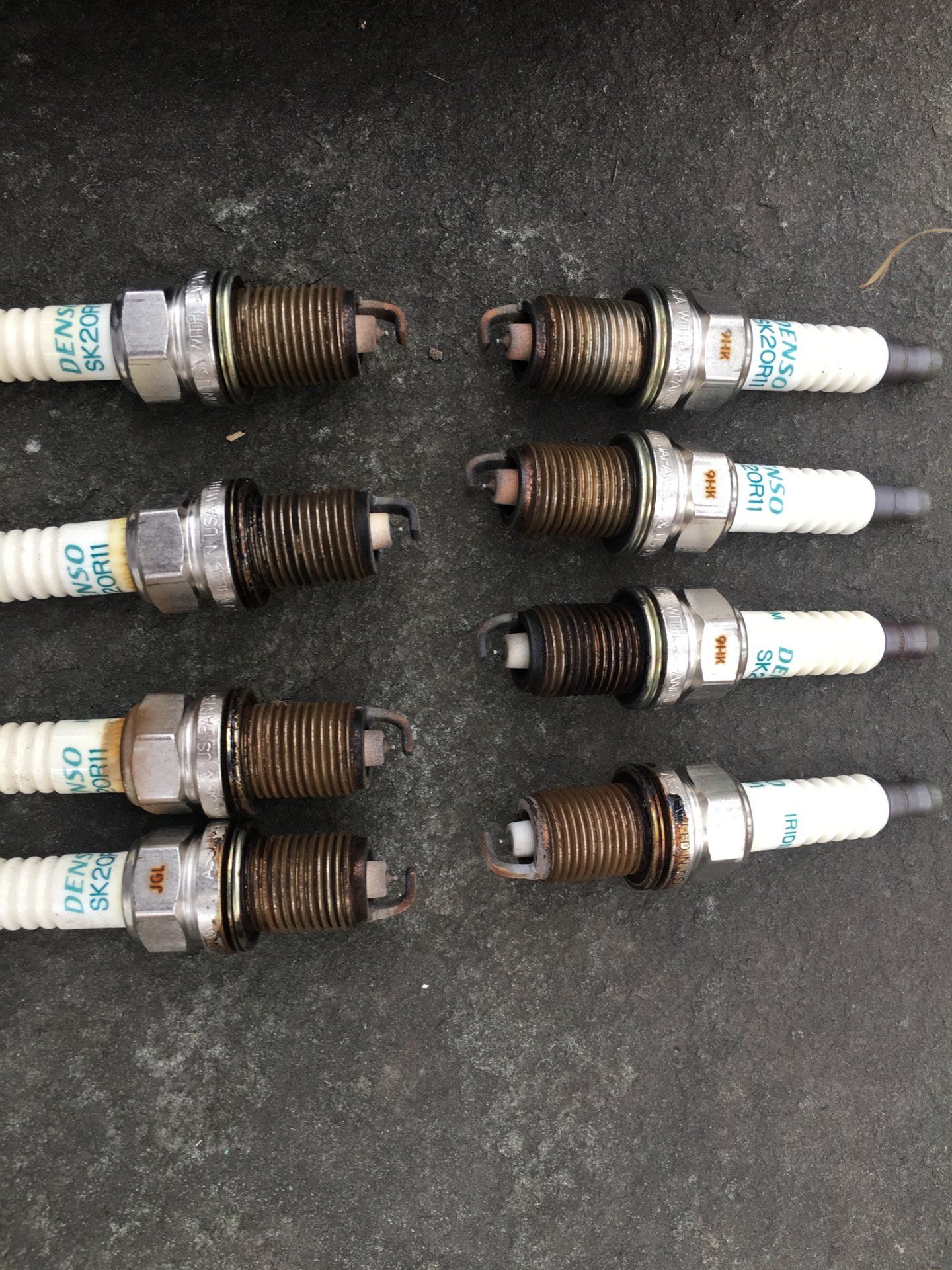

New spark plugs and coils. Took me the entire afternoon, but, I’d never done it before and I had fun cleaning. Comparing to threads here I wonder if the plugs were original at 230k, they were extremely dark brown, but not wet or broken. Coil boots were new.. coils were not. If only I knew two years ago what I know now, this wouldn’t be my truck. Still don’t regret it!
Then replaced my cracked third taillight with the $70 eBay special which turned out to be Chineseum crap that mostly fit, with a deadblow. Win some, lose some. At least it isn’t idling at 1000+ now!
View attachment 1899805View attachment 1899806
