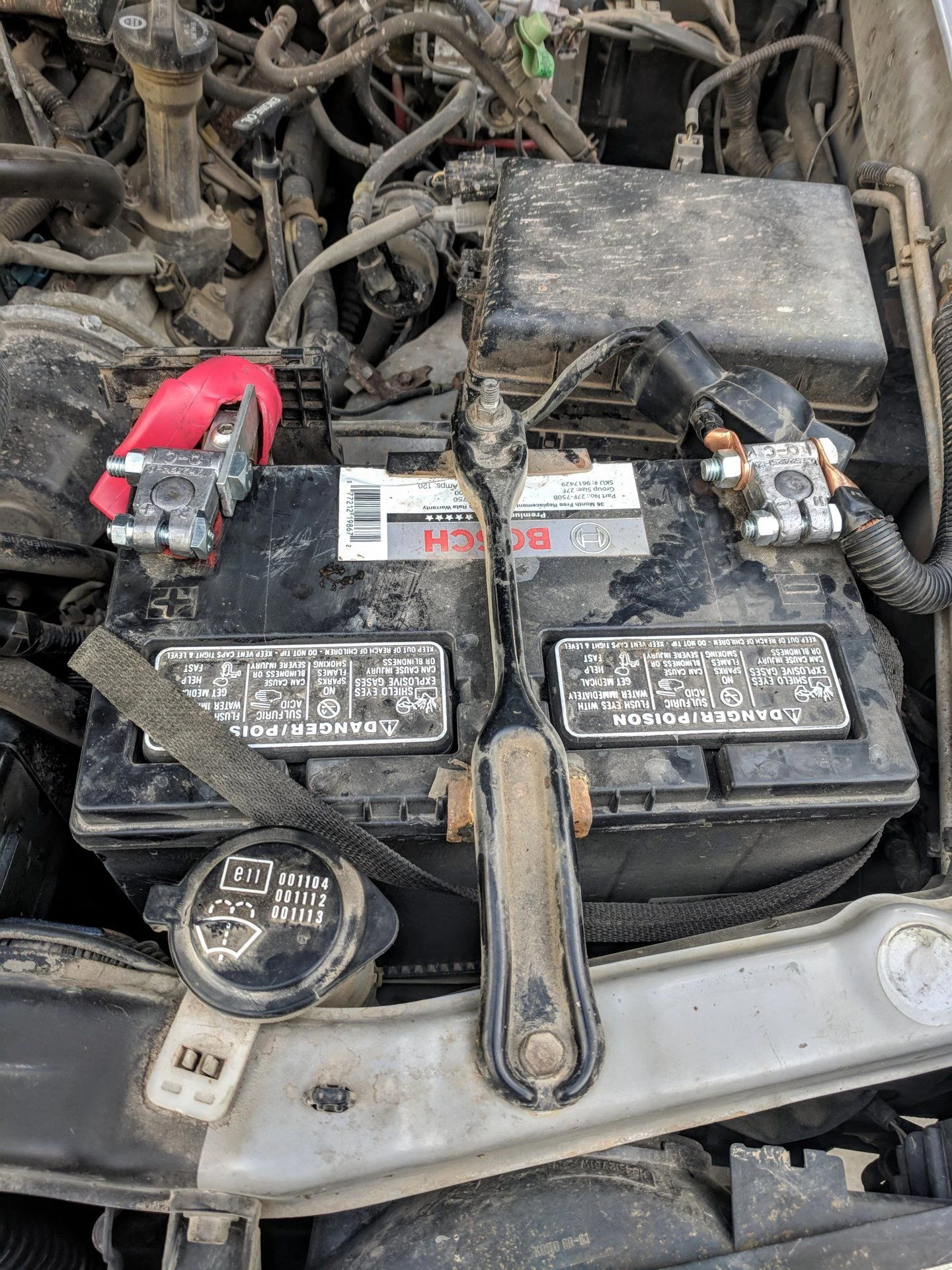

New battery terminals:

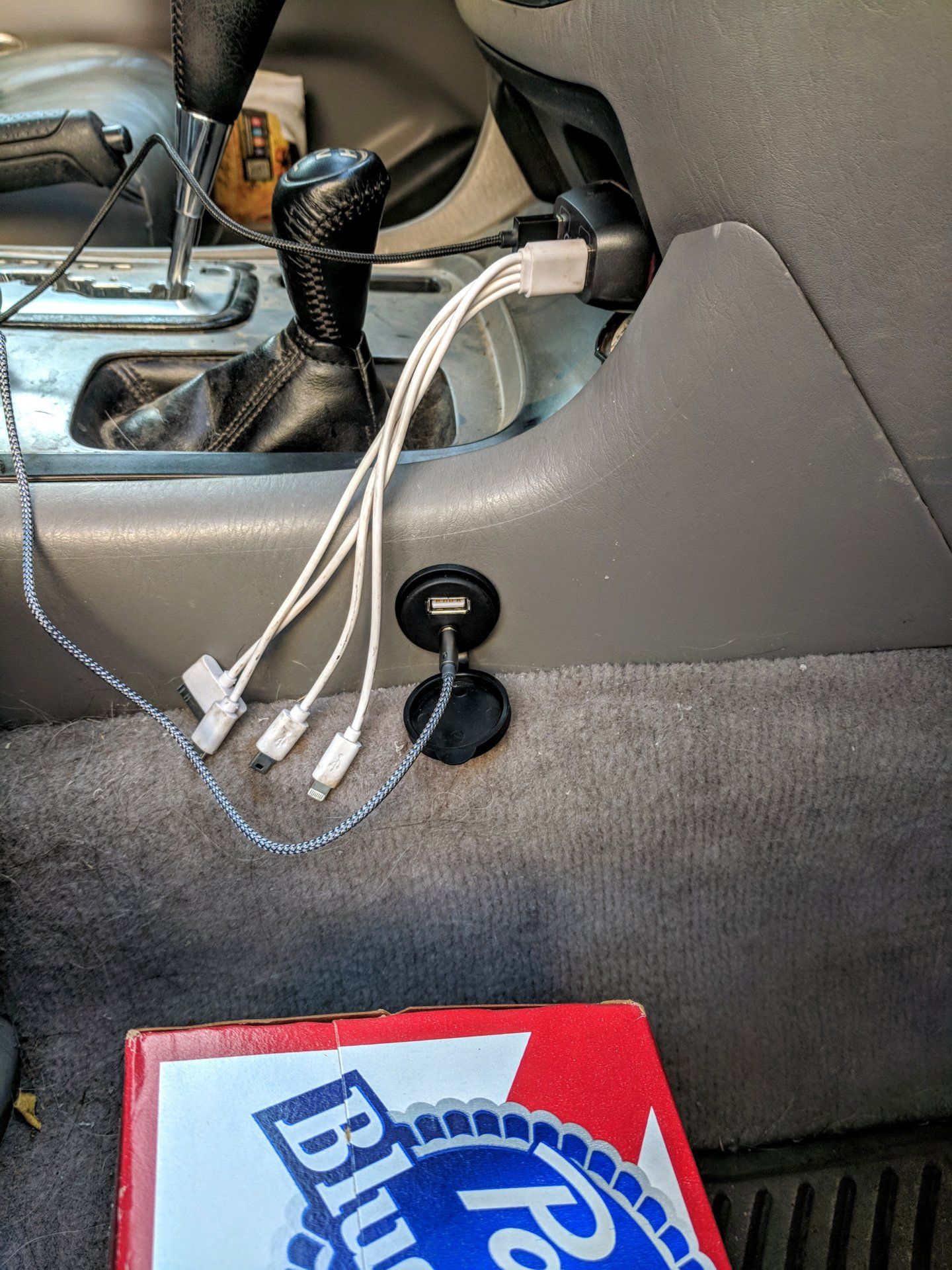

Aux and charging port off the GROM:
Replaced rear audio controls w/ dual USB:

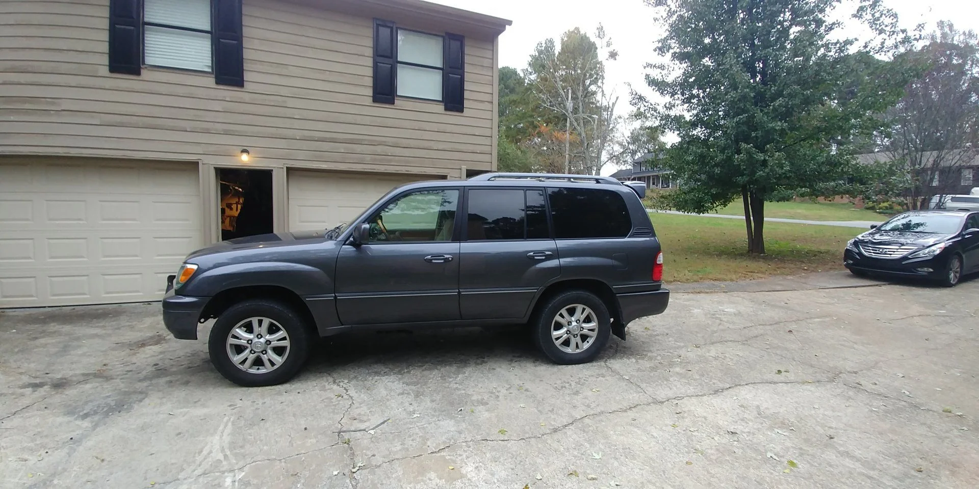

Deleted the running boards on my 'new' '05 LX. Kind of a shame because those later model running boards are kind of bad ass.
Also did a sensor lift to clear the 34s going on tomorrow. Gained 1.5 to 1.75 inches pretty much all around, and one side still sits 1/2" lower like before. This is temporary, AHC delete is in the next week or so.

Well, about that... I got the tires loaded up into the truck this morning then heard the mechanic was pretty slammed today. So, I unloaded them and did some pressure washing instead. I'll drop the truck off over the weekend and just have everything done at the same time (tires, AHC delete, etc...)
Rear looks low because it hadn't pumped back up after loading the tires*
