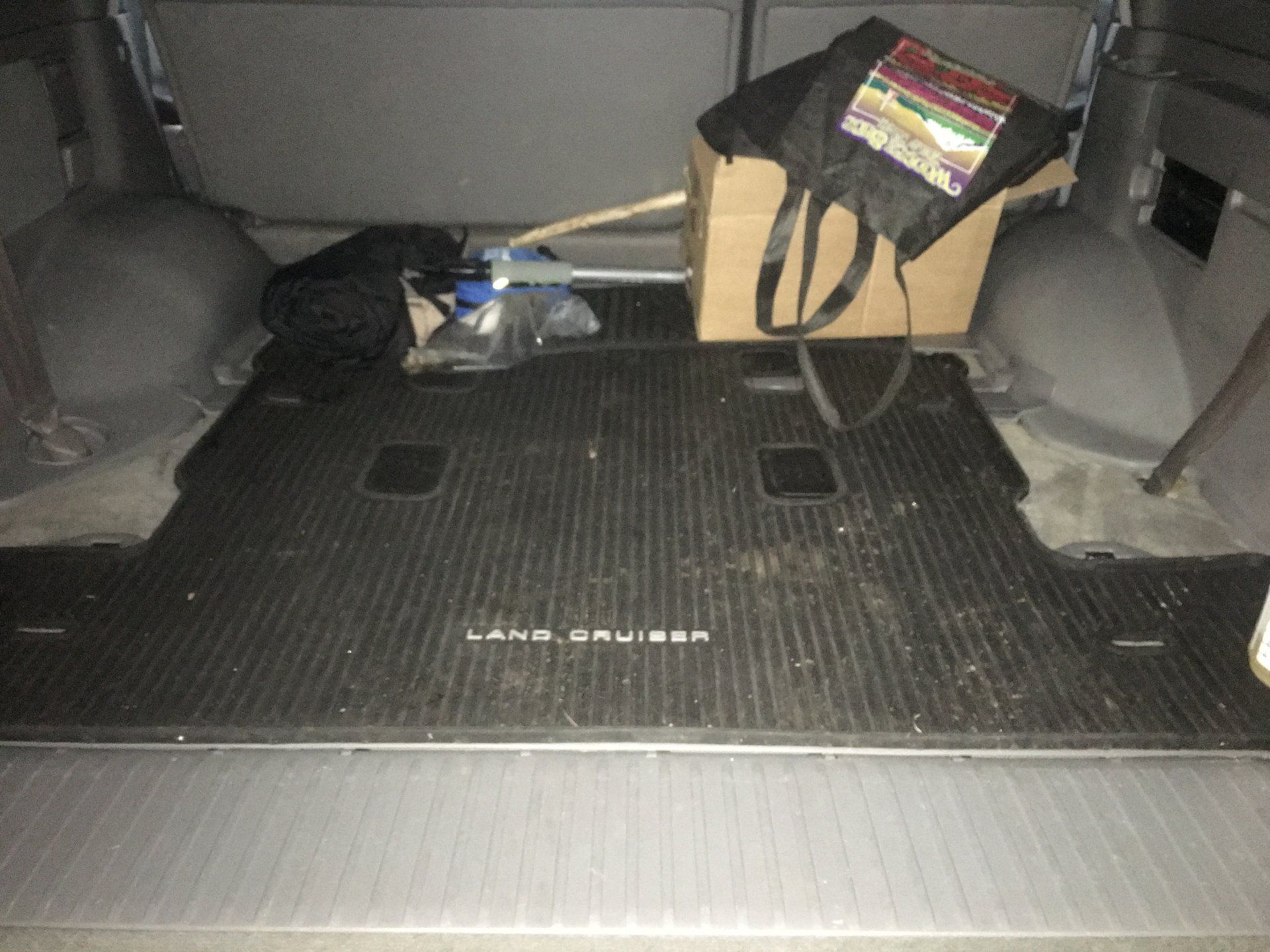

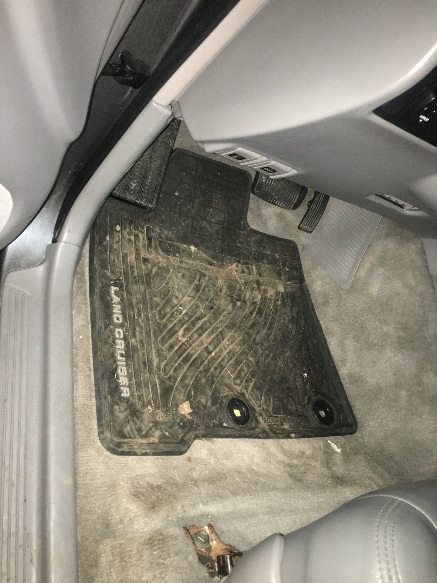

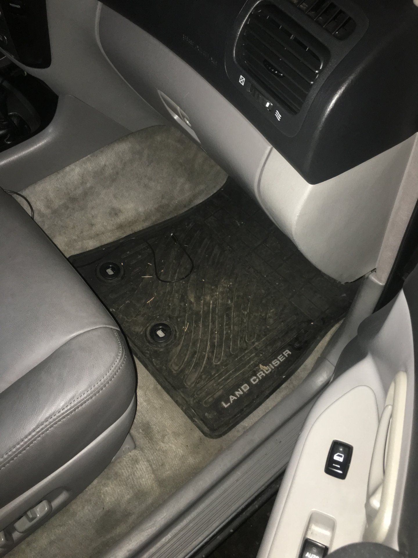

Long shot here, but would 200s rubber matts be a close fit?
I got the dealer to throw in a set of weather techs for my 200 gen I purchased it and swapped the assortment of 200 rubber matts into my 100. Its not a perfect match but I was surprised how well they did fit. A year later and I’m still pleased with them.
Pics please
Mind posting a pic of them?
The 100 is embarrassingly dirty at the moment but here you go.
200 rubber mats in a 100. The holes in the rear line up and 3rd can still be installed without removing the mat.
