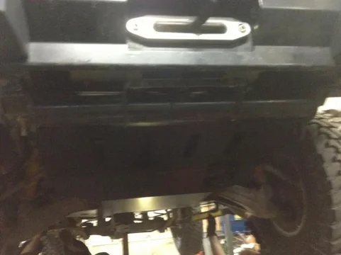

Some is not yet done, but I have re custom sliders, skid plate system, overhead switch console, custom battery boxes and recessed air check in bumper. I have yet to get my snorkel in as its in transit, and I haven't Hooked up my rock lights nor wired in the switches for the back switch panel. I'll show those as I get them. I have two aux fuse panels (blue sea) that are wired and in place but all the roof liner and a pillar need removing. So, in no particular order:

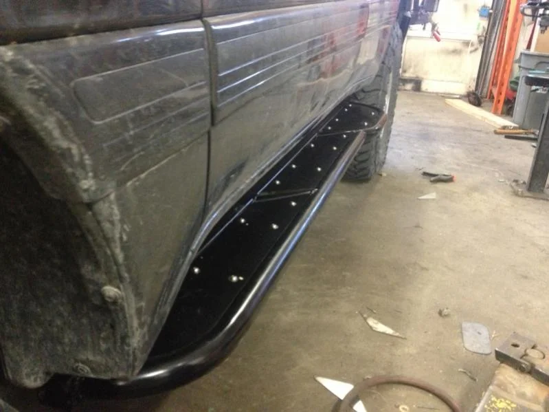

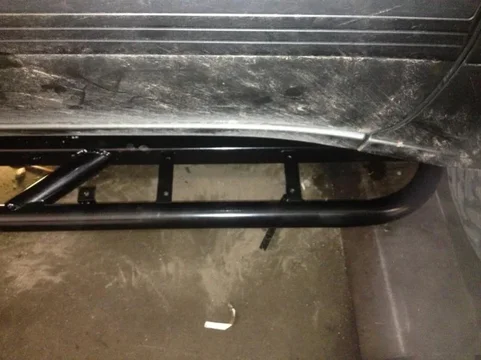

Sliders

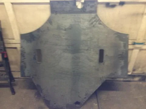

Back skid (middle of truck, already had front one in place) still needing painting

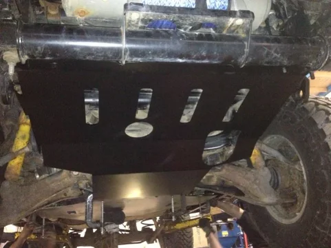

Front skid

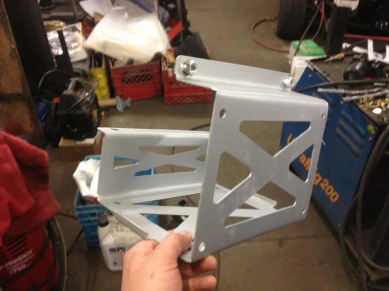

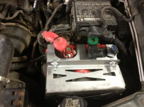

Battery box - not showing clamp down
With clamp and in place, welded down

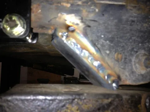

Beefed up rear lower control arm skids.

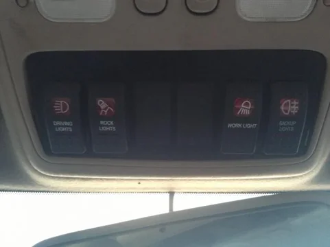

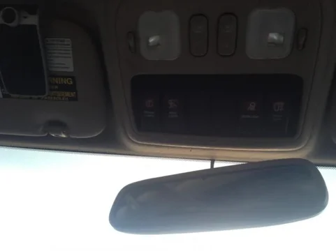

Overhead switch console. Not wired yet and with a couple blanks.

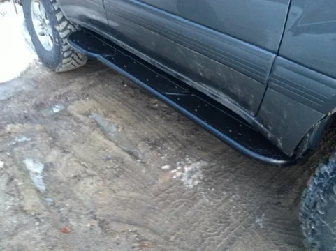

Sliders

Front skid

I like your switch console, looks very clean and simple!

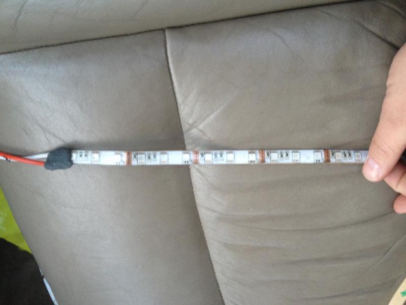

these are supposed to be waterproof version strip lights.. they have been using them on other rigs for the same purpose. You can trim to whatever size, just simply dap some silicone over the end that was cut and voila.
thanks, i hated having switches in my dash.. there was little visibilty to the switch being on as the steering wheel is kind of in the way.
I will use the switch locations on the lower left panel to the steering wheel again, but this will be for critical switches like lockers. i don't want someone hitting the locker if it is in the center console up above.. ie.. kids arm or something.
The strip itself is considered waterproof but the connections may not be. Dab some silicone on the side of the wires too. My LED strips shorted after driving through snow and flickered on/off for a few days before I finally noticed.
