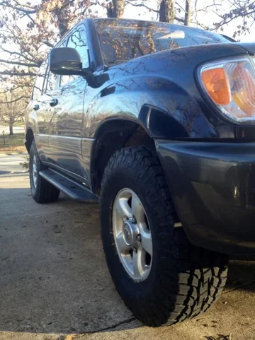

Wheels and tires installed.

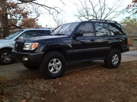

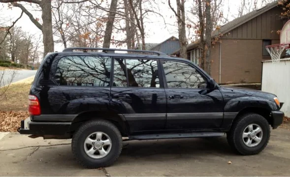

It's been an exciting 3-4 weeks for the 'ole LC.
New shoes, a new rear end, and a little more lift.
Started by adding the Slee Rear Bumper. No swing outs for now.

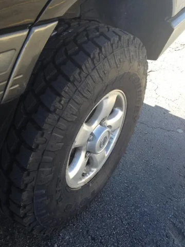

Added 30mm spacers to go with 865s that were already on.
Swapped out my BFG AT/KO II (D rated 285/75/16) for the Toyo Open Country AT 2 (295/75/16 E rated). I'm kind of stunned at the improvement in ride quality. We'll see if they hold up to the 50k guarantee. The KOs were very durable (60k with plenty of life).
Wit the extra weight and new rubber, she drives great and smells good. The bumper really helped the suspension calm down. The 10 ply Toyos handle the "inconsistencies" of local roads very well.
Probably need to add that Blackwater did most of the work, Thanks for the help !
Layonnn, looks great. When I ran those wheels, I thought it would be a good idea to get a 2nd spline drive socket. If you lose or break (i.e. impact gun) that one tool out on the trail, you'd be screwed.

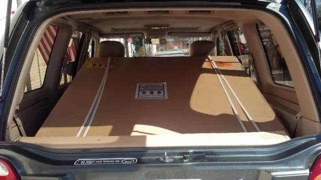

Today I learned that an ARB Pilbara rooftop tent will fit in the back off a 100. I just picked one up at Iron Pig Offroad.
