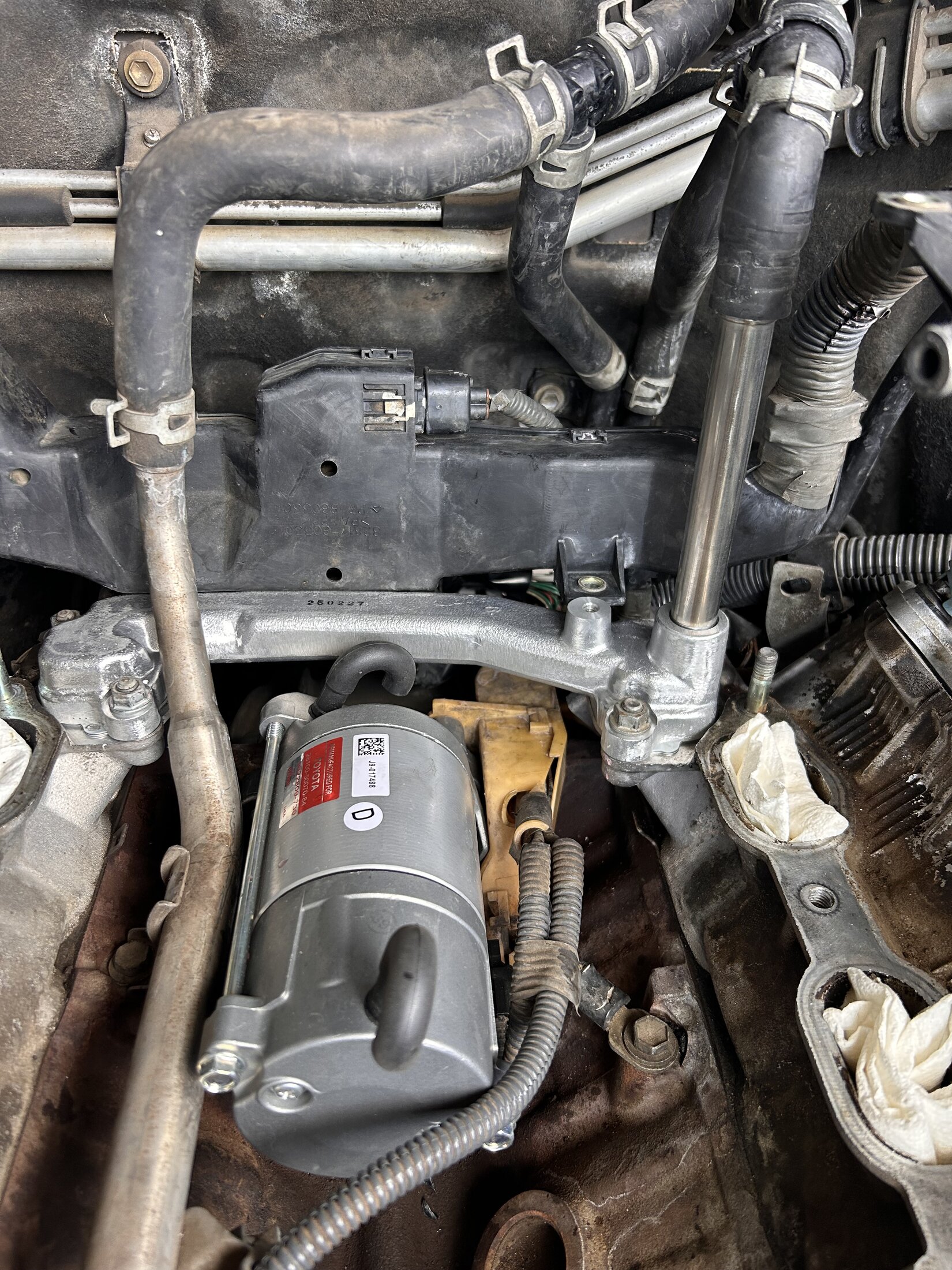

What was originally going to be just a crossover heater pipe install ended up being a starter replacement (since I was already there), lower manifold gasket (since I was already there), injector refresh (since I was already there), water temp sensor (since I broke it pulling the manifold out), battery tray/compartment de-rusting and coolant flush.

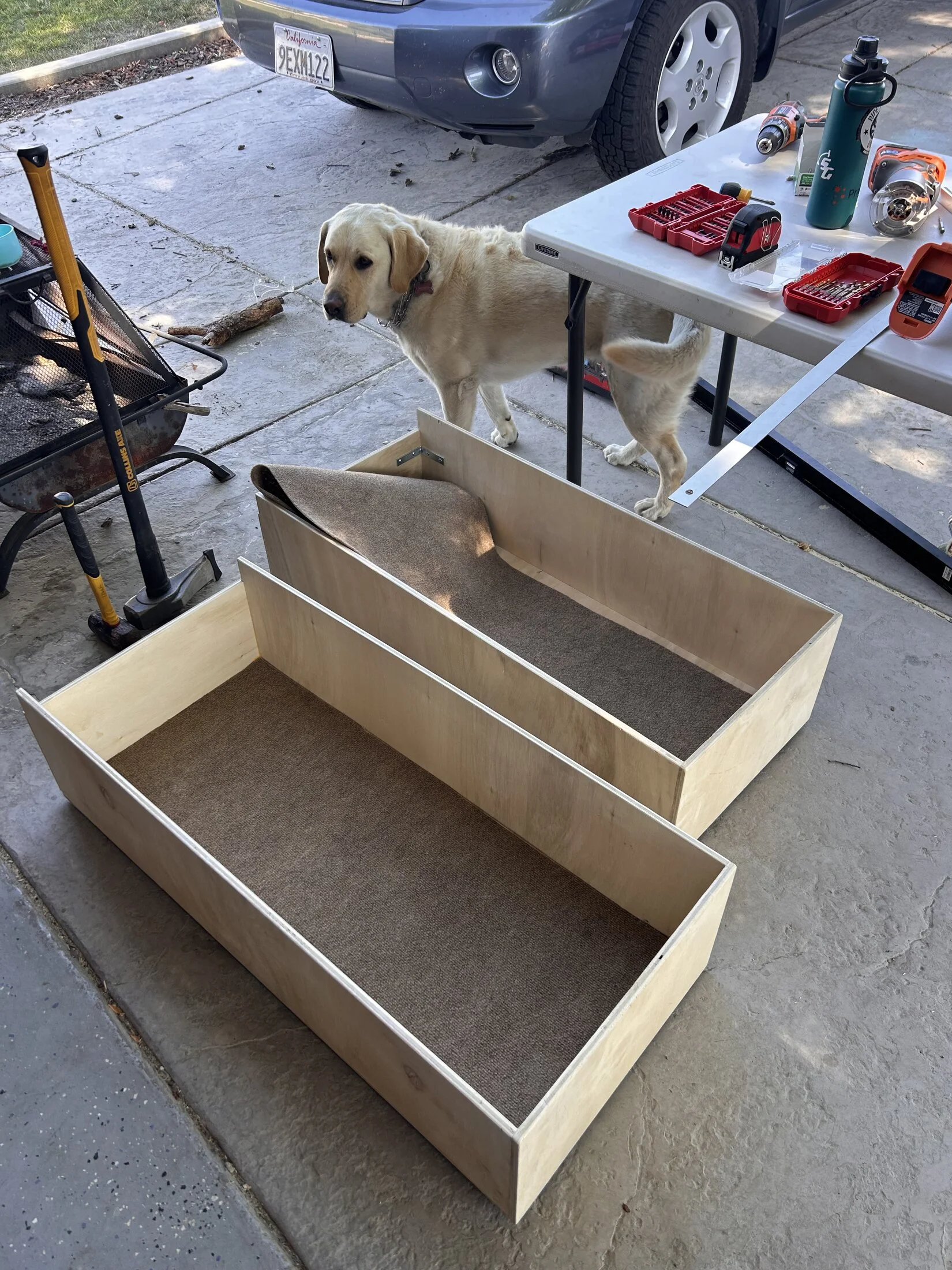

Oh, and I finished the drawers for underneath the sleeping platform I built. Was a productive Land Cruiser weekend. 😅
Everything went more or less according to plan and by 10pm Sunday night Liberty was purring like a kitten.

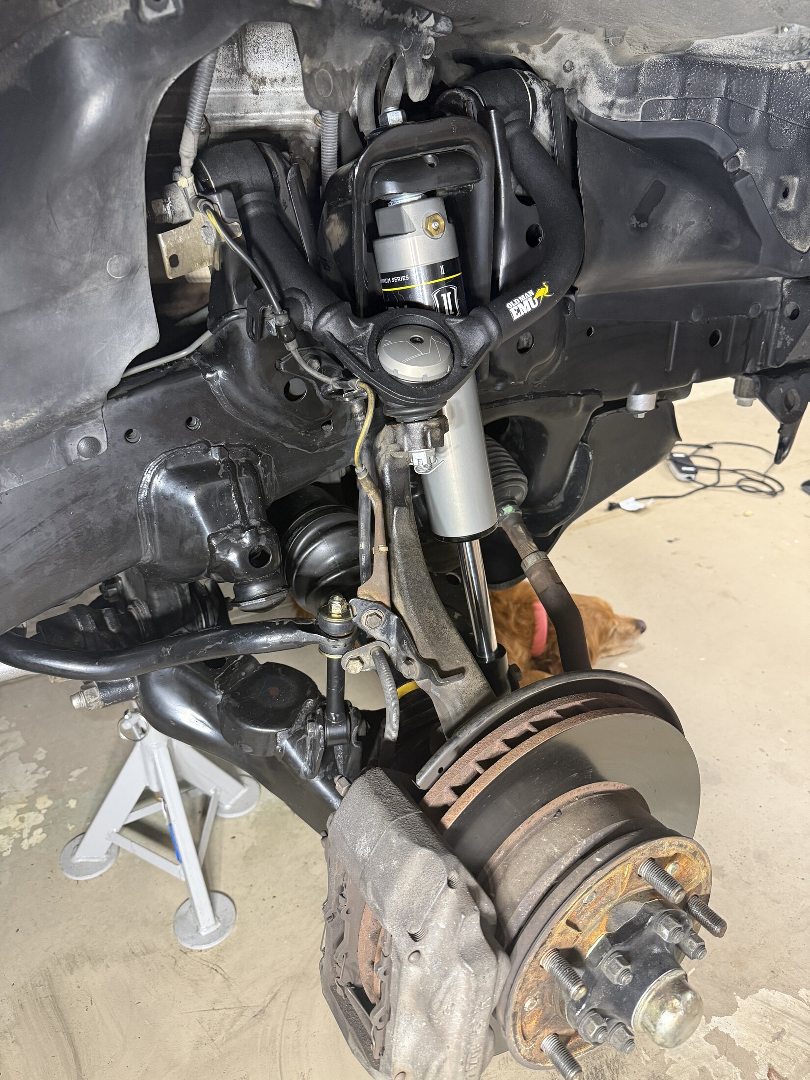

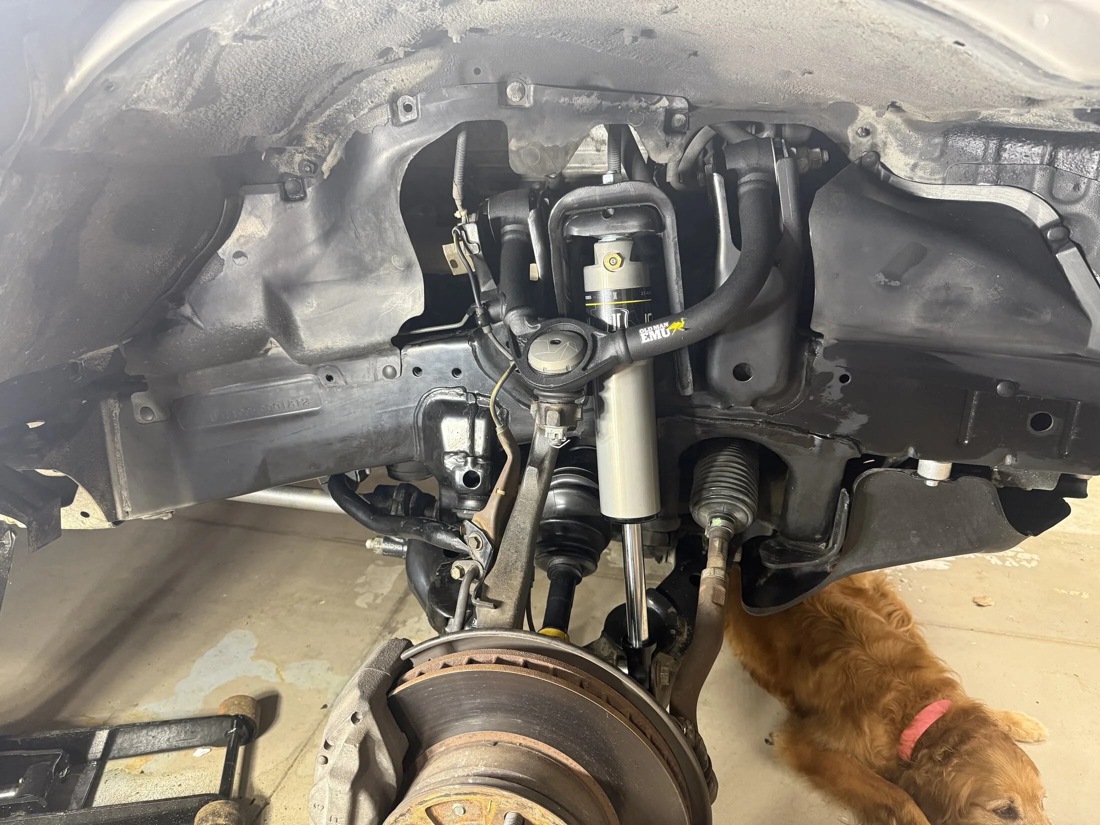

Sumo underdrive was a success! Used trans install was a breeze. Test drove 6 hr round trip for a set of KISS drawers. Love the regear. If I could do it it again I'd shoot for 4.88's in the diffs, but the 4.56 equivalent in the T case is legit. 35" load range E's pulled the girl down without the gears significantly.

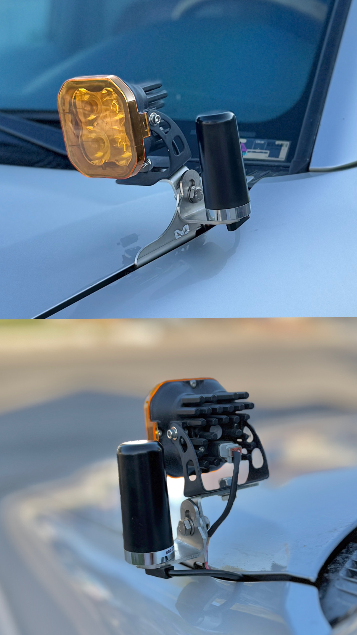

Switched to the Bolton Technical stubbie 45/5G cell booster antenna.
The standard big one just vibrates too much for this mount, this one hits the sweet spot.

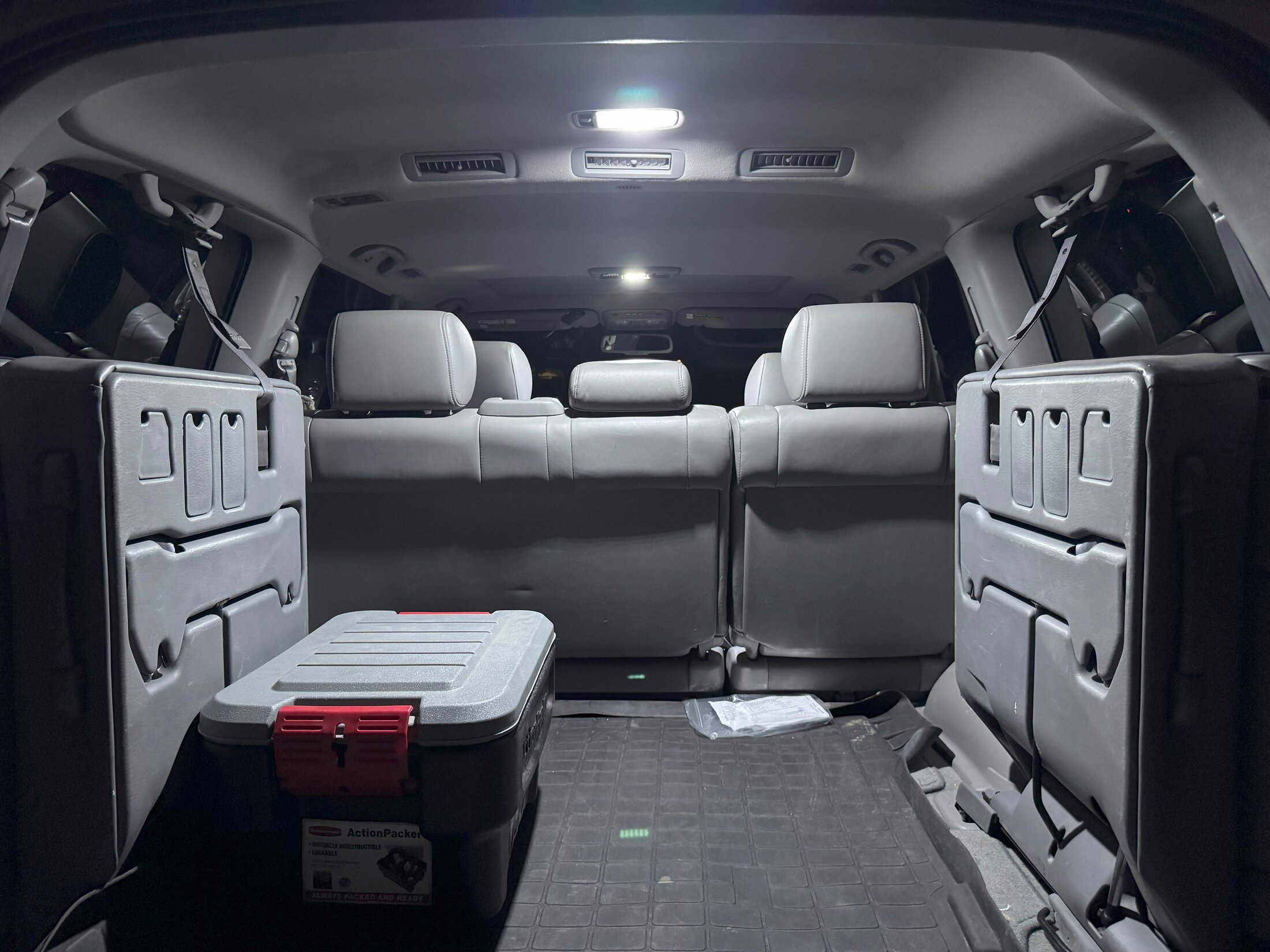

Thanks L @FullyLitLED for the plug-and-play LED conversion. Love the brightness of the interior! Highly recommend this kit. Before and after pics. For camping and night ops, the brightness is great. The front reading lights are the red LEDs, and they are perfect for keeping night vision while driving.
After:
For awhile i had forgotten that there was a dome light in the 3rd row/cargo area. I was wondering why it was so dark back there. Then realized my kids had turned off the light so i had forgotten that there was a light back there.
