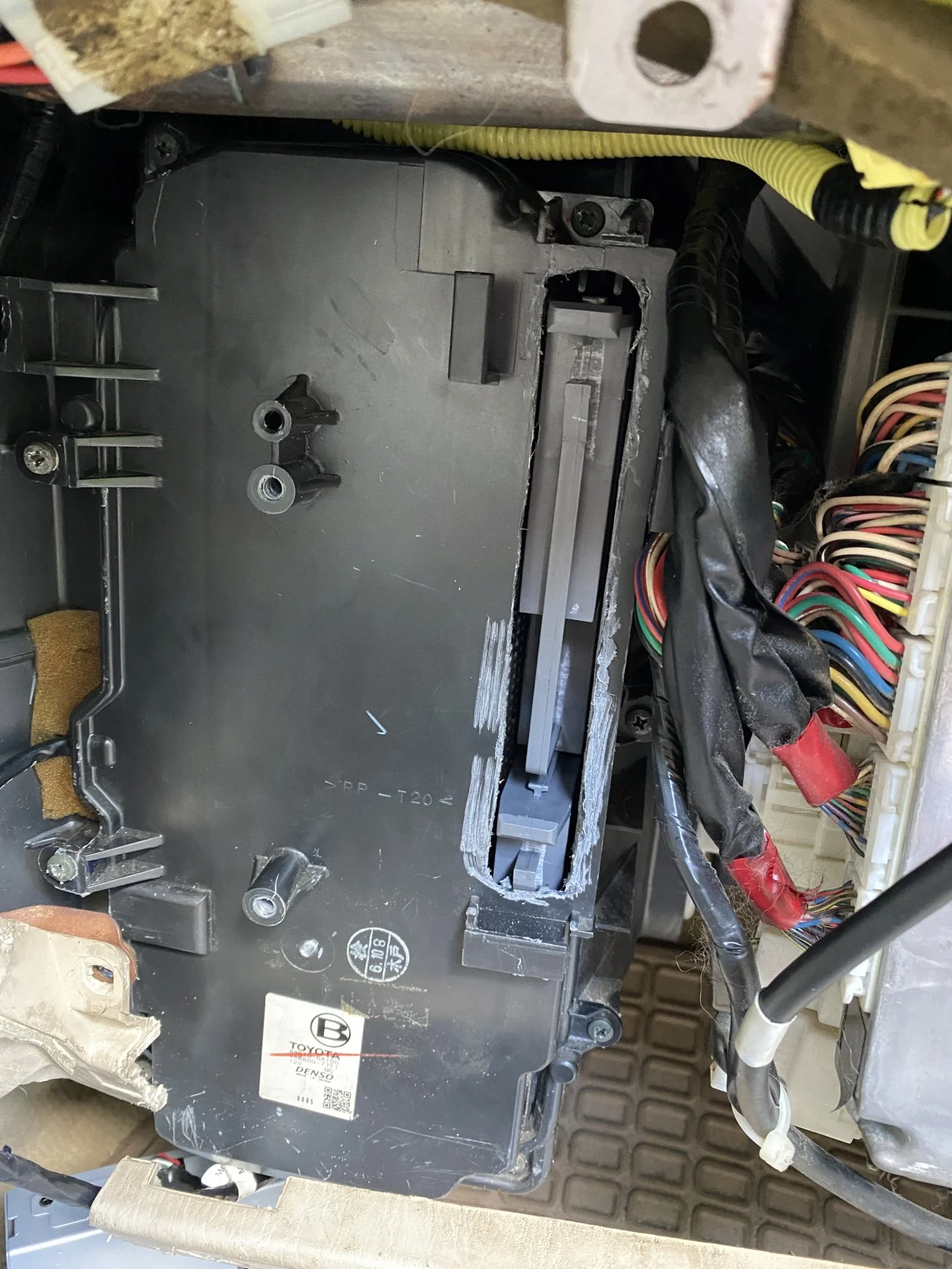

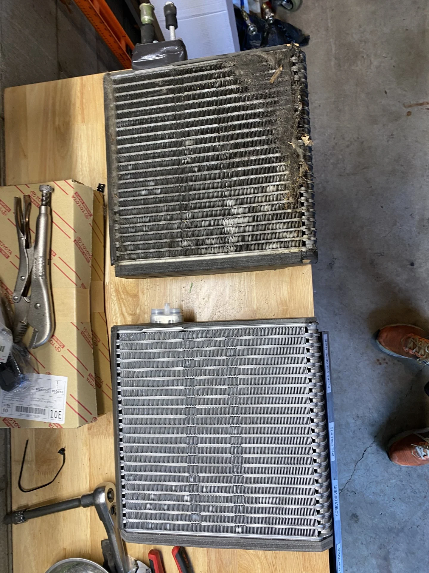

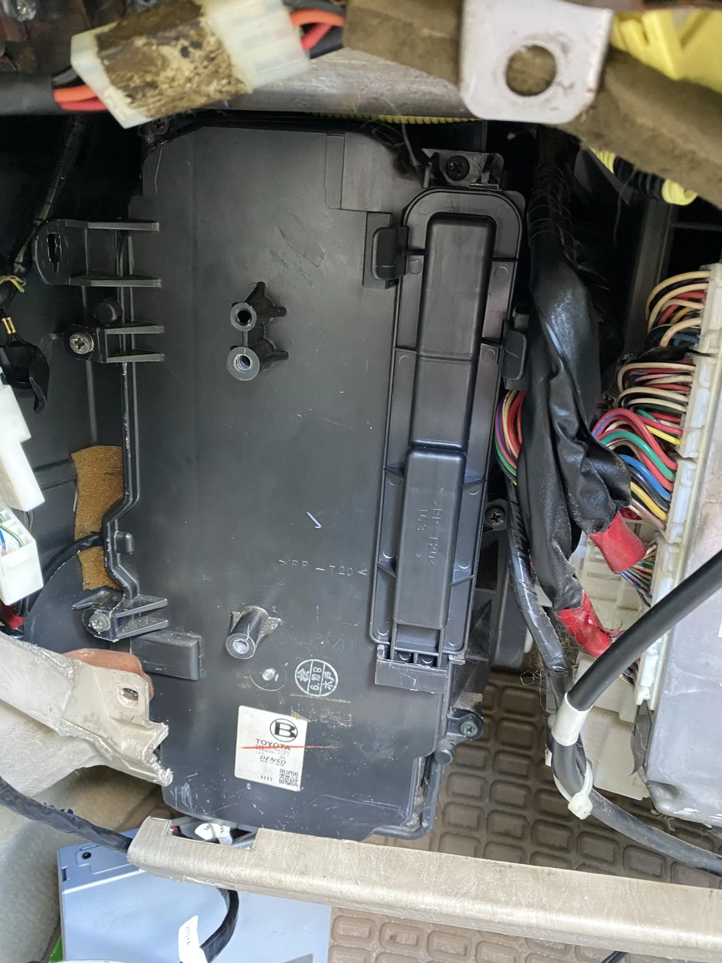

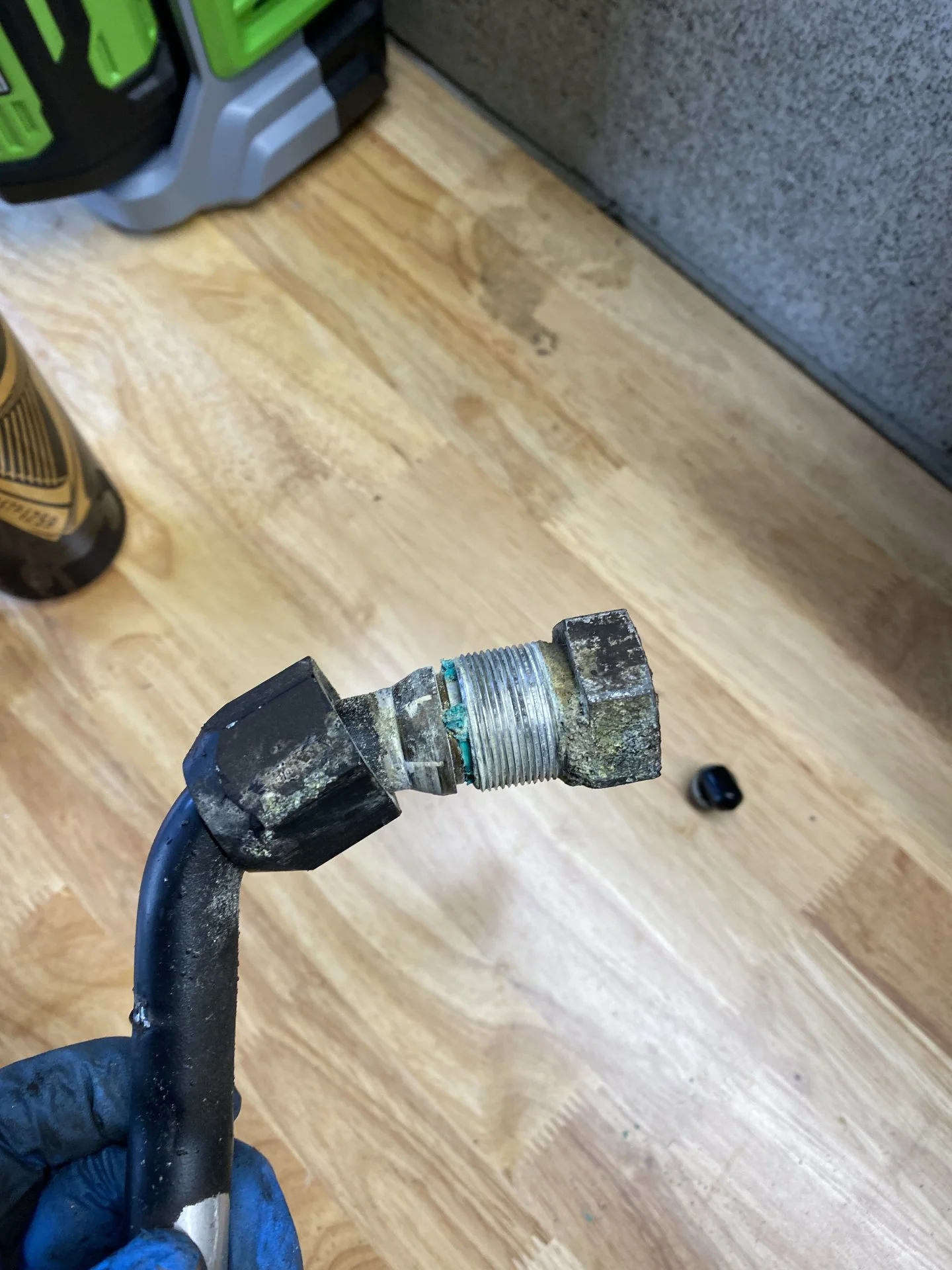

Found the leaks in my AC finally. PO had a rear AC block off kit but it looks like the o ring in it failed. Plus, my evaporator had a decent leak in it, too.
They cut the line right below the passenger door. Which I’m actually happy about because it was easy to pull it out.

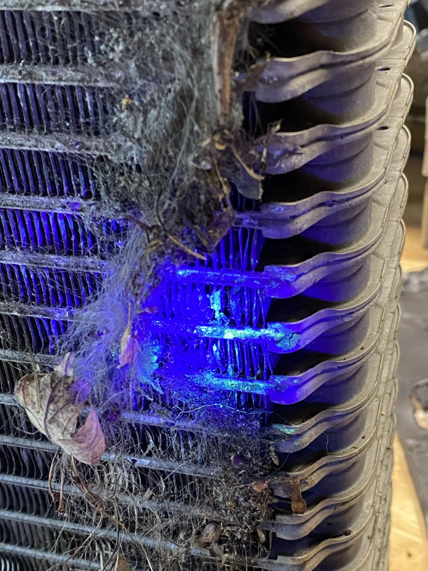

Old and new evaporators. I got the denso unit on RockAuto
UV dye showing through here.

Waiting on the block off caps from Street rod guys. Seemed like the simplest and best option to block off the rear AC again. I’ll be able to take off the unused hoses to send out to cold hose rather than reinstalling one of the dorman kits.
