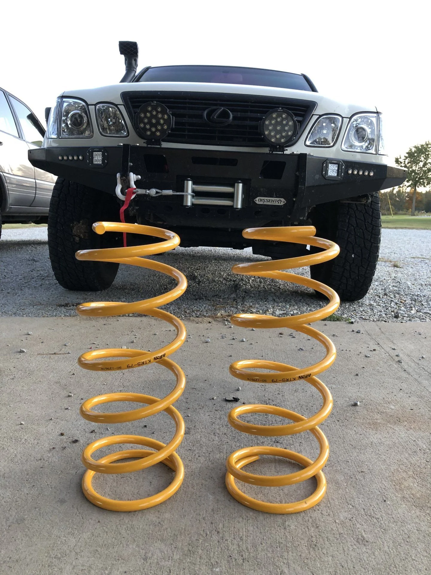

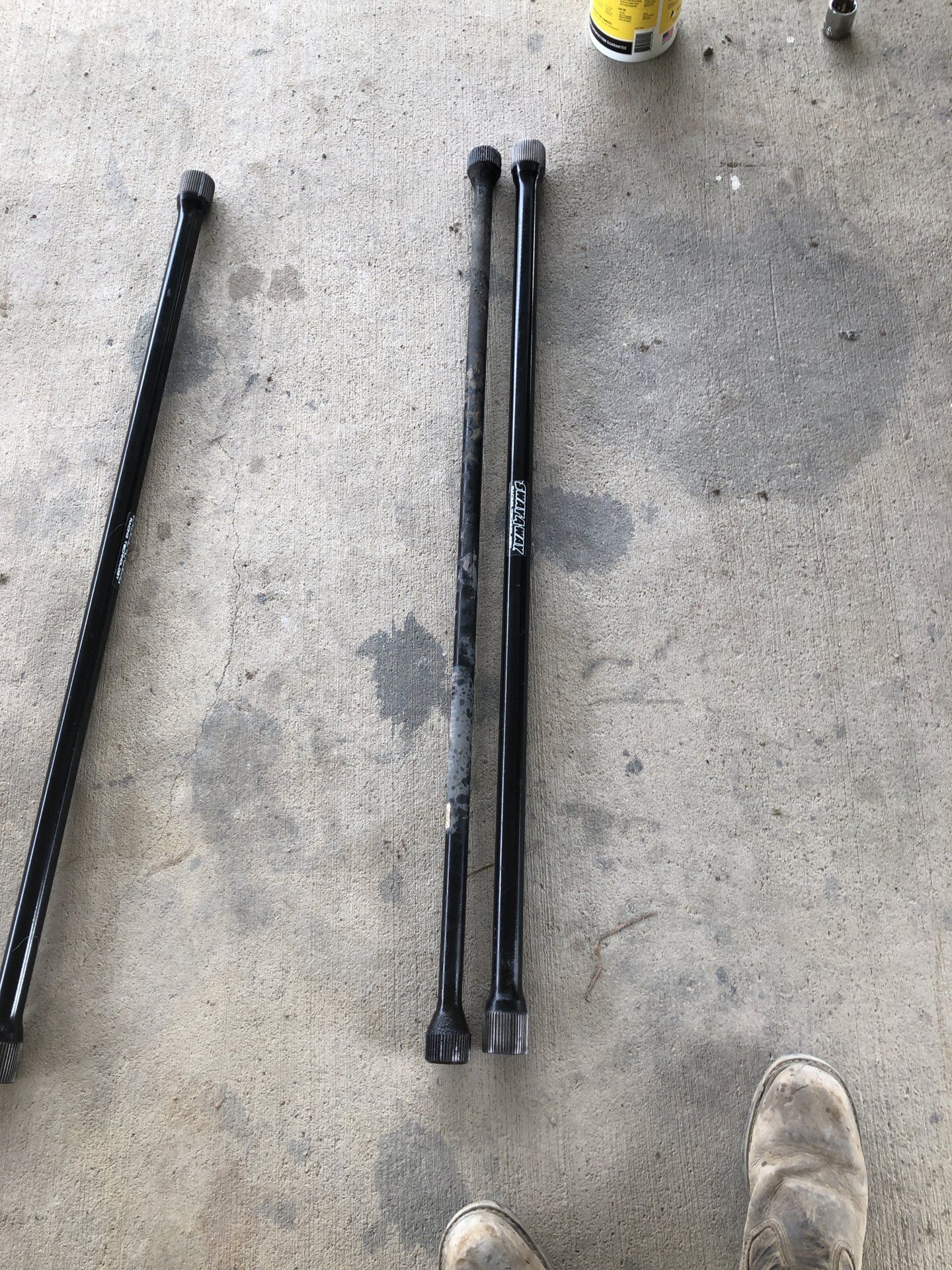

Changed out torsion bars and rear coil springs. Rides much better. Also finally installed my winch.

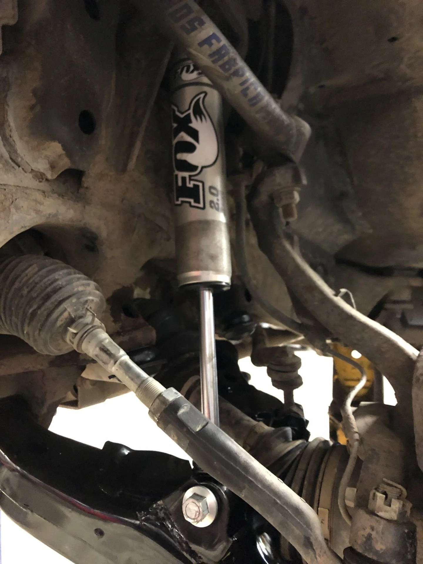

Replaced front shocks. One top nut came off ok with only pb blaster and vise grips. The other required sawzall. Next time I'm going to order replacement top washers, as my sawzall always seems to cut into it if I have to saw off the nut.

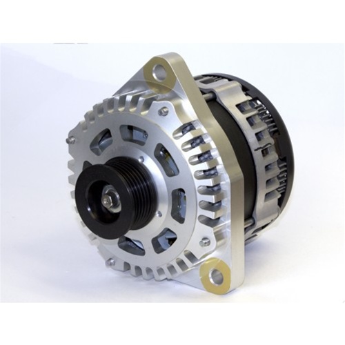

Just ordered a new High output alternator
We use this company a lot for a different application and they have good products.
Do you expect that the durability is better than a Denso reman? I don't need higher output but I am curious if lifespan is improved with a unit like this.

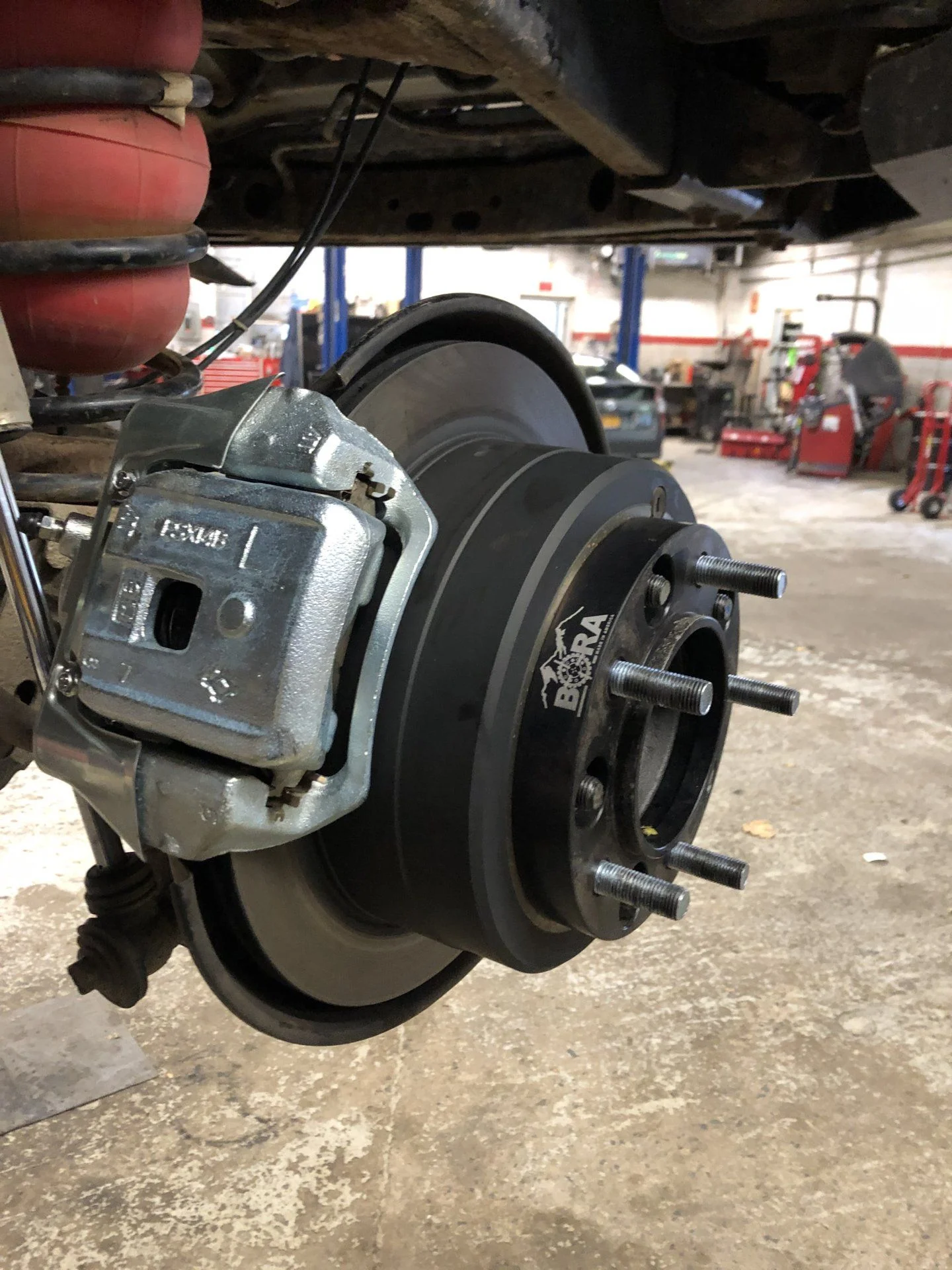

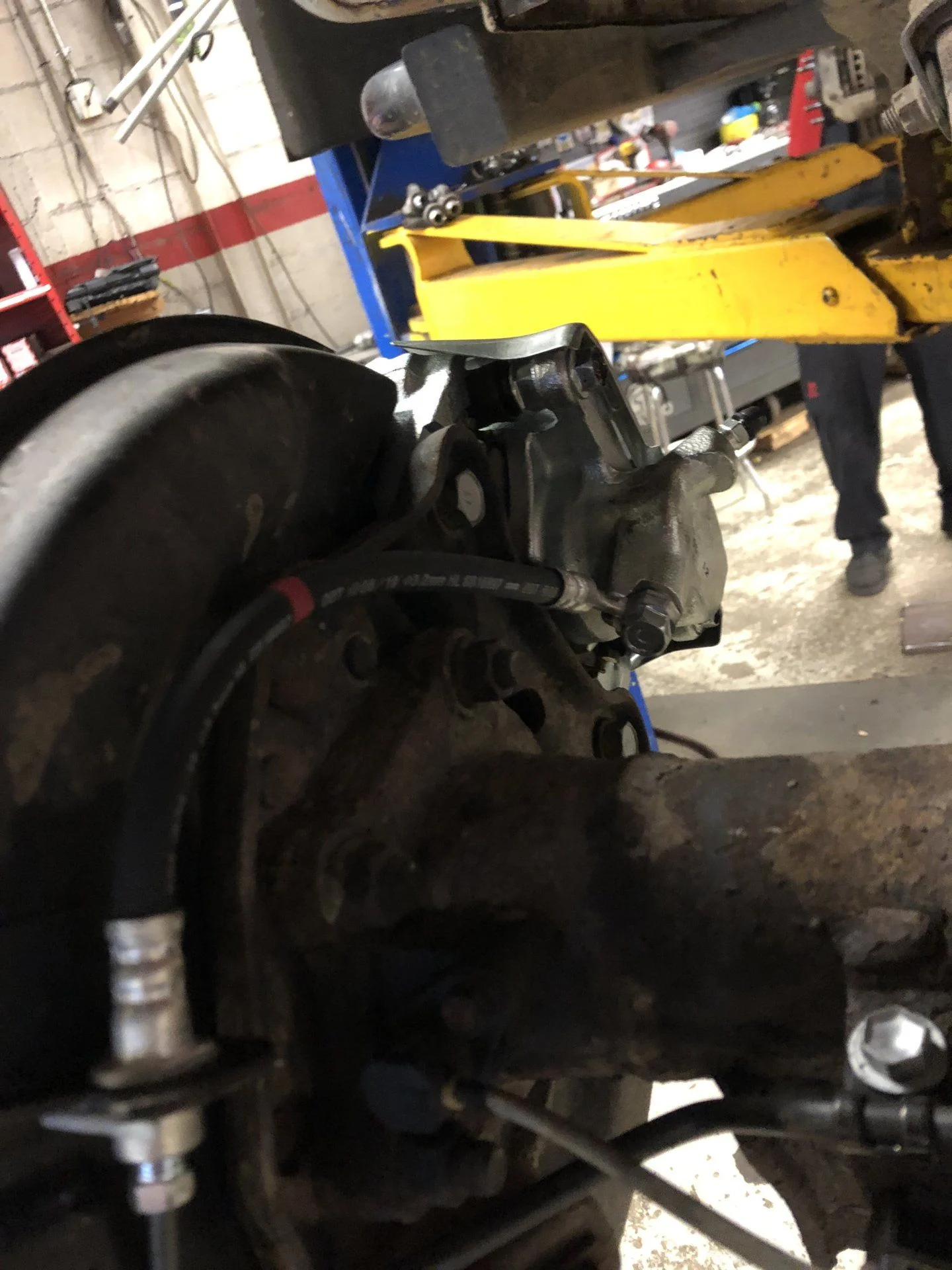

Rear brake overhaul: new calipers, hardlines on axle, all three soft lines and brackets, new pads, rotors, slide pins, boots, clips, and clamps. Basically in the rust belt everything has to be replaced.

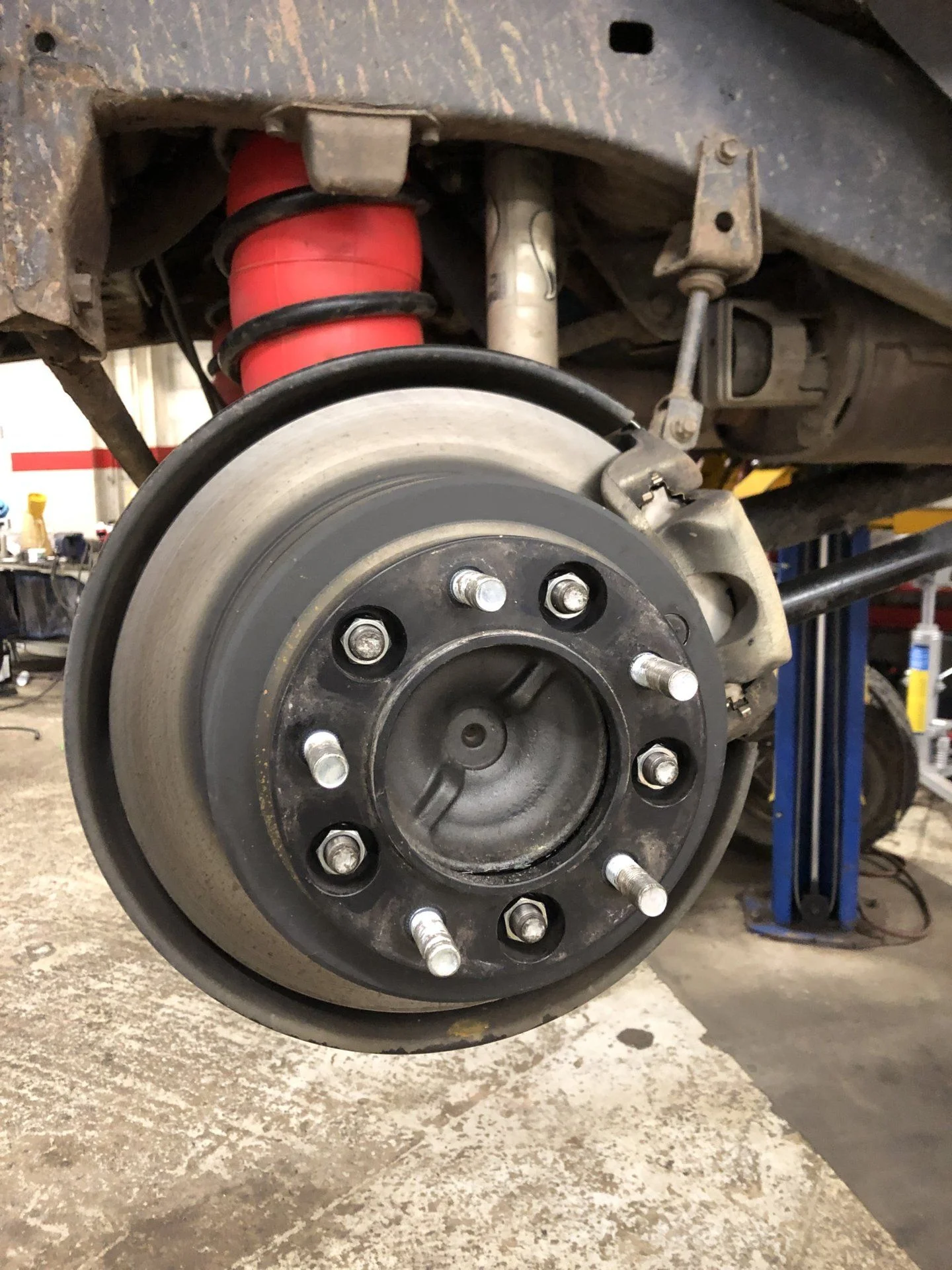

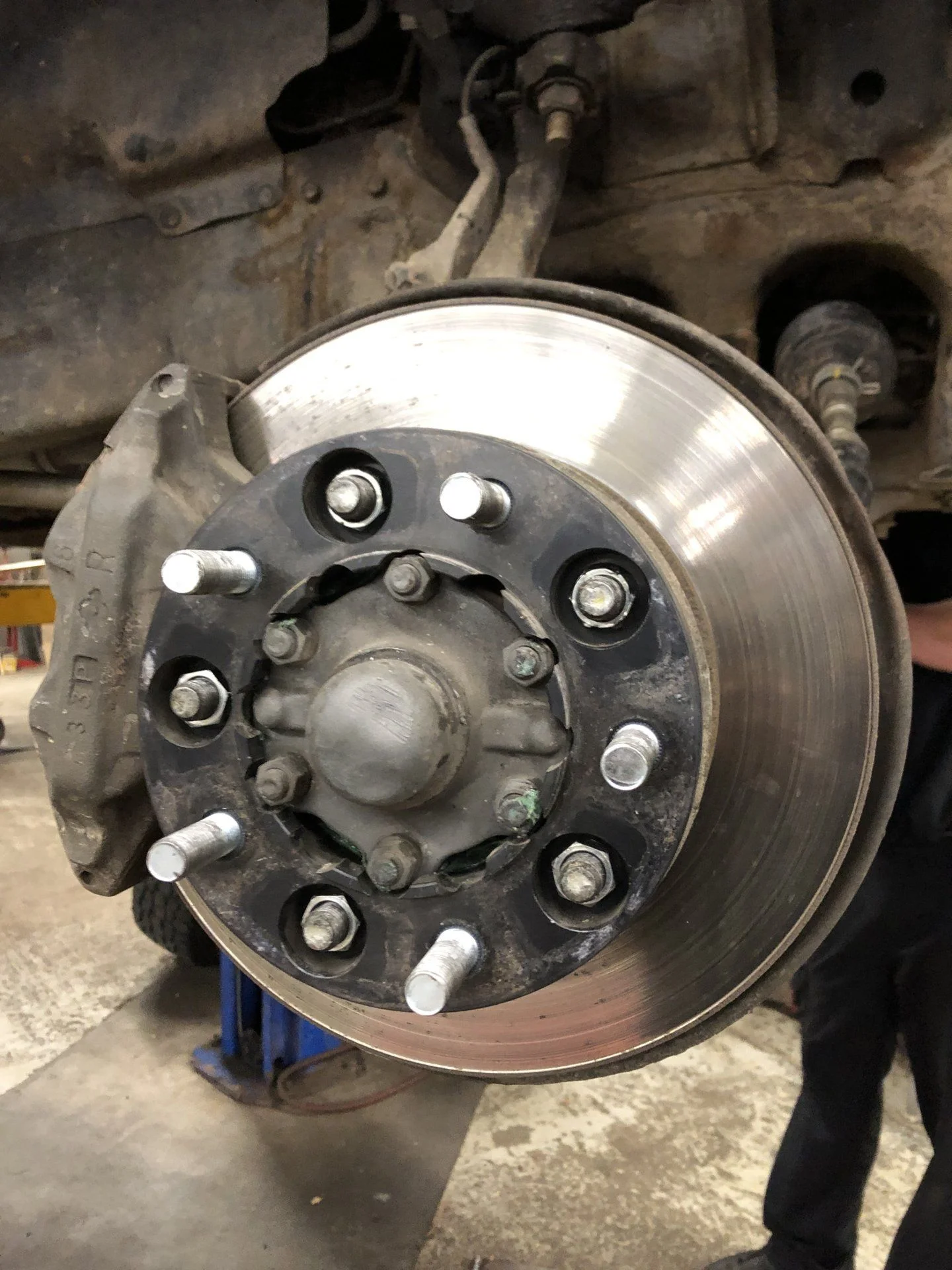

Installed 1” spacers just to see how they perform. No verdict yet.

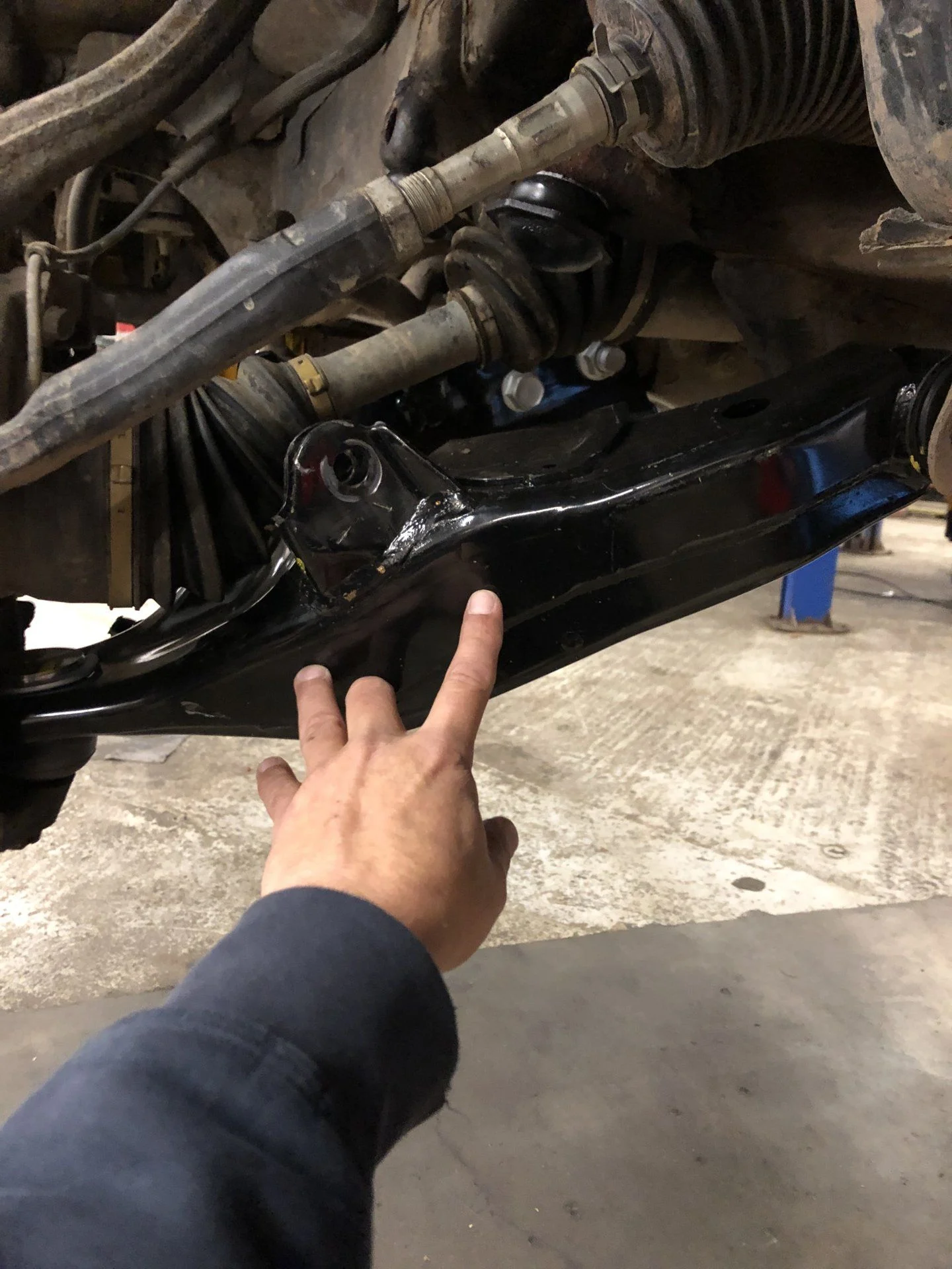

Then new front lower control arms and hardware/bump stops:

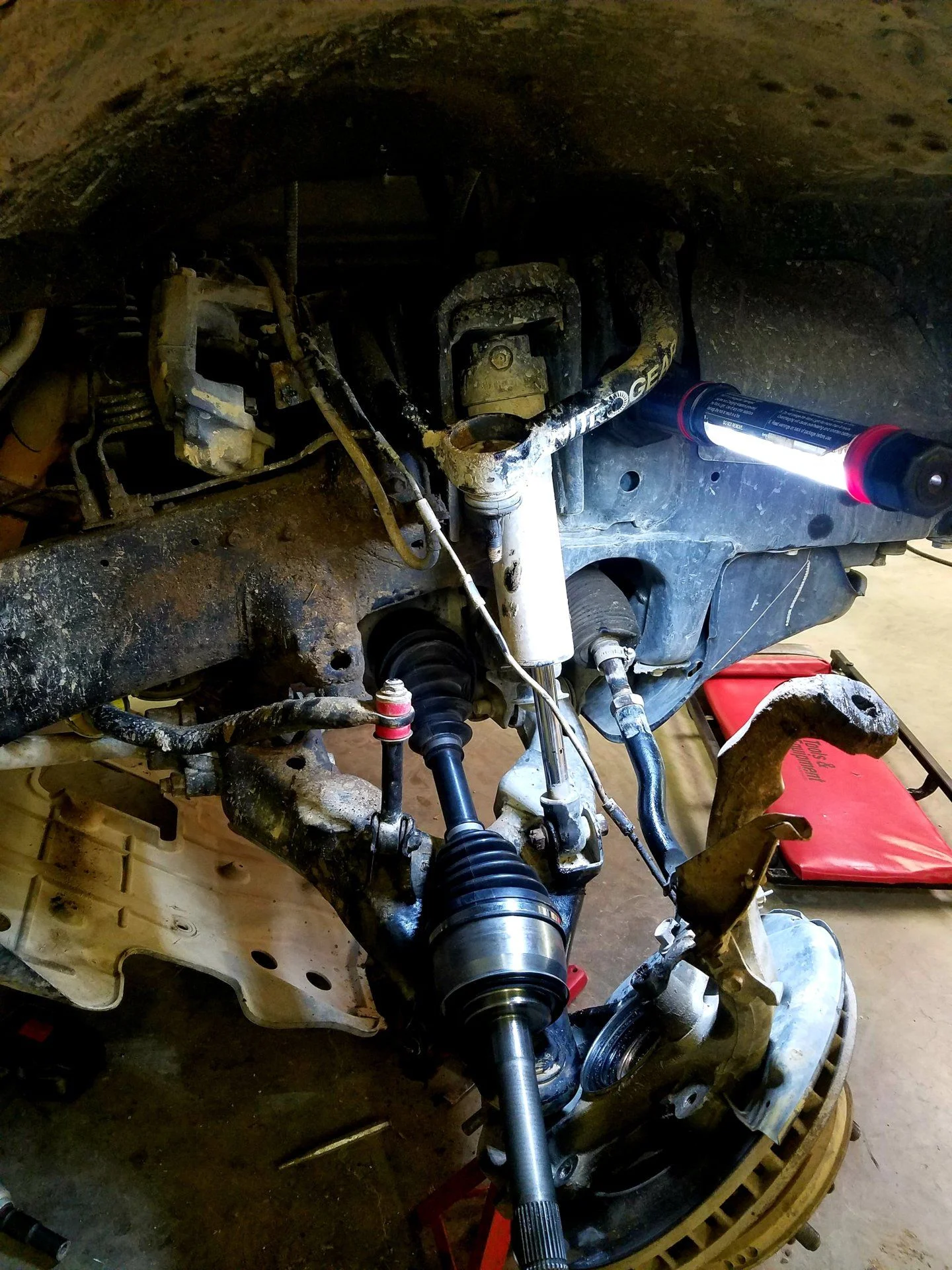

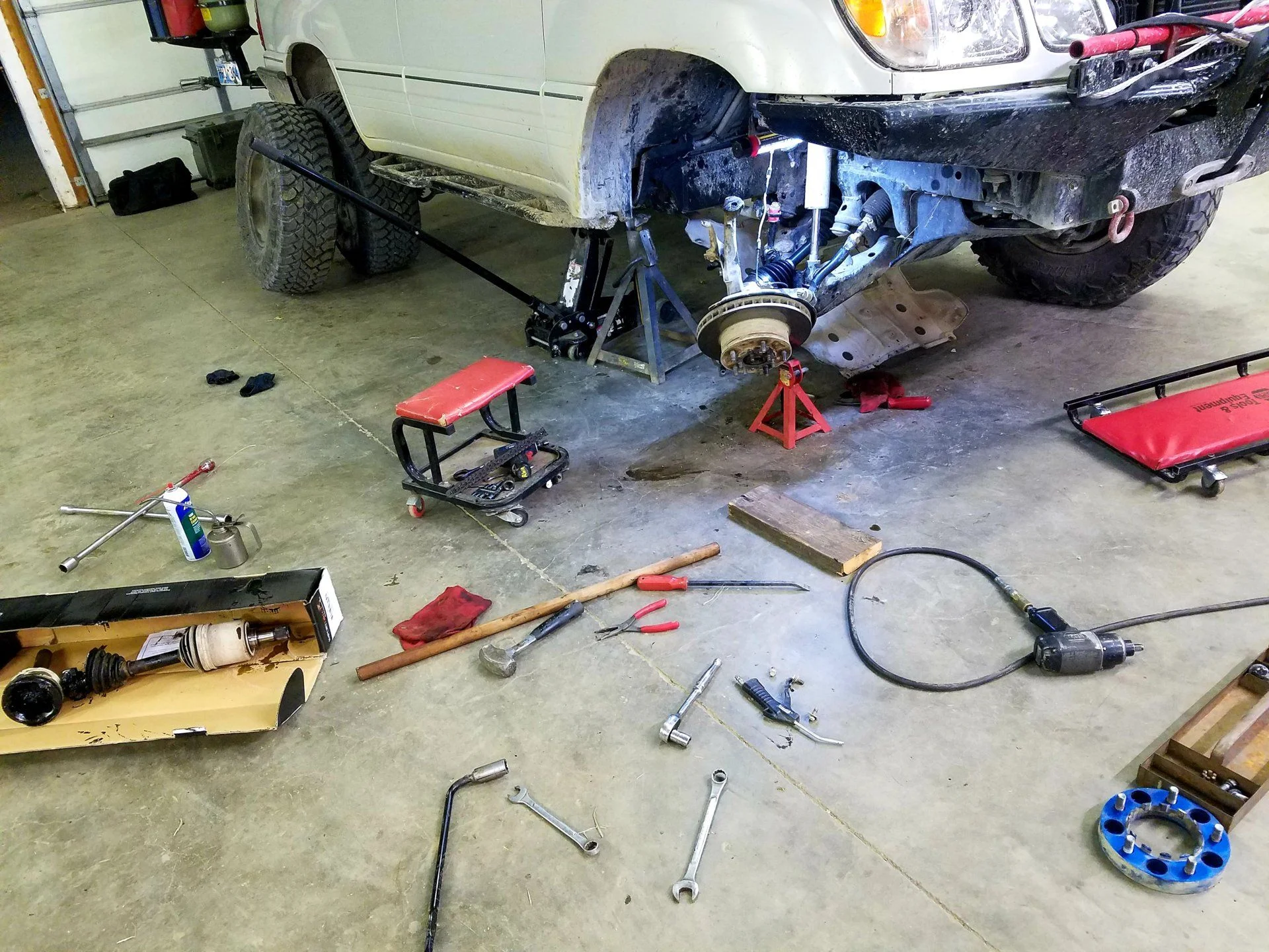

Threw a new CV in. I was used to my Taco and forgot I needed to remove the lower. I first thought "S***! wrong parts!...again!"
Your looking at very dirty Icon 2.5's (awesome). Slee diff drop. Homemade extended sway links. Nitro Gear uppers - (7 outta 10) my personal opinion on these uppers. They do use Tundra ball joints though.
You running extended travel Icons as the description of those UCAs like to mention being made for?
