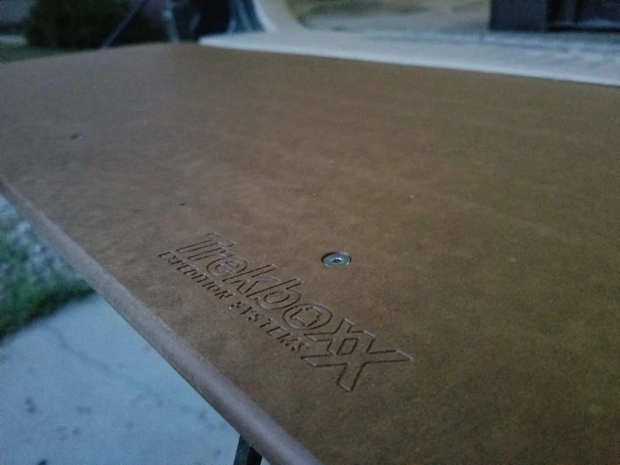

New tailgate cover!

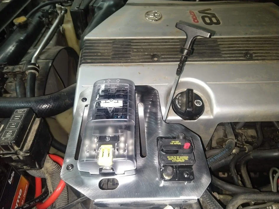

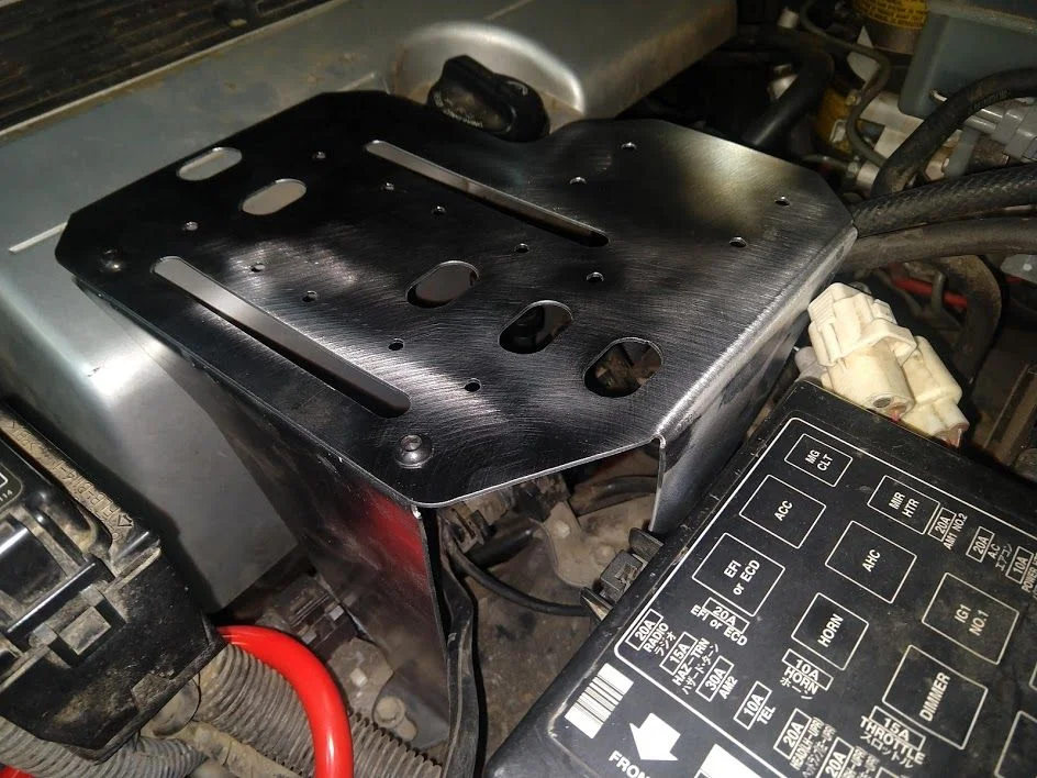

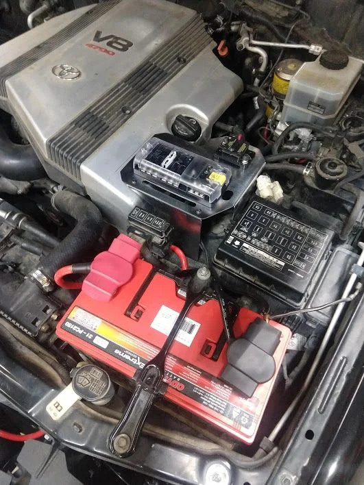

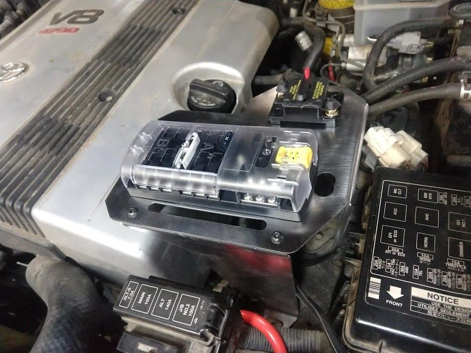

I was commissioned by @ga12r1 to make a direct bolt in fuse block bracket.
Here is the prototype. It will hold 4 different BlueSea panels (5026, 5025, 5029 and 5028) two 12 and two 6 circuit models and a spot for a Bussmann breaker as well. I'll make the first one from 1/8" aluminum and if I don't like it I'll bump to 3/16". Plenty of room under the hood too.

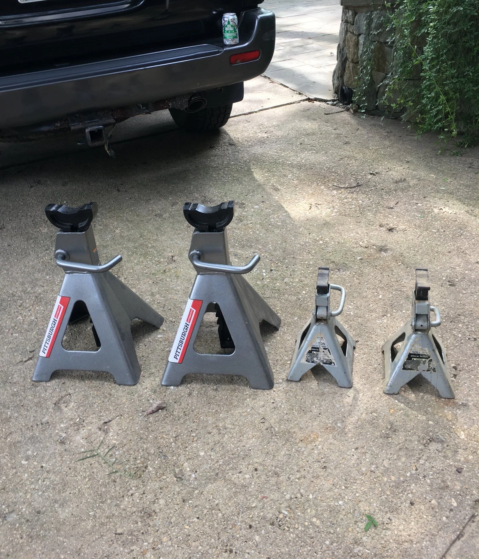

Didn’t actuallly do ‘to’, did ‘for’. Sort of like a birthday present for the wife as it were, though actually it was for me and it’s not my birthday, however she didn’t want me to get smashed under the rig.
Upgraded from 3 to 12 ton floor stands. 👍
[/QUOTE
good buy! people overlook safety sometimes
i had 4 of those smaller ones, once i got the LX i upgraded to 4 of those monsters for safety, and then i also use the jack to hold it and sometimes even the smaller ones...

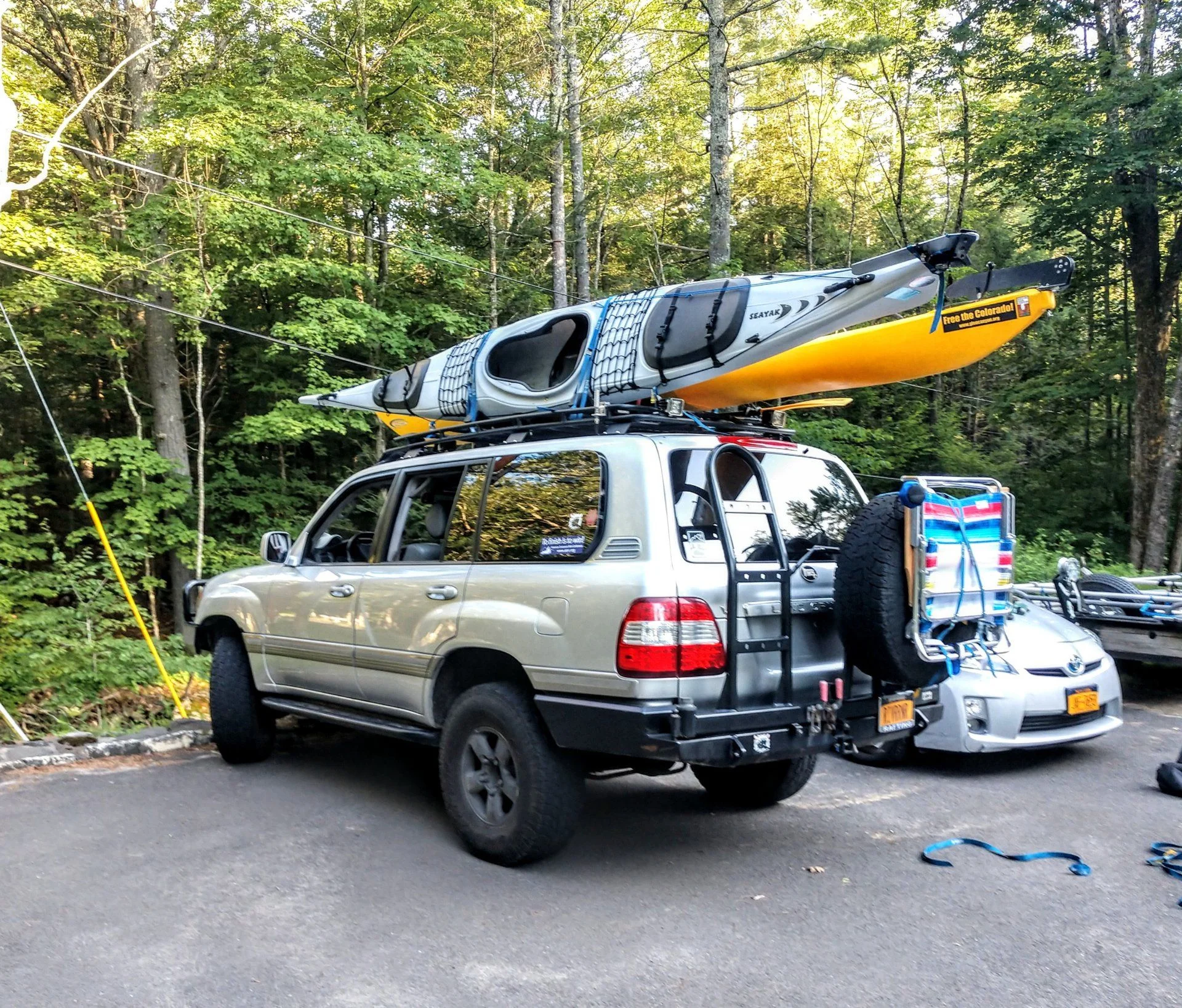

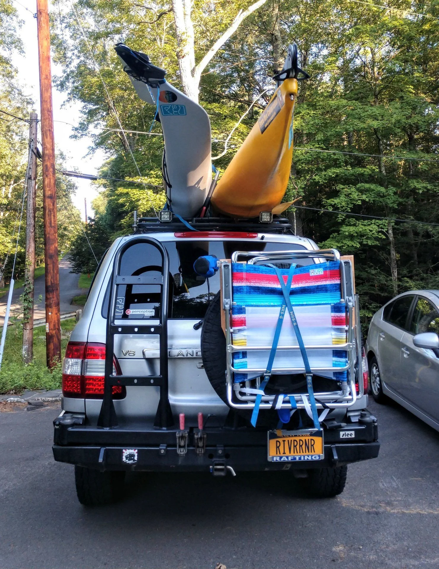

Drove to Lake George, camped out of the kayak for three days with my little one and @kasassy
Then drove to Maine to hang with husband's folks, then today packed for OBX. This time Kassy's kayak is hitchin a ride on the Hundy.

Def will feel safer, picked these up on CL for $40 for the pair. How could I say no? :) Yes I always use a floor jack as a backup. Cheers!

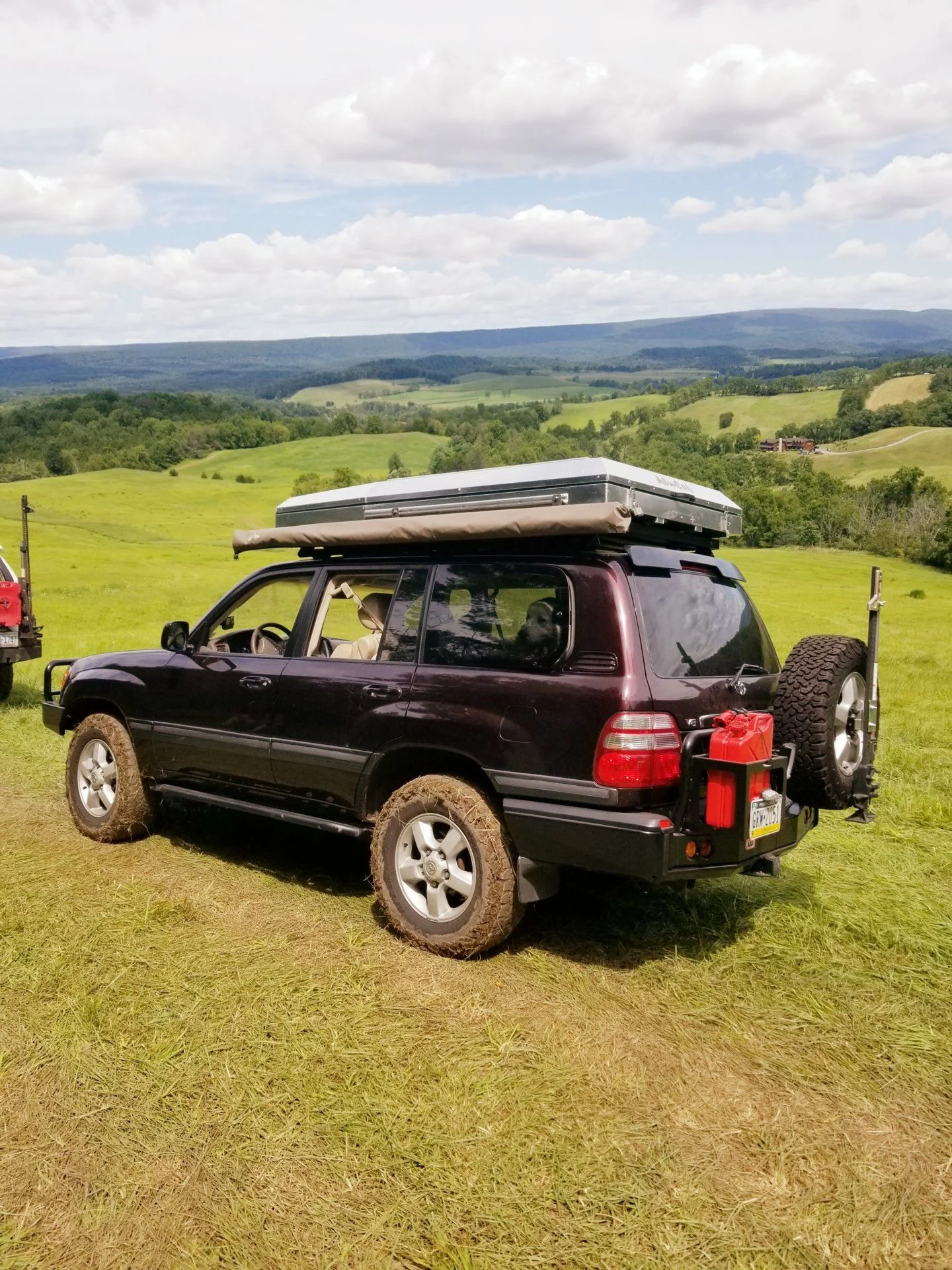

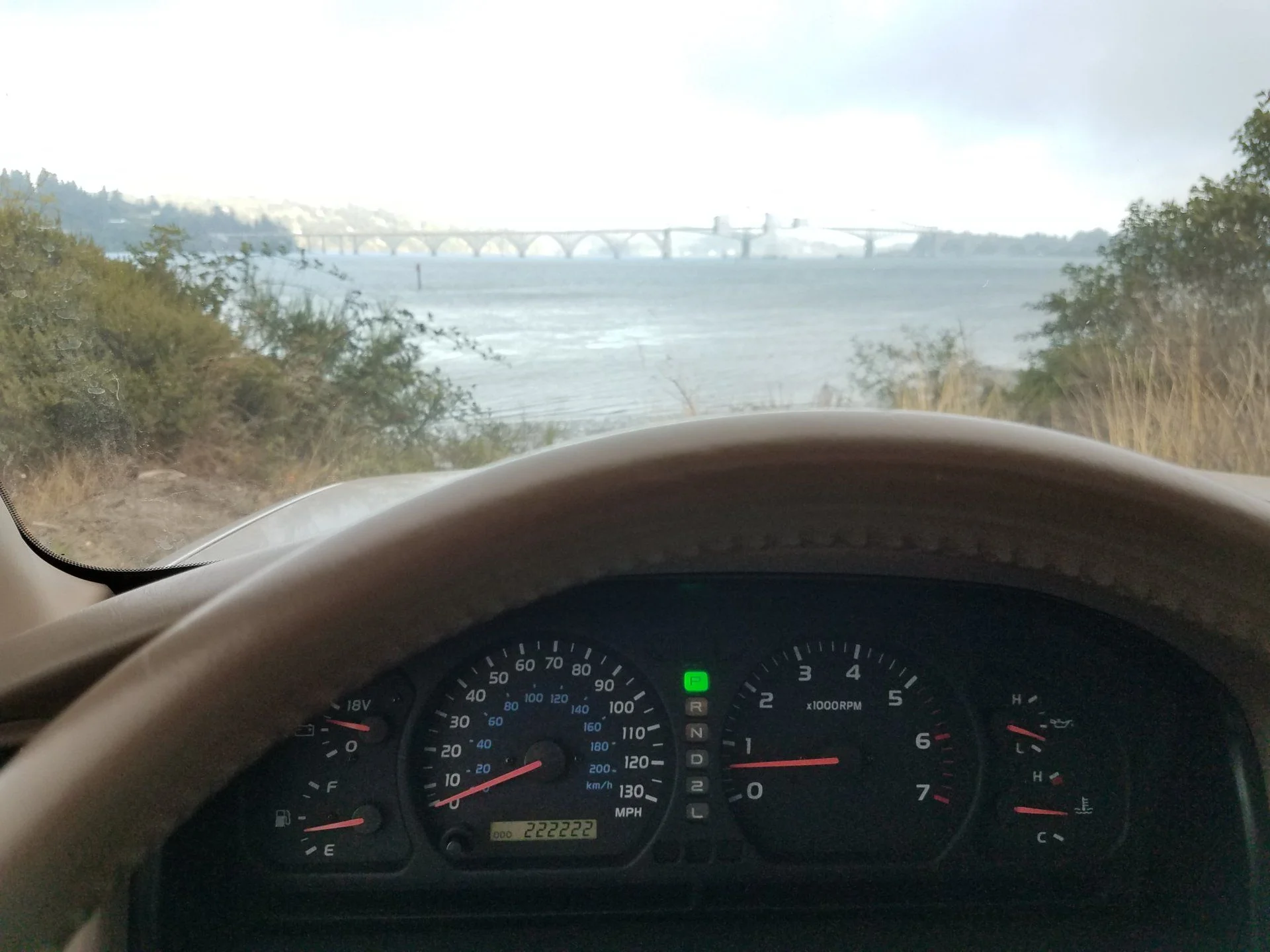

Went for a drive and found a scenic place to celebrate 222,222 miles for the ol' landcruiser.
