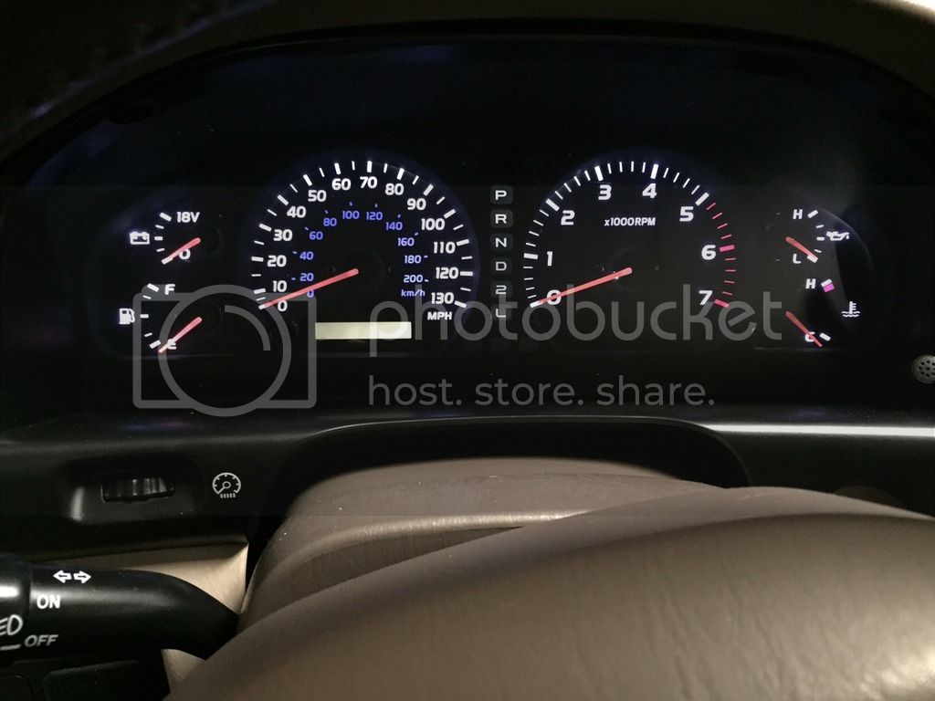

Also did new steering wheel and double din nav unit which helped. Another little thing was swapping the cluster bulbs for LED bulbs. Was pretty easy and really looks much better at night in my opinion.
It looks better than mine, I did the LED conversion a few years ago but there are some spotty areas on some of the gauges.
In the end, I was so annoyed with the removal and installation process and the have to make sure the orientation of the LED bulb contacts was correct that I just left it all in.
Which bulbs did you use? I might give it another try just for the heck of it.
Not sure of brand, they were the brightest ones I could find with I think 5 smd's each, four around the body and one on top so the amount of light was enough to go through the channels and fill everything quite well. The polarity thing is a pain, I eventually just had the cluster leaning forward so I could get my hands in there while it was plugged in and lights on to get them all oriented the right way.
