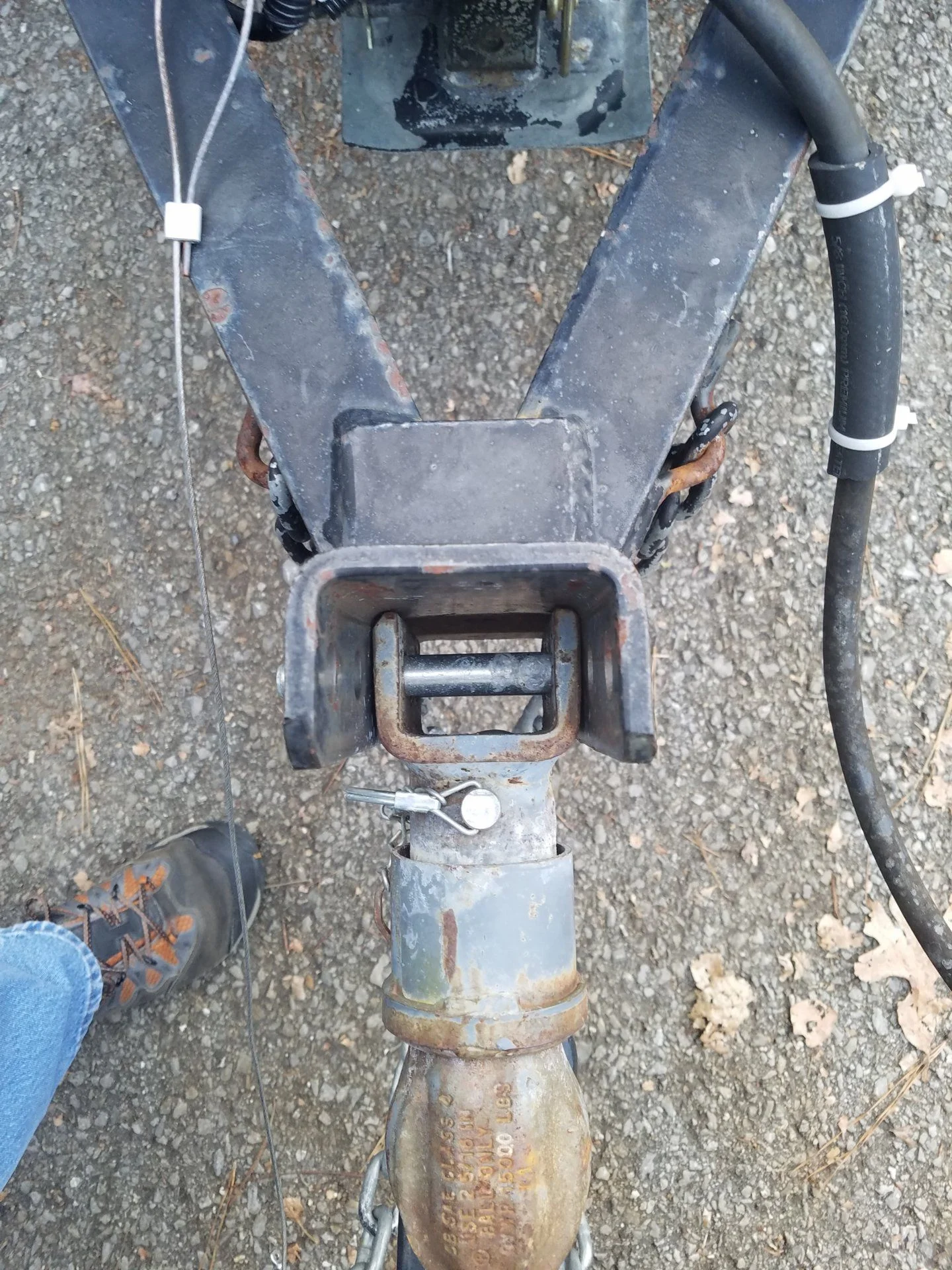

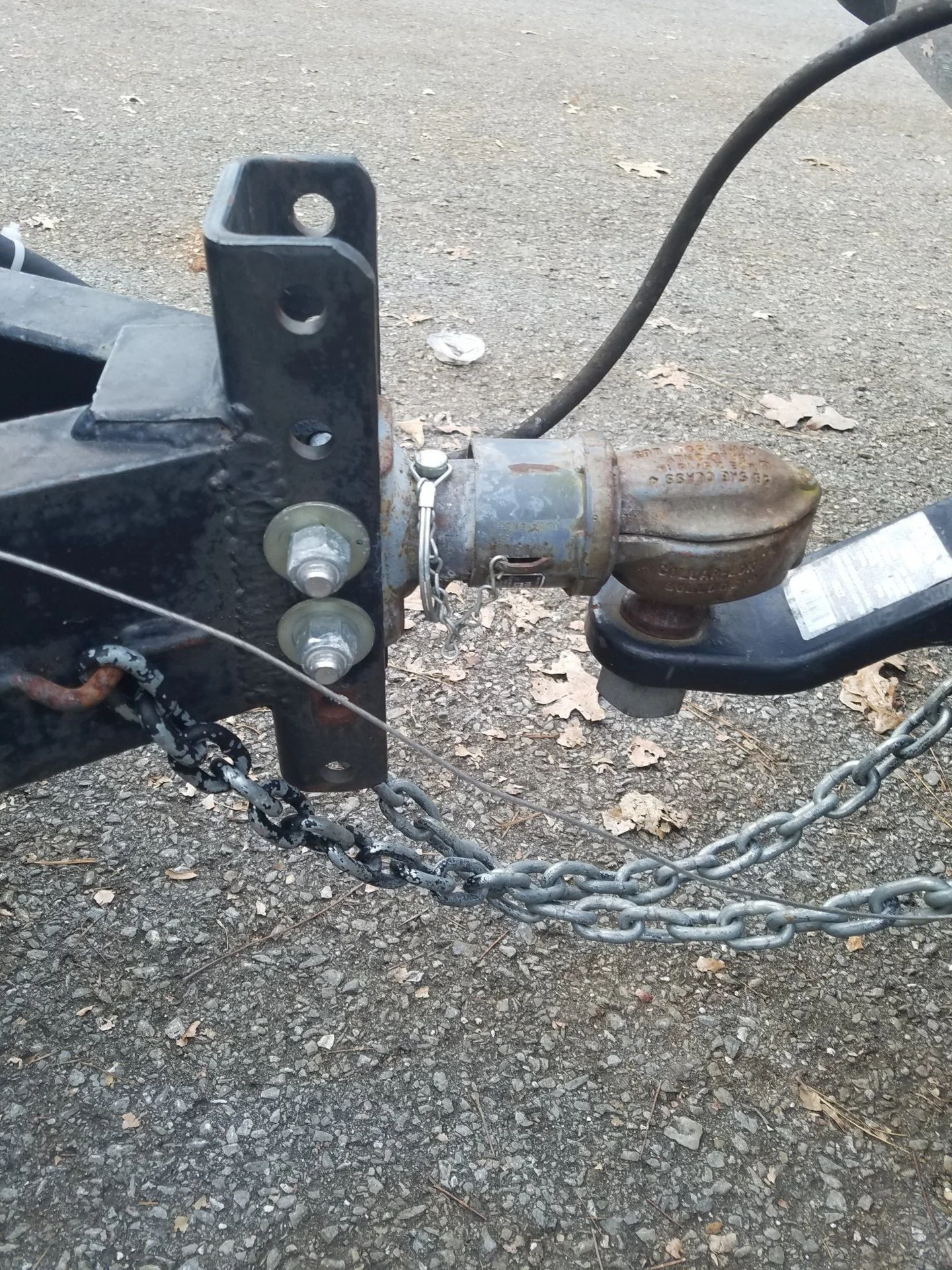

See attached pics. I have a flat metal deck, car-hauler. This trailer has an adjustable tongue. Looks like I need to paint..but I have a the HD bull-dog ball coupler. Anyway.....so the trailer came with what appear to be grade 5 bolts that hold the tongue in the right position. These are two larger bolts with lock nuts (I dont' recall, but I may have put the lock nuts on there) that it came with. I'm wondering if I should replace these bolts with grade 8 bolts. Of course it would be a bad day if one or the other or both of these bolts broke and I don't have any reason to believe they will,but wondered if a large grade 8 bolt of the same size would be the better choice for this application?
