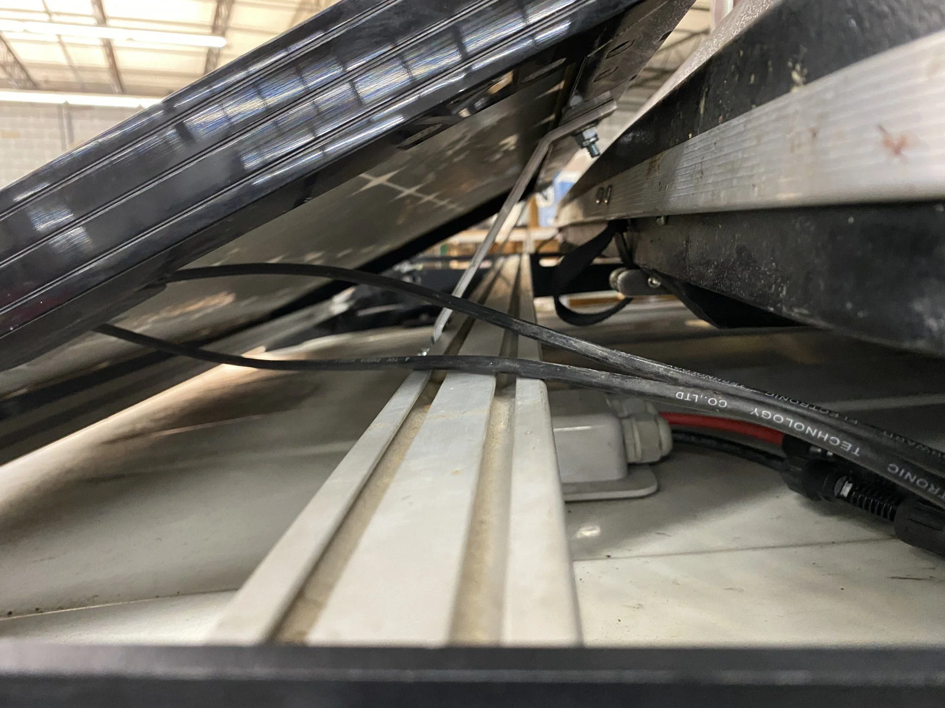

Also fabbed up some brackets for the solar panel

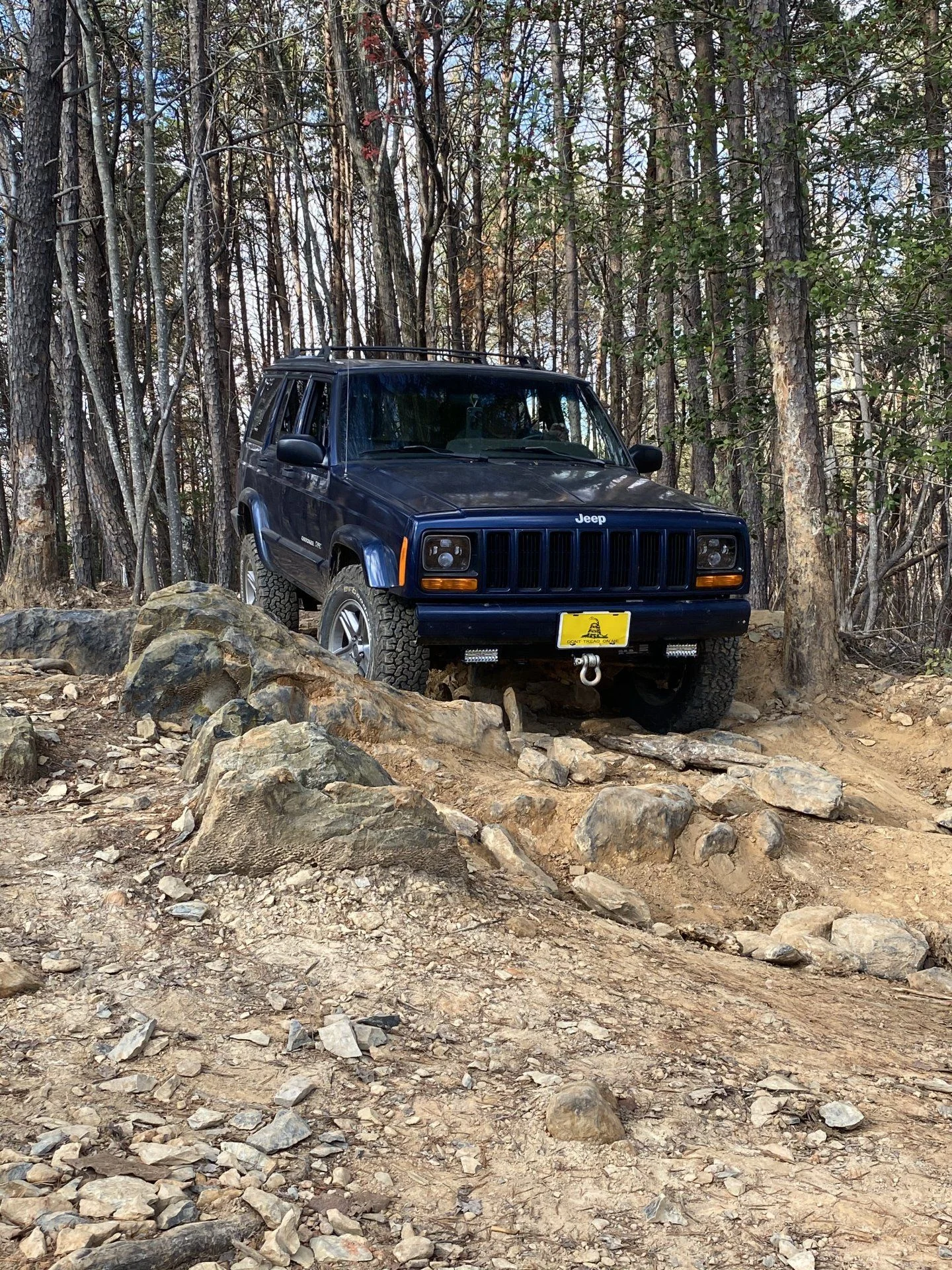

Helped a buddy take his Cherokee from 2WD to 4WD over the past couple of months. Today was the first shakedown at Uwharrie.

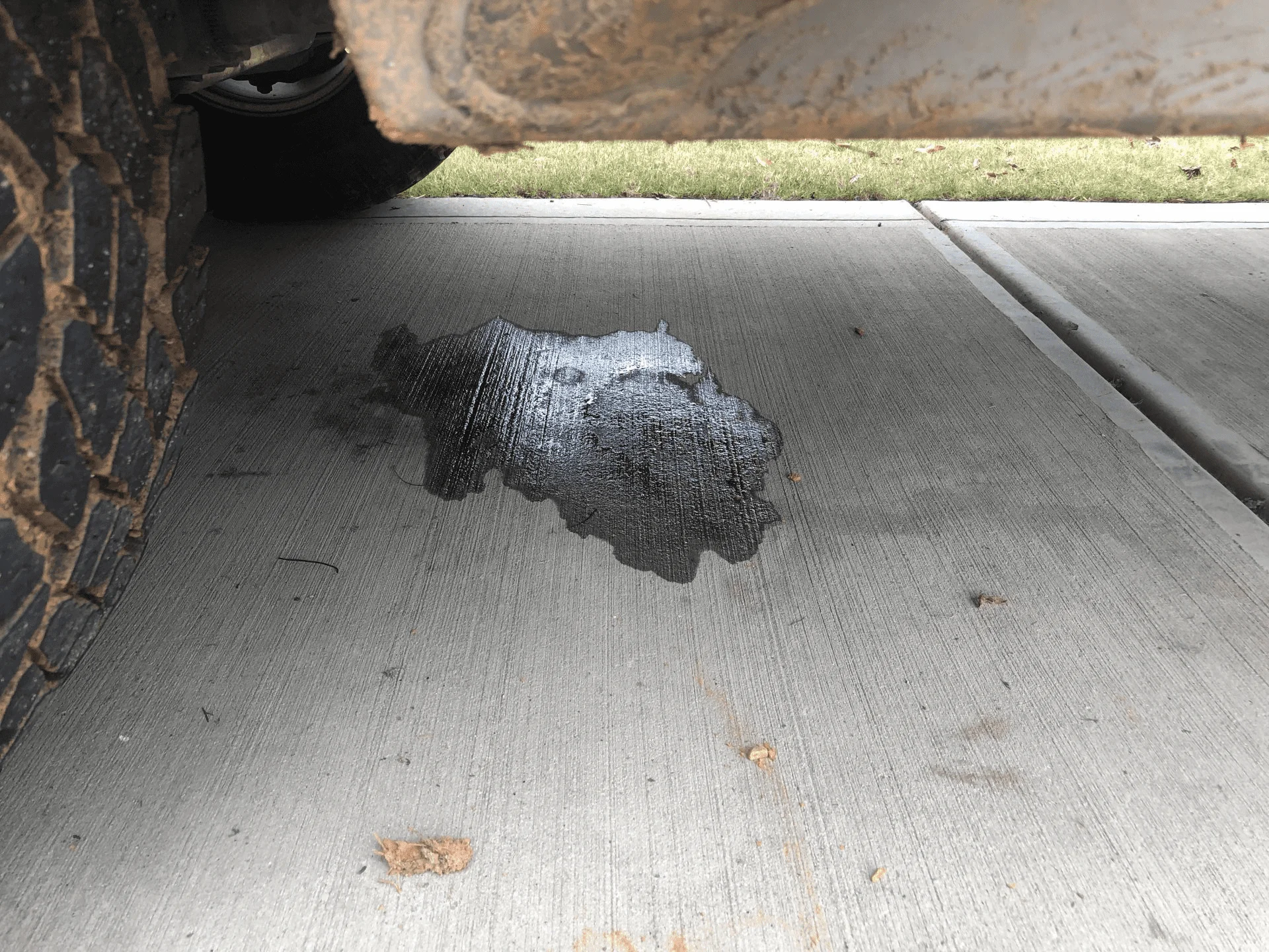

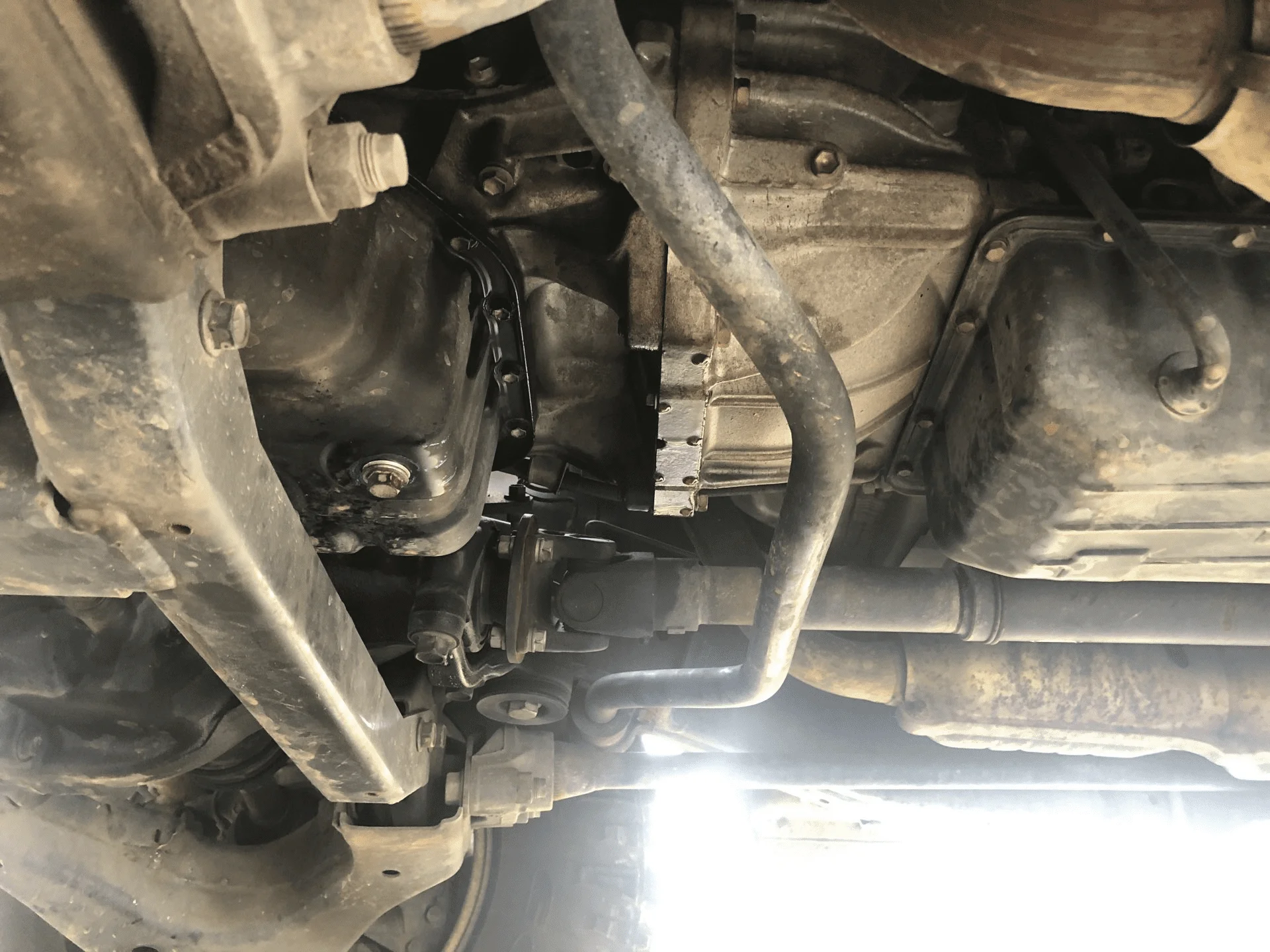

I posted in the 100 forum yesterday about what I thought was a rear main leak. It seemed to be dripping faster than oil so I put a pan underneath and checked it again this morning. It's coolant. How am I leaking coolant right here? What am I missing and/or not checking? Where am I not looking? I can't see anything wet other than right where the engine and trans meet. Why would I have a coolant leak right there?
probably the “heater T’s” near the firewall. They’re plastic and deteriorate over time. If they’re leaking, they’ll crumble when you try to change them.
I replaced the Ts a few weeks ago. I think my problem may be that I didn’t replace the hoses and clamps At the same time. I just put new Ts in the old. They’re probably not sealing. I’ll look more closely. I would much rather put on a couple new hoses than what I was thinking originally.
my guess would be the clamps

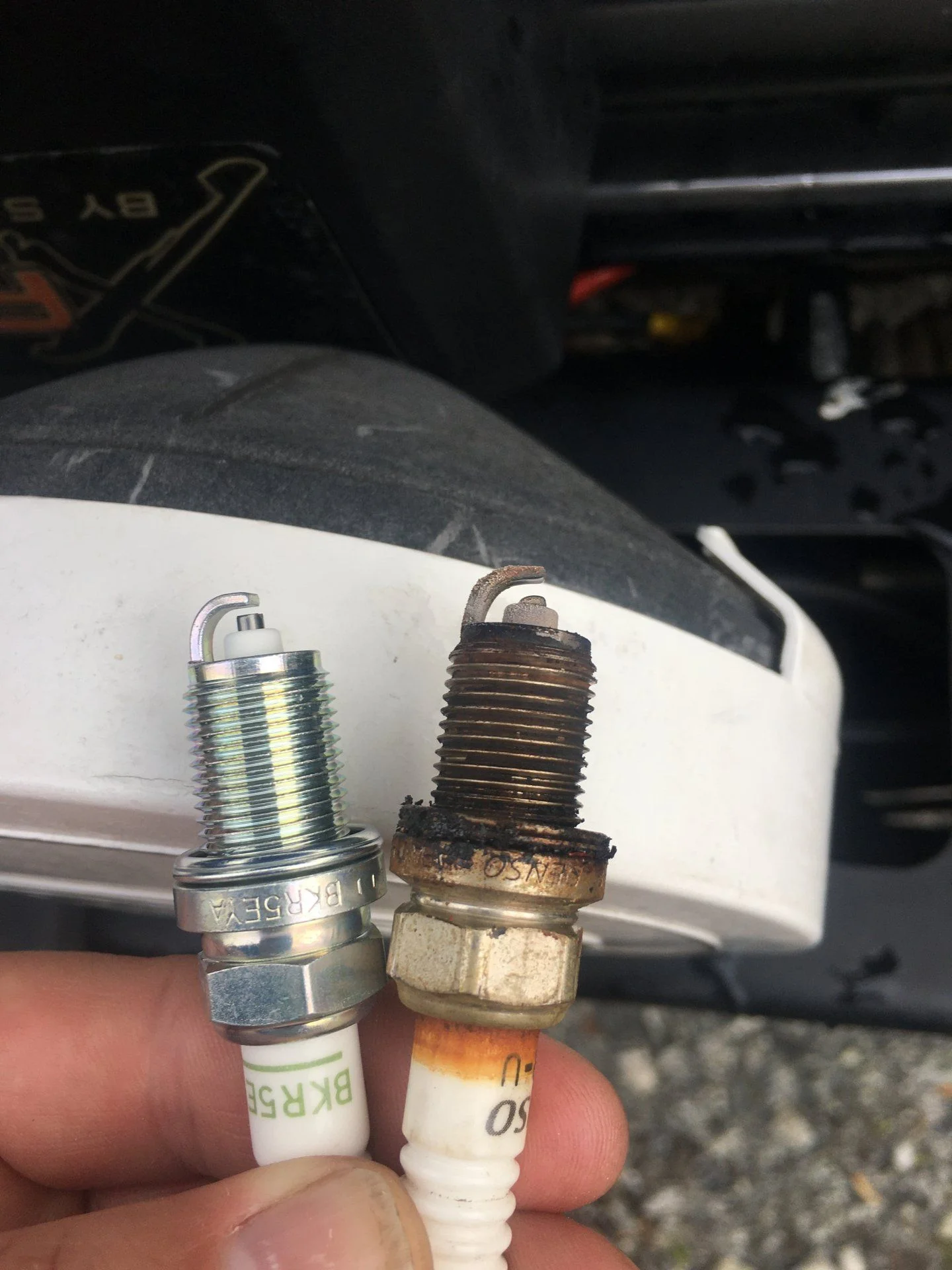

Replaced spark plugs. These been in there a while. Truck was still running just fine.

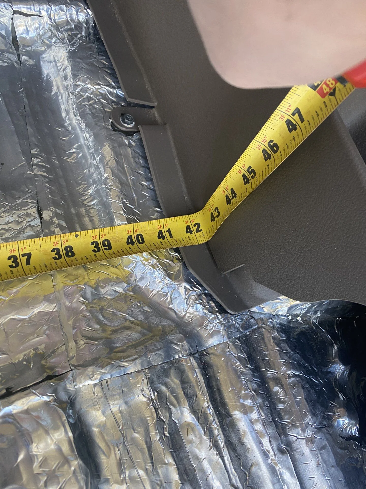

You could use a shovel to measure that gap.

it being my first time, I was a little afraid I would mess it up so I just went with an Autozone valve in case I buggered it up.
I figure get the hang of it then put in the OEM one day I have some spare time. I’ll keep the autozone around for a backup. Put on some new gates yellow stripe 5/8” hose from NAPA too.
Radiator is new. PO or PPO put it in. Looks good.
I dumped the coolant today. Filled with distilled water and flushing a couple more times this evening. Will do final radiator dump, attempt the PHH, change thermostat and some gaskets, and fill with the Yoter Red. Cooling system should be good for a while.
