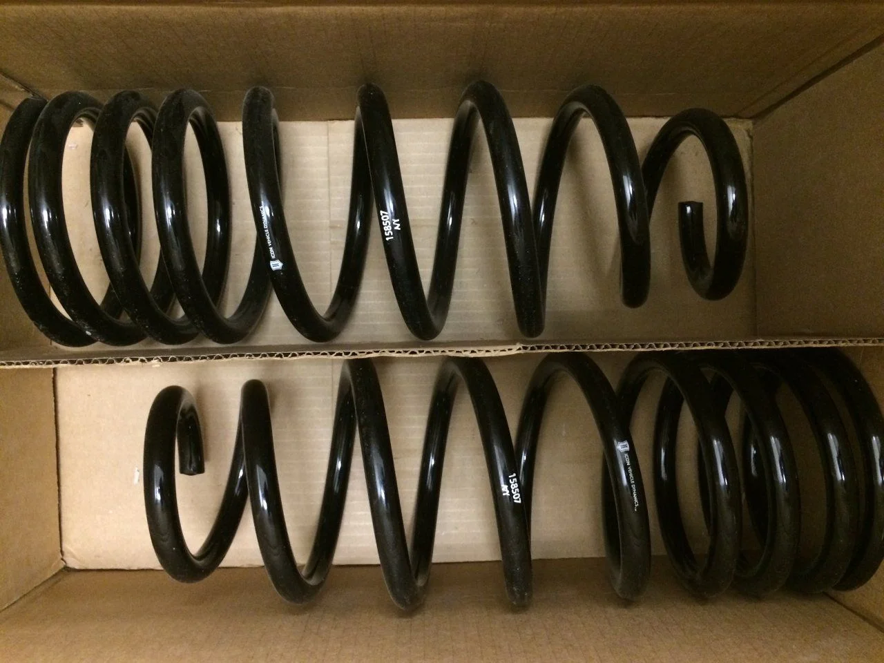

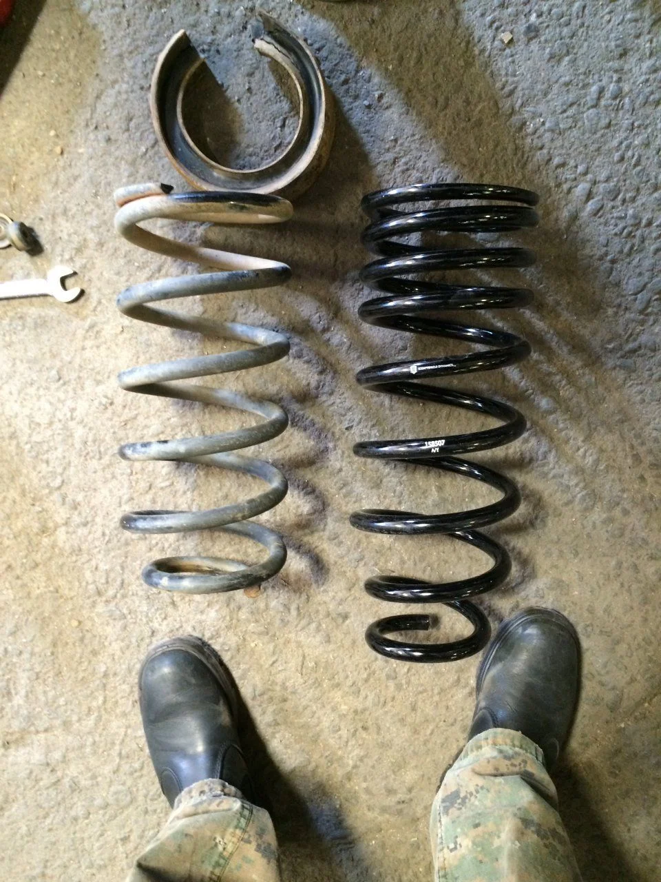

@BMThiker those the ones you were talking about a couple months ago that round out your flexy rear setup?
@jynx Well, sorta...I called LT and asked him if I should get the Metal Tech medium or heavy dual rate springs and he recommended the ICON overland series since I carry most all of my tools/spares in the cargo area and have the steel fenders/bumper plus trailering the m416. These were just a little more than the custom Eibach/MT springs. I'll know how they ride this weekend.
Also, I don't technically have the long travel rear shocks - although they are longer than the OME & OEM by at least an inch about 2 inches. Mine were an earlier gen (2.0) and the long travel Icons are now labeled VS.
I'm going to take measurements before and after to see where everything winds up. I'm guessing I'll end up with a little more rake, but I can level it out by adjusting the front coilovers.
So, the install went smooth. Took me just over an hour and I only needed assistance once: to get the 2nd spring in place I needed ballast wearing a size 13 boot to step on the hub so I could squeeze the spring into place. :) Thanks @71-CRUISER
I had forgotten that I put 1" spacers on top of the OMEs once I got my trailer. It helped get the tongue and hitch lined up better at the time.
Measured each wheel before:
Driver side - 17" - top of rim to top of fender
Pass side - 17.25 - top of rim to top of fender
Can you say "Cruiser lean"?
With new springs - ICON Vechicle Dynamics Overland 3" dual rate springs
Driver side - 17.5" - top of rim to top of fender
Pass side - 17.75" - top of rim to top of fender
Net gain of precisely 1/2" on both sides, which is about what I was hoping for - nothing drastic and I won't have to readjust the front coilovers. There is just the slightest amount of rake, but it will hopefully ride flat when I'm loaded for bear and hauling the trailer.

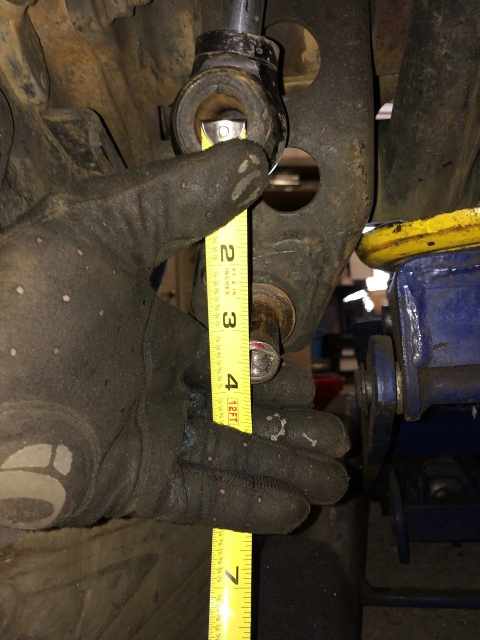

While I had it on jack stands I let the axle drop completely under its own weight. . . and measured the shock eyelet to shock mount distance. I don't think the ICON VS shocks have that much more length, but I was curious to see the difference anyway. These shocks are about 2" longer in travel than the stock Toyota shocks.
