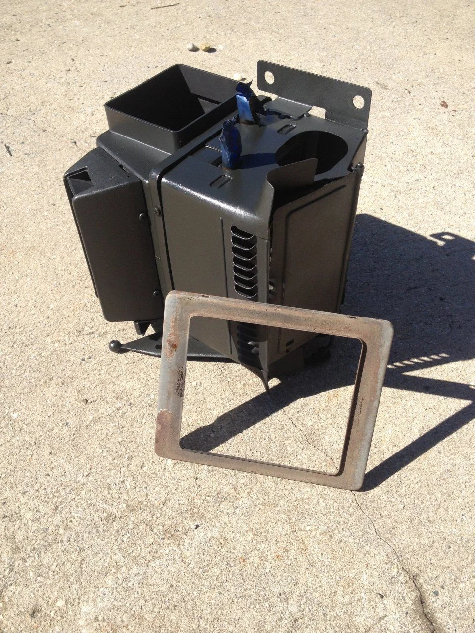

Fixing some leaky heater core blues and attacking the vsv's trying to rid a 401 and stalling issue
Yeah. Still unsure of actual problem but with a persistent 401 now I am more attacking it at the moment.

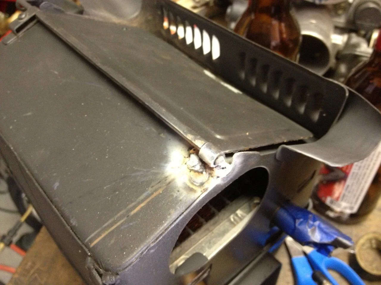

And the best part wasnt just fixing it. But making it better too.
Defrost flapper has never fully shut to force warm air up to windshield. While apart I noticed a PO had previously "fixed" it by re welding one side of the pivot to the housing. However it was not square so the flapper would bind and not shut. So out came the air chisel and welder and it works perfect now.

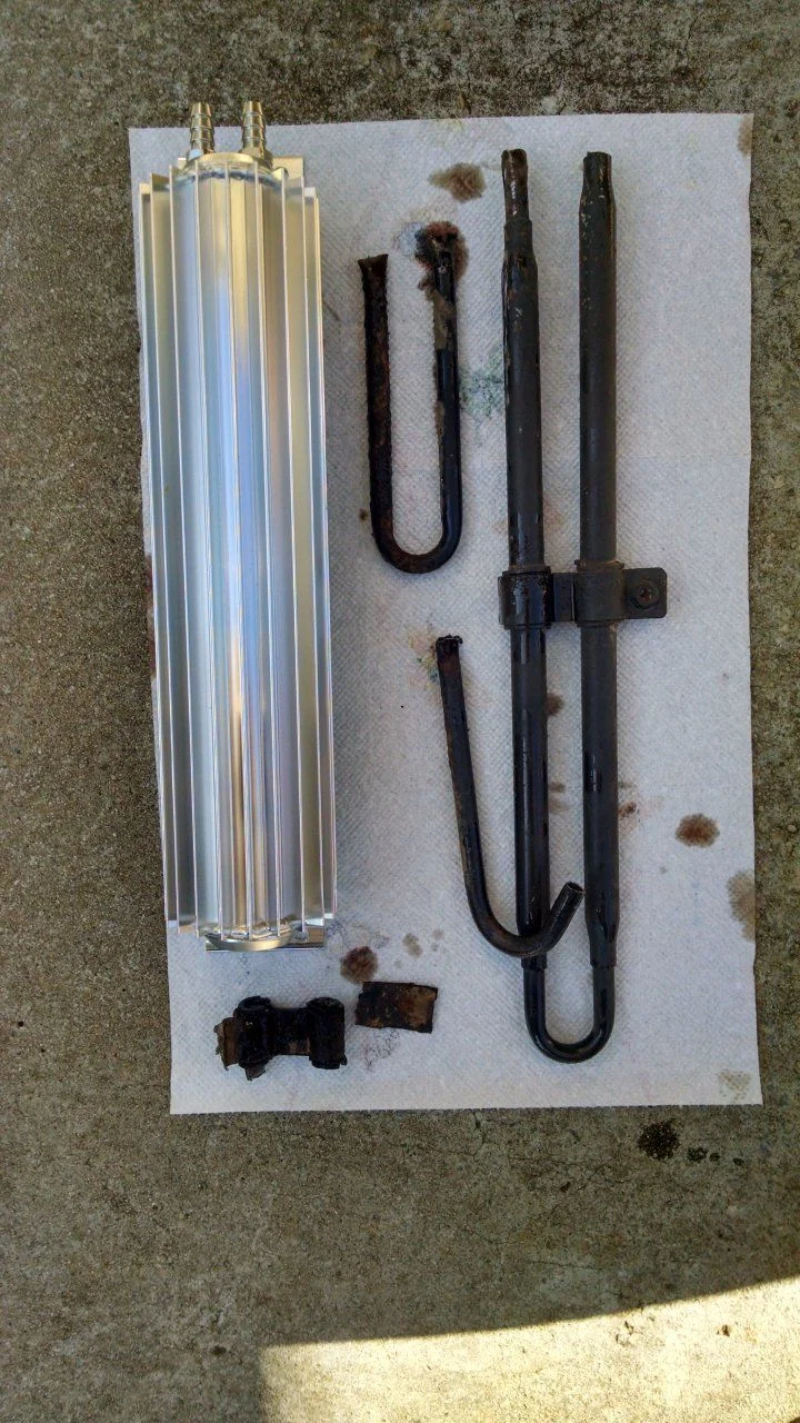

Removed old busted power steering cooler (18 years of rust made it way more difficult than it should have been). Then installed new mo' betta power steering cooler and new low pressure lines. My high pressure lines are already fairly new. I had to cut the old system out in pieces.

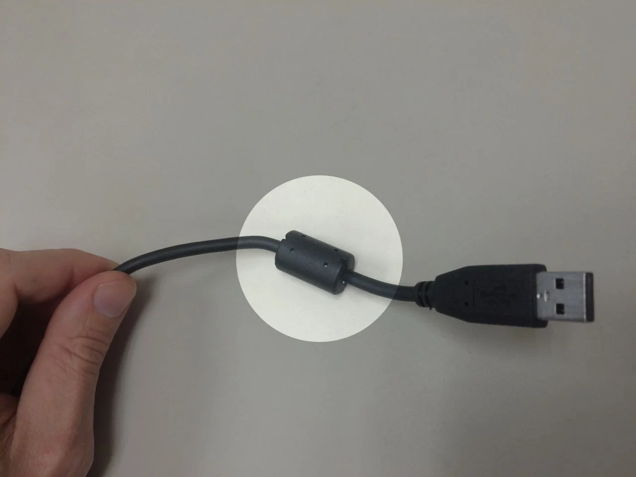

However now when I turn on my new lights my radio goes all to static :bang:
The manufacturer is a Chinese knock off company and there is zero chance of return. :doh:
So I did some research and found that there is a chance that if I install a Ferrite Core Shield on my wires that it will hopefully knock out that radio interference. http://www.amazon.com/Fair-Rite-043...1_fkmr0_1?ie=UTF8&qid=1383339952&sr=8-1-fkmr0

I got a set of Lifetime headlights from Steve and I am mixed. They are very nice and with some trimming was able to use them with the factory rubber. They are noticeably brighter on ow beam but not too impressive on high. Reason is the low beam diode only fires into half the housing. To get high it fires a second diode in the opposite direction. My guess is in order to stay legal they have to use a much lower powered high beam diode, so the light output in high is only marginal better, if not possibly worse, then stock. The high beam doesn't really have the throw that I remember with the halogen bulbs. The radio thing isn't just the knock-offs, maybe worse but not isolated. With my lights on I get strong local stations without interference but weak stations or anything from the next town over you can forget. They sent me some little boxes to plug in line and said to make sure there was no metal contact with the ballast and the body. Grounding seems to be a major problem with them. This I haven't sorted completely and I may be able to eliminate this with more investigation.
