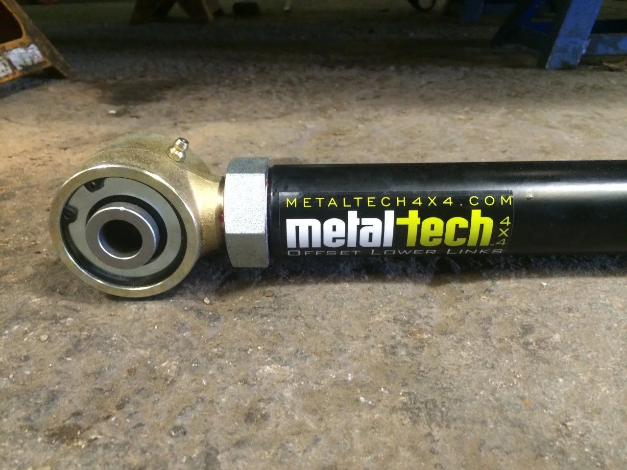

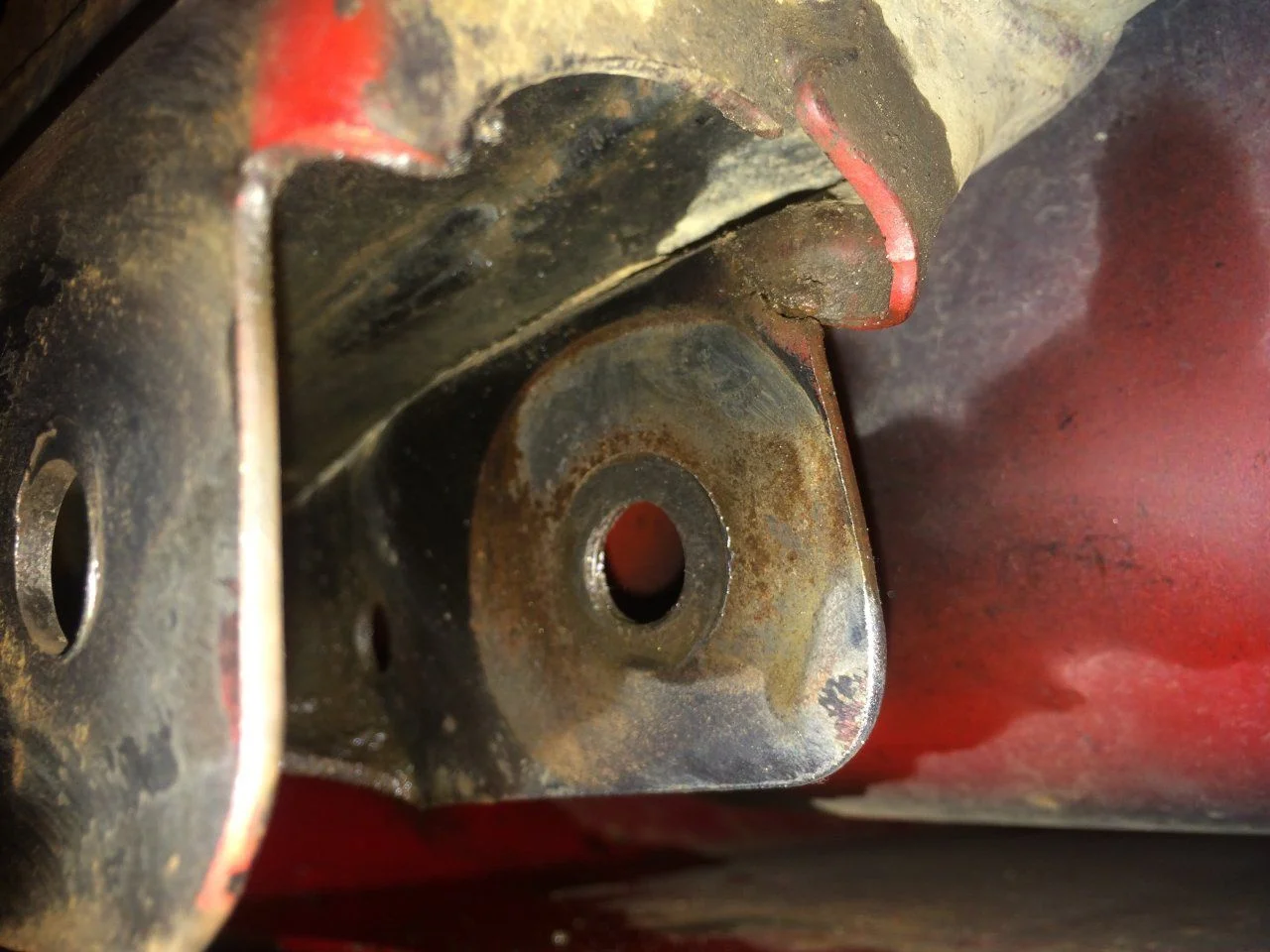

Installed new Metal-Tech lower control arms on the rear axle. The poly bushings in the old arms were so worn out they literally fell out when I unbolted them. That would explain some of the clunky-ness I had. Also discovered cracks in the frame mounts that need patching up.
New beef

Cracked up

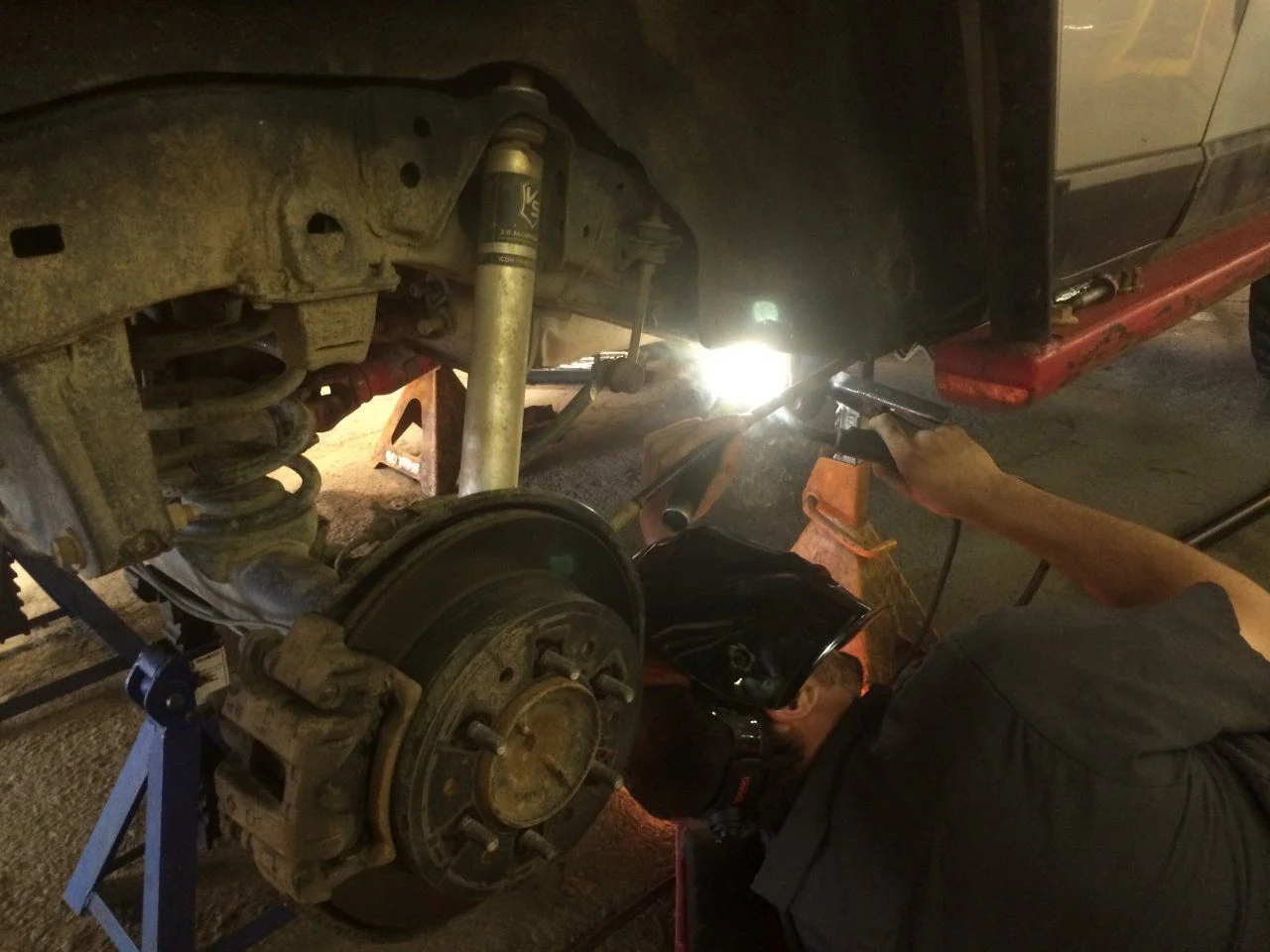

weldering...
weldered up
BF wrench to lock the jam nut

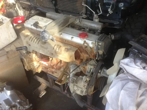

Why do you have to pull the whole motor to install a turbo. Or is 3b going bye bye as a whole.
3B is going bye bye..... that second engine pictured is the Toyota 1HZ diesel engine. It is Toyota's work horse diesel been in production for 24 years now :beer:
