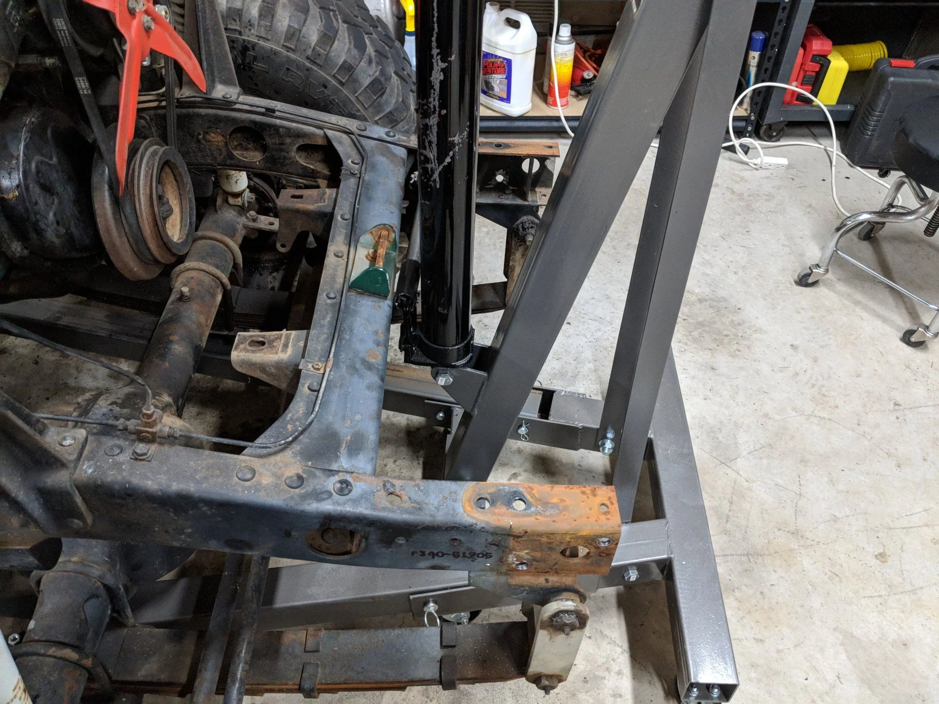

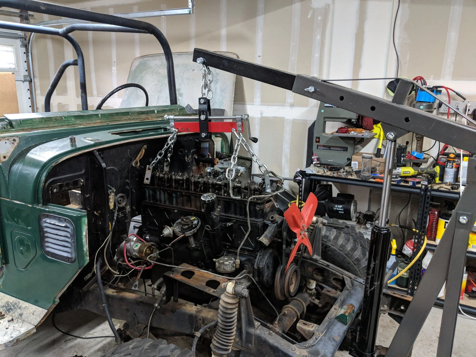

I got the Harbor Freight crane over the engine.
full
But it will be ugly when I start tugging on the crane. The hydraulic tube is will be rubbing on the frame. This happened when I pulled the 2F off the 78 frame too.
full
I am trying to decide if I should pull the entire drive train out in one fell swoop, or slit the transmission from the engine. I'll mess with it tomorrow, it is hotter than satans butthole in my garage today! :devil:

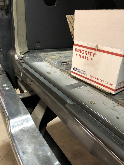

For me it has been lots of welding over the last few days with a carb swap in there.
Carb was on loan from another member as I was in the process of rebuilding mine due to some issues from first rebuild. Finally got time and garage space while the wife was out of town to make it happen!!!

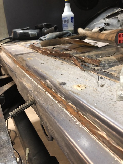

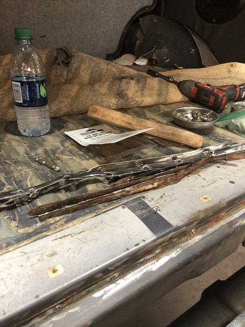

Lower lip that was completely rusted out removed (note, HF spot weld drillbit works, but takes FOREVER!!)
Untitled by Greg Fisicaro, on Flickr
New lip welded on..
Painted, seam sealer and new parameter bulb gasket installed.

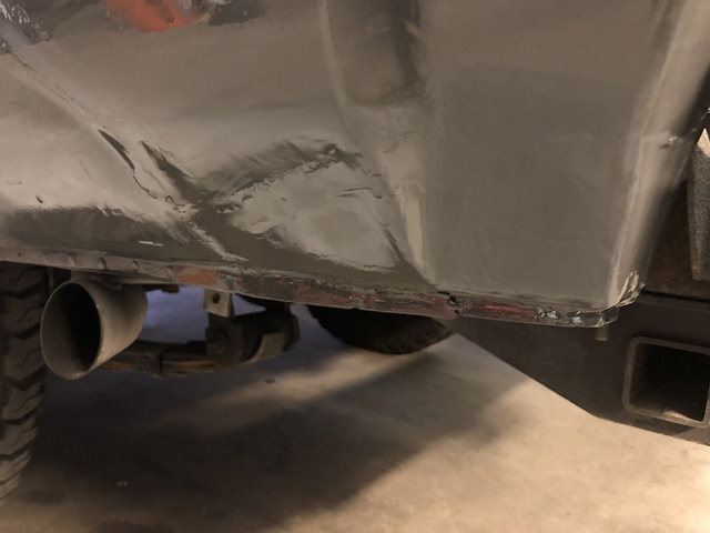

Then I saw a little bit of rust showing (paint bubbling) behind the bumper endcap on the drivers side. Figured I would just take care of the small half-dollar/quarter-ish sided area. Yeah.... well you can see how that turned out. (no pics from the actual rust stage)
Not too bad for only a couple pieces of steel. Unfortunately (or fortunately) I ran out of welding gas as I was laying my few tac welds down. Will have a couple spots to go and tie up once I get ready to paint (small pin holes) but everything was treated with Prep-Etch (Ospho) and then immediately primed and painted after that had sat for 15 minutes.

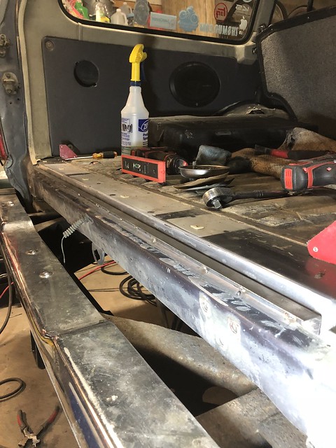

New lip welded on..

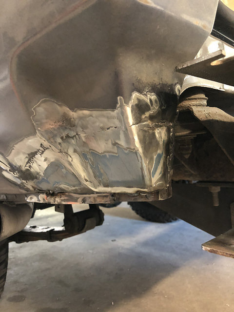

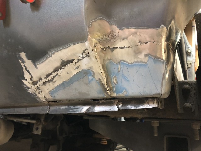

next time try this on spot welds....use a 1/8 bit really sharp and be careful, once you get thru the first piece go to a little larger bit and then you can use a panel splitter on it, Have tried several spot weld bits the problem is the metal hardens in the weld area and they dull quickly.. 1/8 bits are easy to sharpen and if you are careful dont leave a hole in the base metal...
Hopefully I wont be doing anymore spot weld drilling anytime soon. And really the cheapo HF spotweld bit did its job at $8 bucks so I am good.
