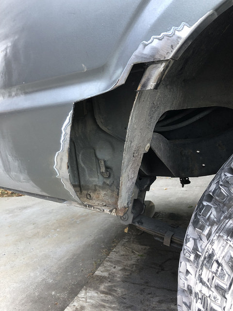

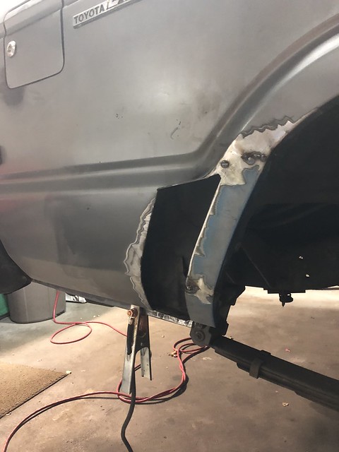

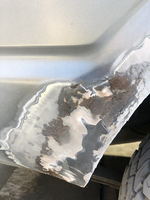

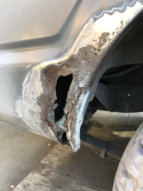

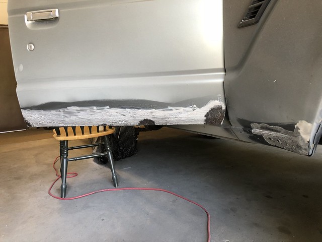

Last week or so has been lots of this....

Hoping to finish that up tonight/this weekend so I can prime everything that needs it. Paint in the next couple of weeks. May end up having to take an extra day or so off work so I can do the paint. Dipping down into the 50s at night which scares me for proper cure times.
Shoot some rust converter and a good primer inside while you are there, summit has some in quarts that works well and you can paint right over it..
The rust converter that is...
Yup I plan to... Already painted with a good layer of Prep N Etch to help convert the rust. Gonna throw another coat on then will paint before I figure out the puzzle piece.
From what you started with that is turning into a real nice 60...
Thanks Ray. She has definitely been a work in progress. Now if the damn weather will cooperate and I can get the bumpers off without busting too many knuckles she will be painted here shortly.
Pb blaster And a map gas torch works well on rusted stuff, just soak it a couple days in advance...
yeah they have been soaked for weeks in PB Blaster to no avail. Just going to take a small cut off wheel to the bolts and get them off. CCOT sells replacement bolts, so once I get the bumpers off I will have those coming.

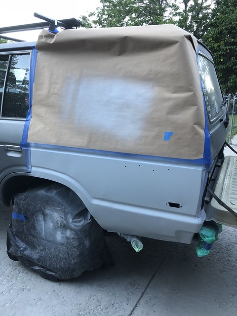

Got some HVLP primer practice last night.
