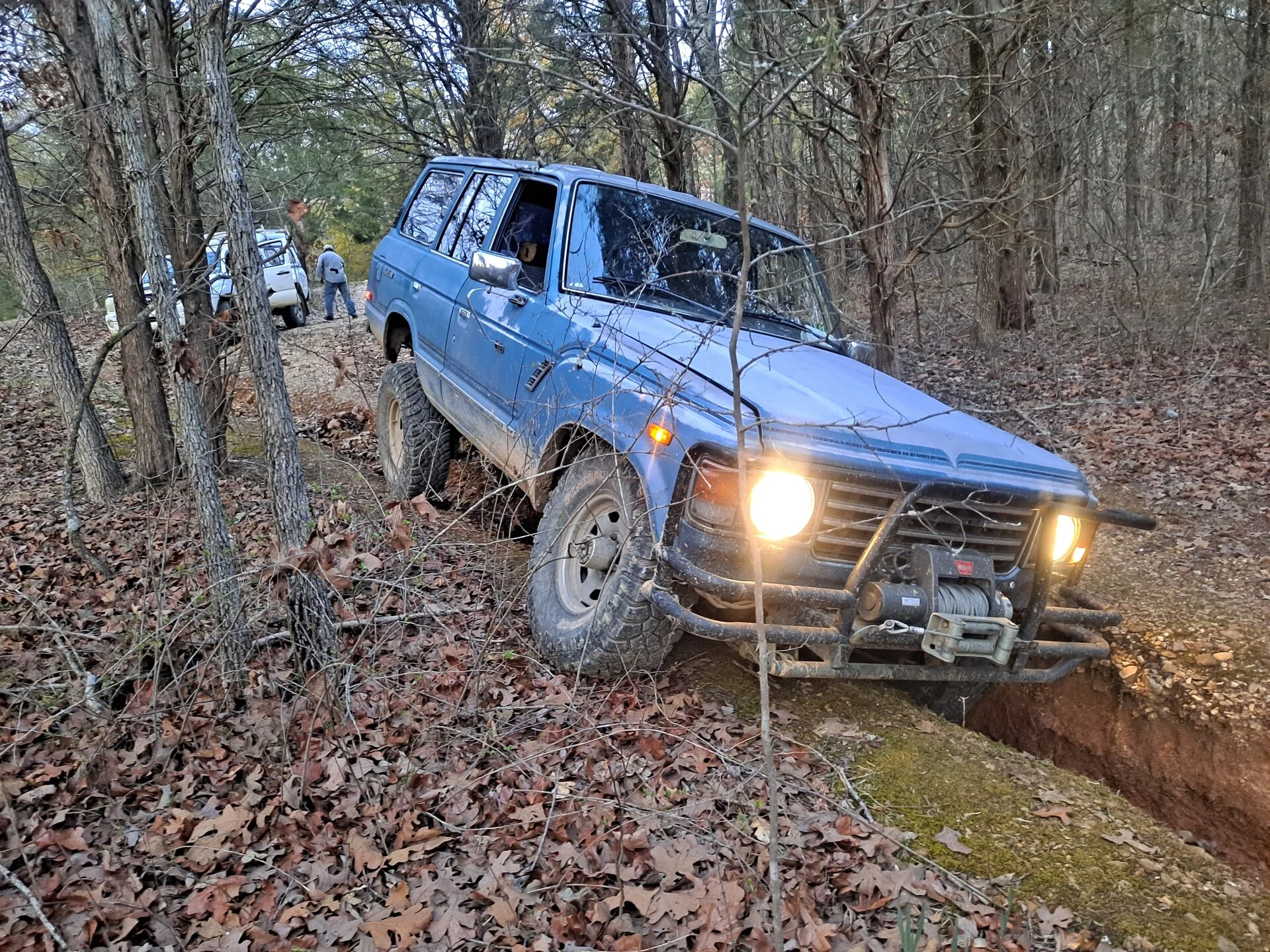

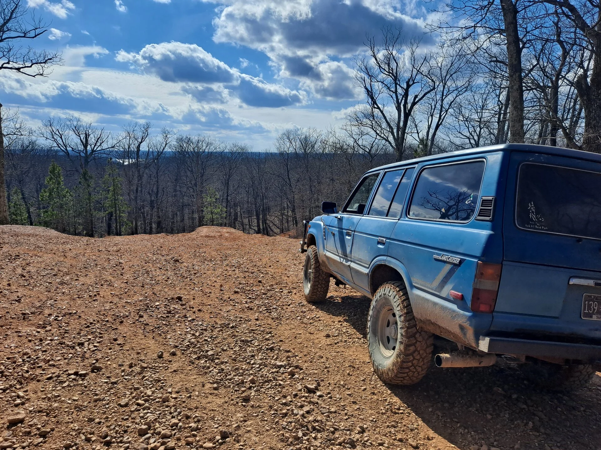

Wheeled it😎
Land Between The Lakes near Dover,TN.
I'm new to TN and keep hearing about Land Between the Lakes. I'm gonna have to check it out. Thanks for posting this.

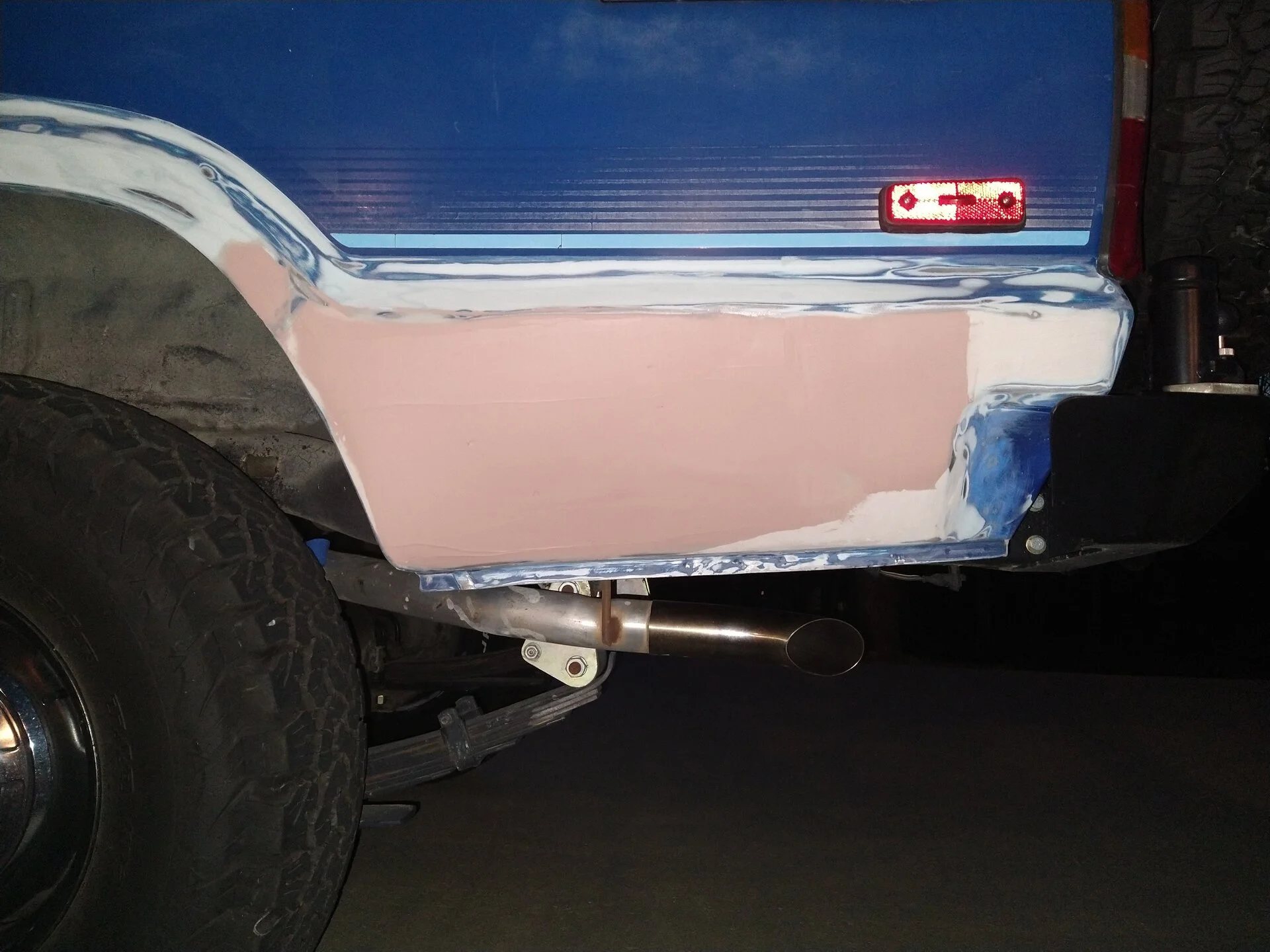

This week I spend time working on the body of my 60 which was long overdue since the last time I did anything to it was 2009. My paint is shot along with minor damage from wheeling, a few on road fender benders and some minimal rust at the rockers and fenders. The patina has left at least 3 different shades of blue so I thought finding a match was going to be impossible. Turns out Lowe's carried a Krylon Fusion paint that matches my faded blue and in a matt finish which was perfect. Wire wheels, Naval Jelly, Bondo and paint and she's looking good again (well, if you like patina). I had painted the front end in a blue that didn't match at all after getting rid of some rust almost 2 years ago and my wife hated it. Now that is gone as well. I do love the patina and even did a little faux failed clear coat on the newly painted areas to try and make it match. I even found the dealer installed body trim bumpers online to replace 2 that were missing. One more crushed passenger door to fix and the body is done.

Sweet looking truck! Nice work.

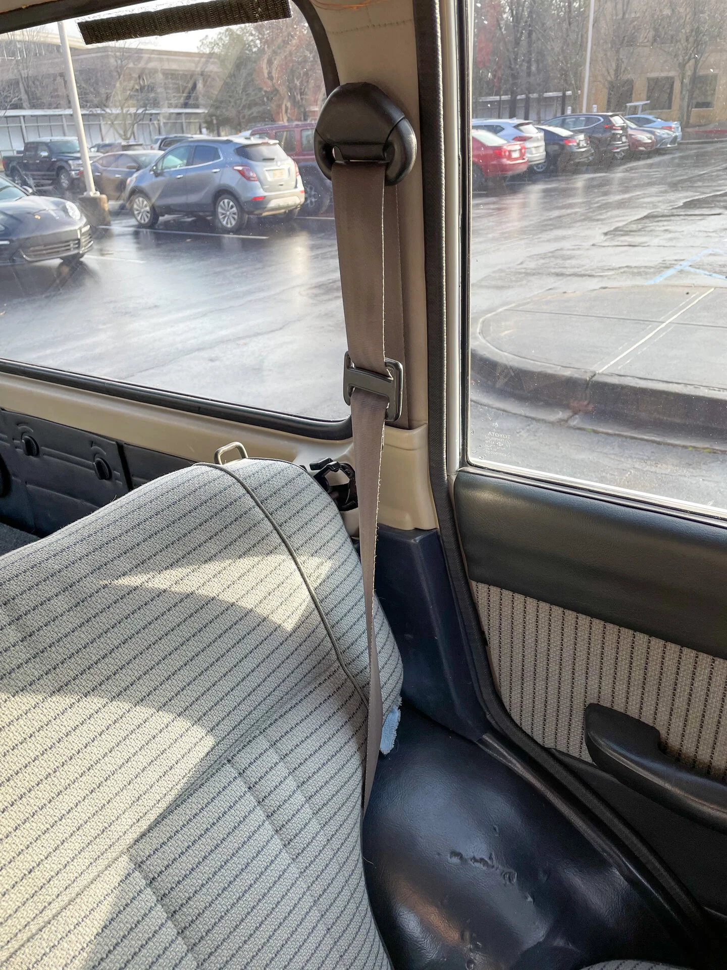

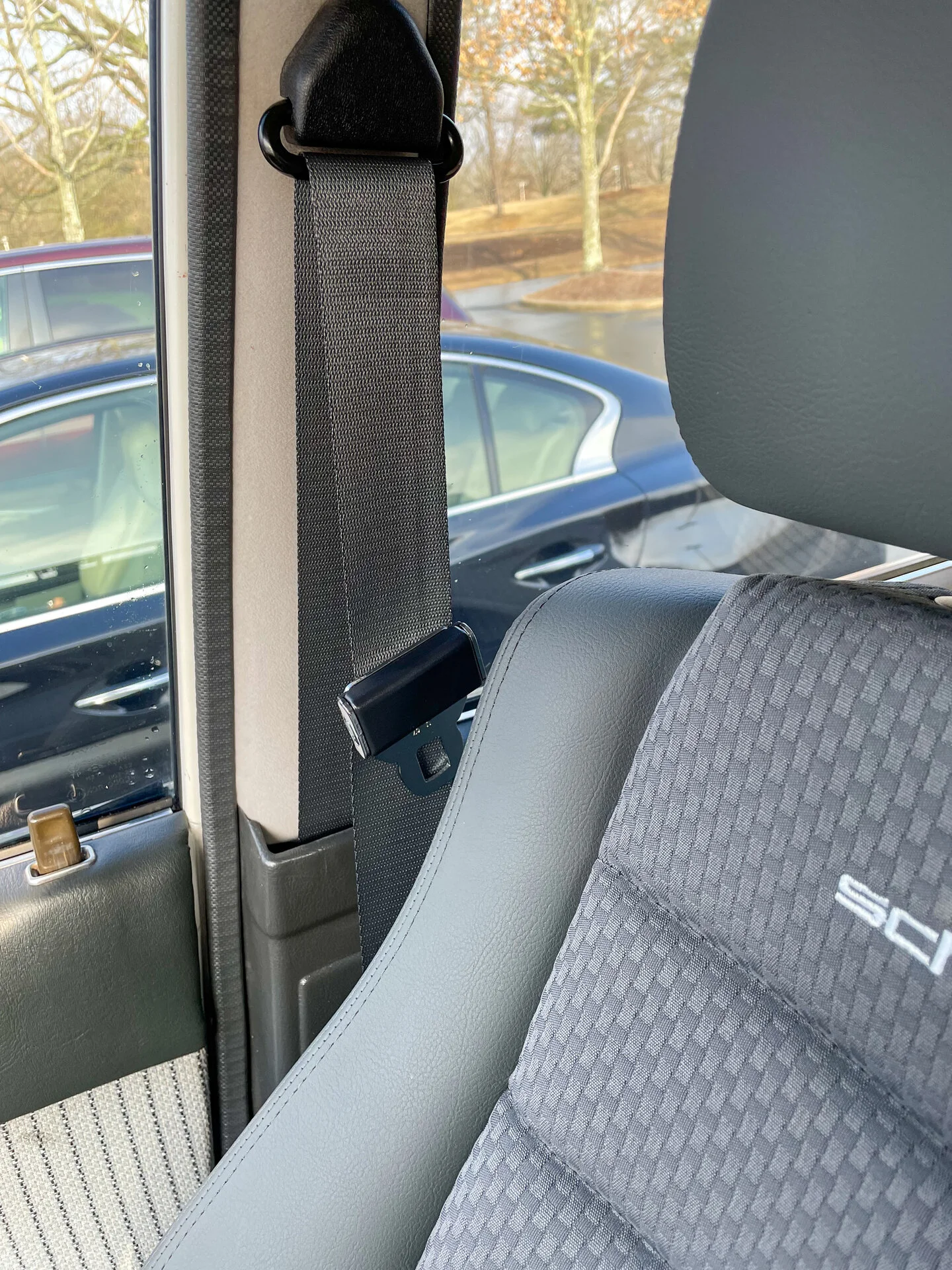

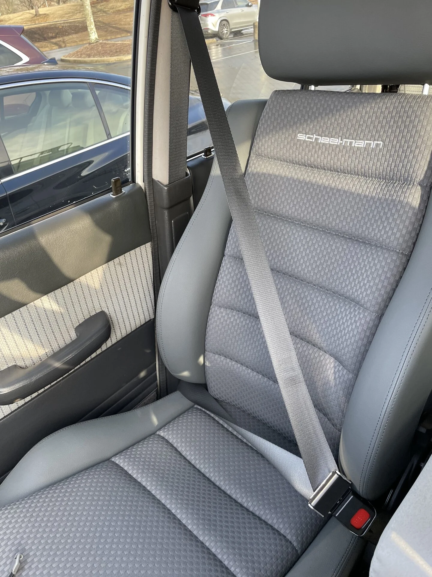

If you are replacing your seatbelts, the “charcoal” colored seatbelts look better than the regular grey belts from seatbelt planet. The grey is more of a match to the metal lighter grey in the dash.
Here are 2 pics of them in the truck and a pic of fj62 stock rear seatbelts in my 60 for reference.
The seatbelt quality is super nice. Definitely worth it. I will say though, before you order, call and make sure they use Grey accent plastics on your seatbelts. For some reason they use black plastic bits on the charcoal seatbelts. If you ask them before they build your seatbelts to use the grey accents, they will do it. I learned this the hard way

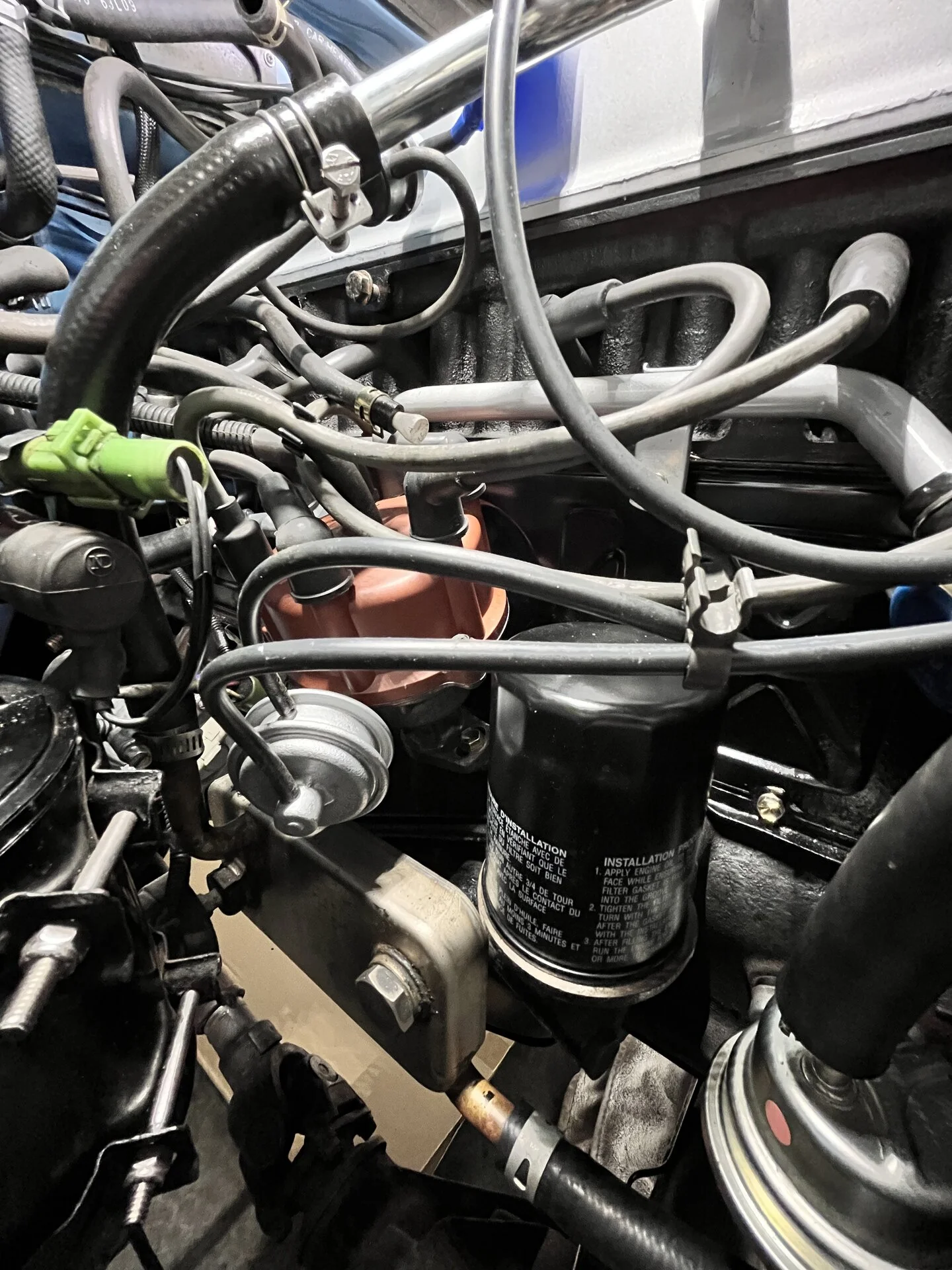

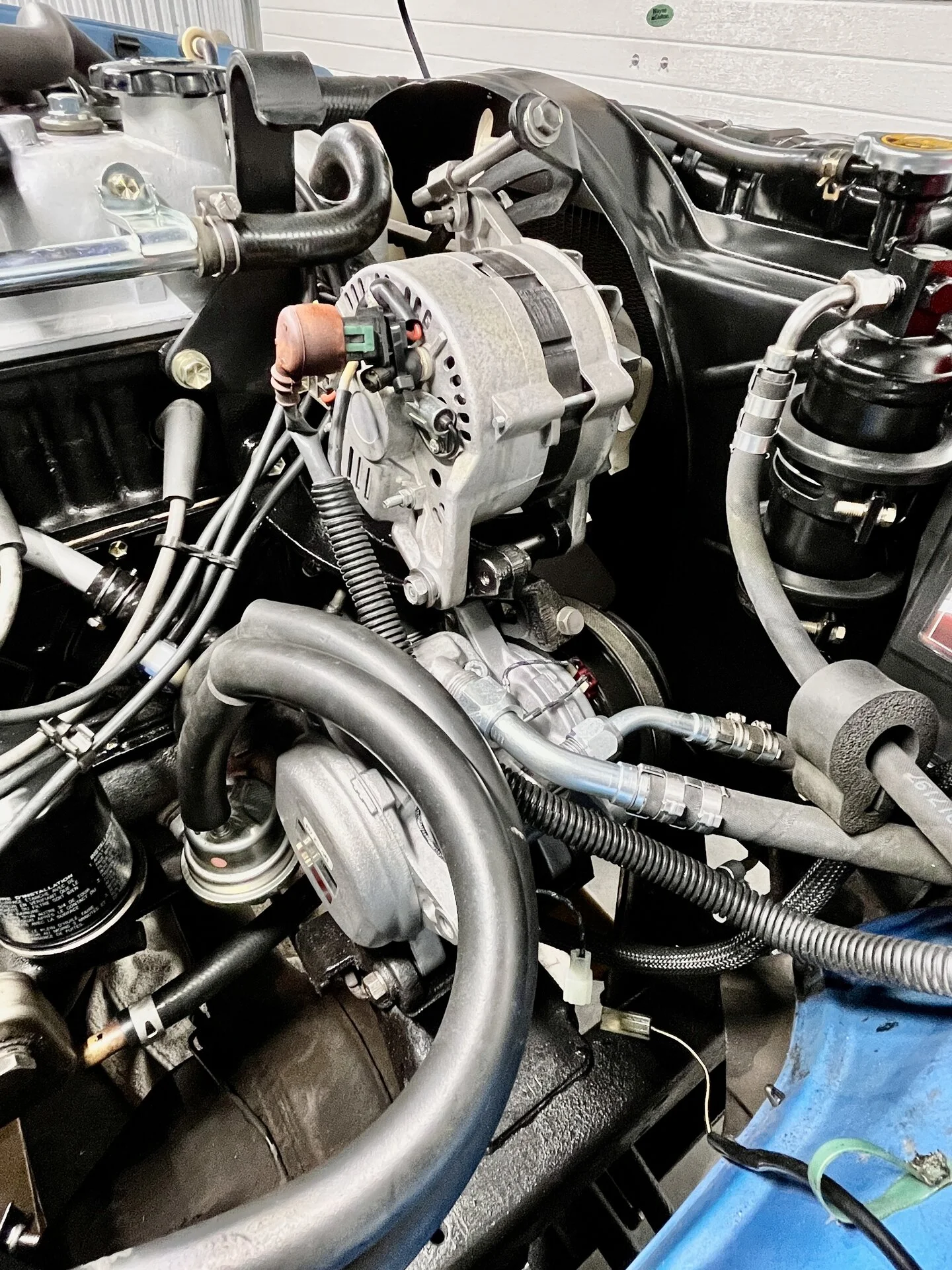

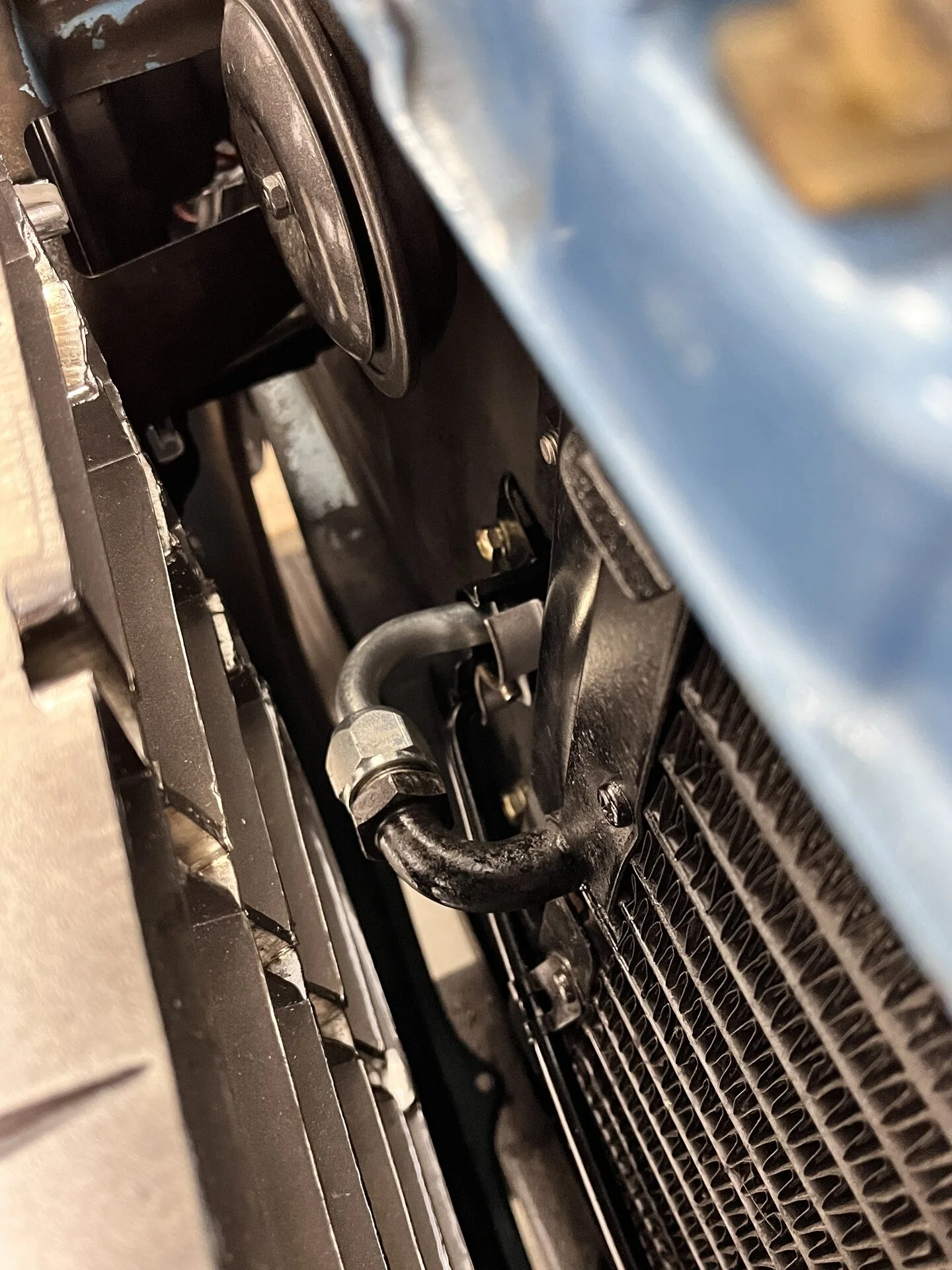

Over past few weekends, did a bunch of stuff (side cover gasket, adjusted valves, and new valve cover gasket), BUT the icing on the cake was the JIM C recurved and rebuilt distributor install (still smogged but EGR disconnected). Dissy went in perfectly on first try! Truck already ran really well (after Jim C carb rebuild) but the new dissy made it run surprisingly even smoother.
Also installed new AC hoses I had made at a commercial AC shop, attached to new compressor, drier and evaporator. Added PAG46 and will take to shop to charge with R134 when the snow melts.

I'm not exactly happy with the advance curve on the HEI or the bushings instead of bearings. It's does really well except I get too much advance off the line on an uphill start. And I miss the the stock unit with a vent. I'm glad to hear you are happy. I got some stuff to send to Jim.

Thanks for sharing this. I was just getting ready to order some belts and was undecided on which color grey or charcoal. And the winner is, charcoal. Those look really good and I don't think they would show dirt as much either.

The charcoal really looks great. Consider calling and requesting the grey accent plastics because the charcoal belts come with black accent plastics.
