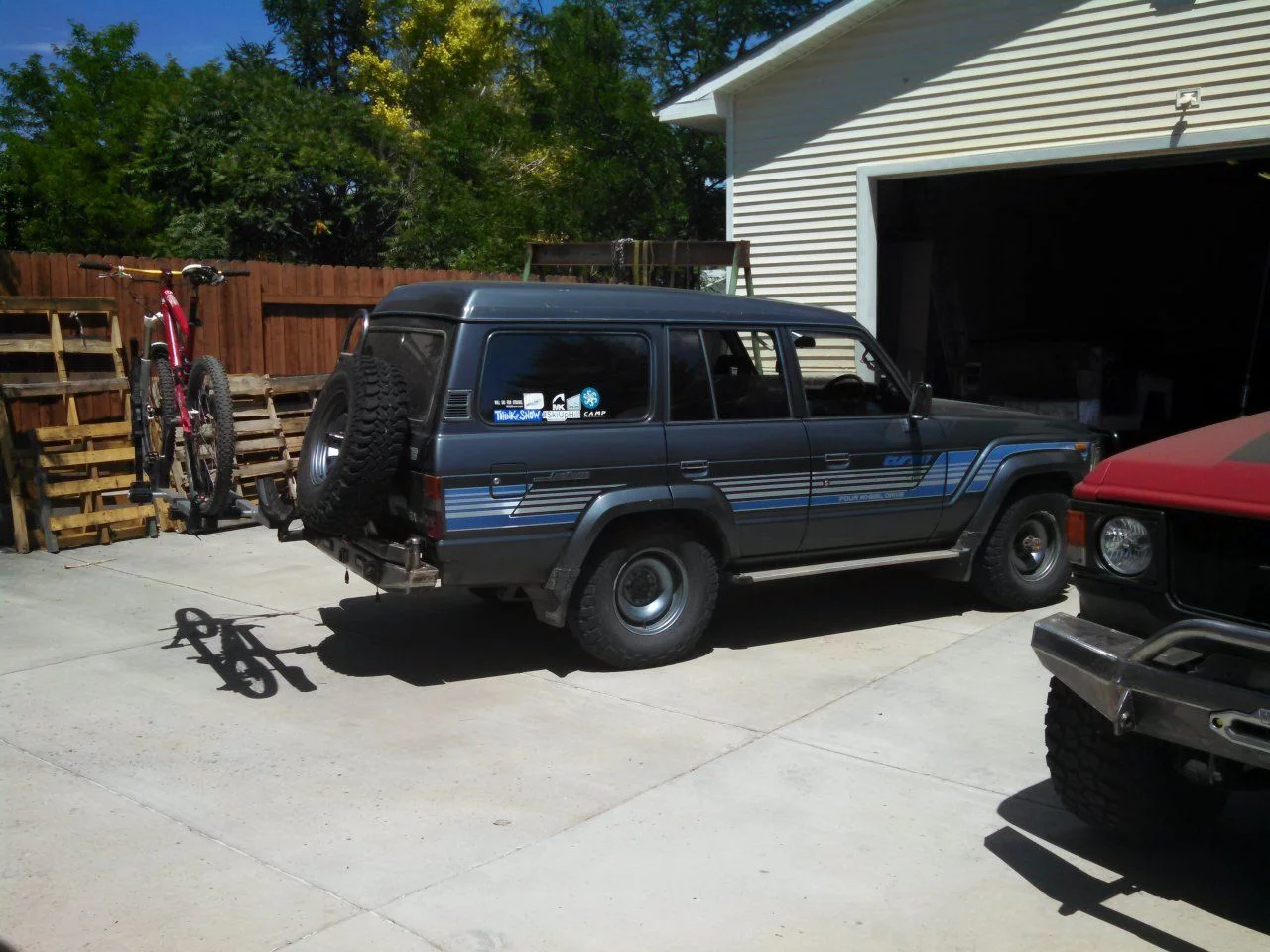

Massive oil leak on the underside just behind the engine. I think it's motor oil and not transmission fluid... not sure if that's a good thing.
Two day's worth of oil leaks. I'm going to need a bigger piece of cardboard.
Looks like a rear main leak... Take a look at the fly wheel inspection plate, pull that off and then look at your fly wheel and see if you see oil everywhere.. If so then yea more than likely your rear main, if not then maybe HG leak or oil pan leak.
