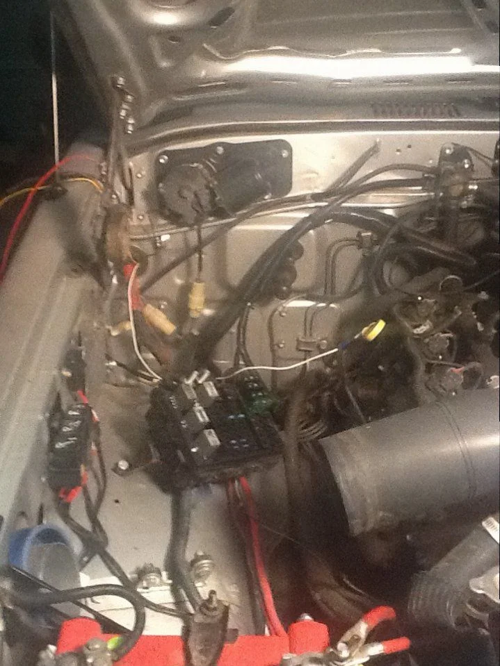

Made some great headway on my re-wire clean up. Deleted un-used Toyota wires that powered the distributor / coil and smog stuff. Got the new GM fuse box wire with a hot bus in it for more future up grades. The new radio and the 72 watt LED back up now get power from the GM fuse box.
What was your method of doing this? Did you take the wires out of the factory harness all the way back to the fuse block and/or emissions computer?
I've been afraid to do the same thing, thinking it'd be nearly impossible without the harness laid out on the shop floor.

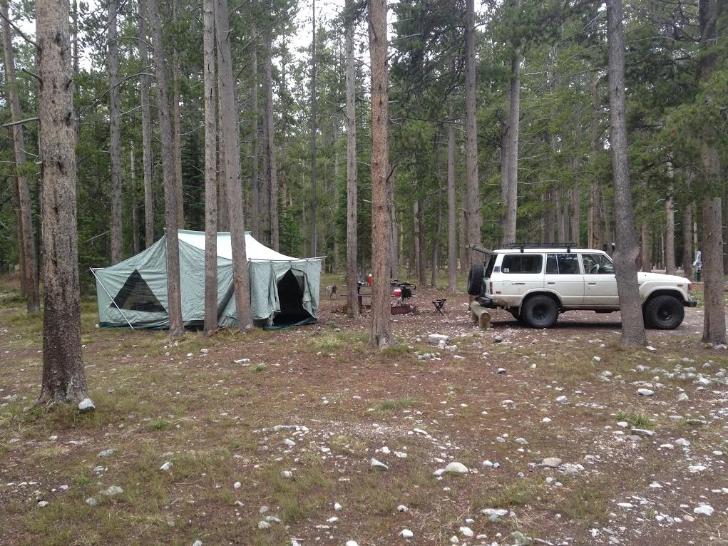

Last June 16 my cousin and I finally got our rigs trail-worthy, went up and camped at Animas Forks for a couple days and ranged out from there. I was amazed not only at the amount of snow still there and even more amazed they plow the 4x4 trails. We were unprepared for how cold it was-a good 20* colder than in Durango. I'm looking forward to getting back up there a lot this summer.
I Live in Durango! It would be fun to get a group together in Silverton this summer and explore/ camp!

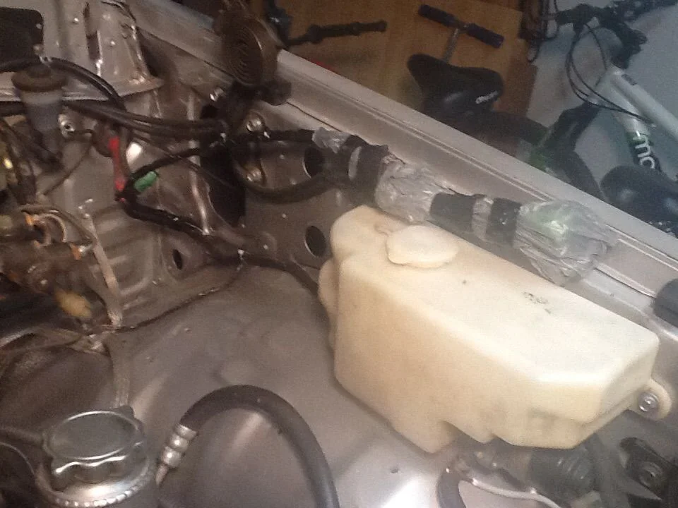

GLTHFJ60......... I too was scared about screwing up the wire hardness. I took the advise from the hot rod guy that fixed alot screws up from my engine guy. He sudjested that I do not remove the wiring hardness but cut eletrical tape that holds all the wires together and peal back the useless wires that powered the smog and other componants that are no longer needed. Then I took these useless wires and made a another wiring hardness of useless wires and then tuck them into a fender. Out of sight and out of mind. But there if in the future if their needed again in the future. Because when is a Cruiser of our caliber ever really Finshed ??????????
As you can see I have tape up the unneeded wire hardness and placed it in a bag for maybe a further use. Hopefully the bag will keep the connectors clean and ready for the future.

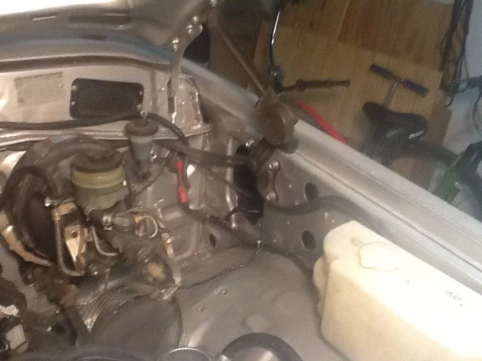

Hardness tuck away........
I like that, good work :cheers: I think I'll have to add that to the list next time I have from my front clip apart!!

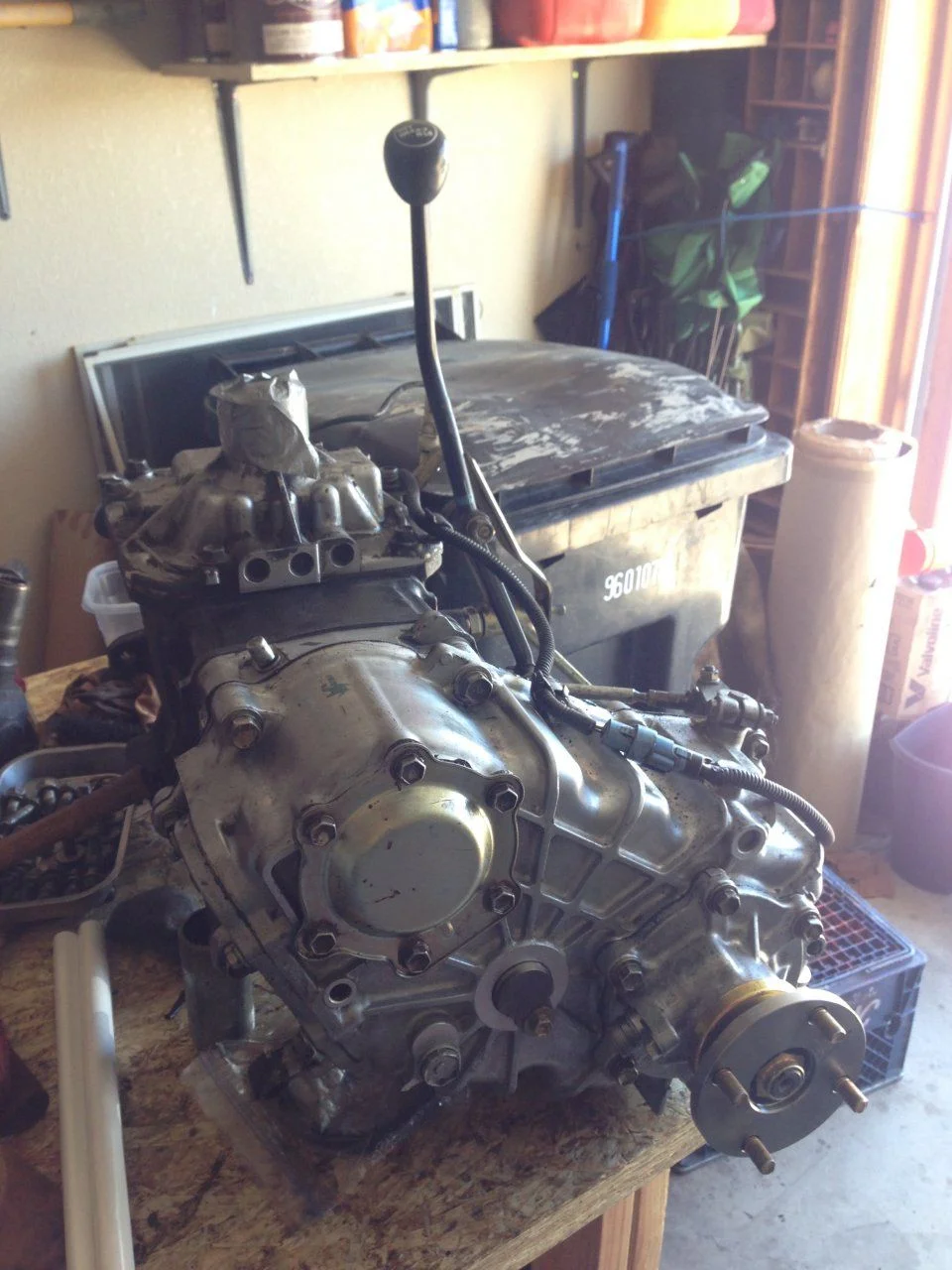

Just rebuilt the T-Case.. (Leaking)
Cool Cruiser Kit! And new Output Flanges from Cruiser Outfitters (I would highly recommend doing business with both)
