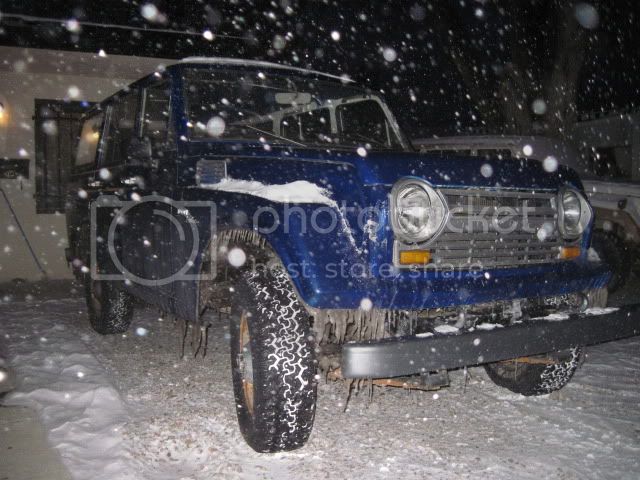

Finally got the pack of shims for the TC rear bearing retainer... I put in 11 shims!!! Basically two packs of the four different sizes that you can buy from Toyota, plus two .25 mil ones and the one that was in there before the rebuild (no idea what size). I am sceptical that something is not right, but I have checked and rechecked that everything is correct on the output shaft inside the box... I put it all together last night (25 degrees F, laying on plywood over ice in the driveway). The bearing preload is less than 10 lbs, but more than 2, but I still am not sure if the bearing retainer is completely pushing on the rear output bearing. Put the driveshafts on at 0500 AM in 22 degree darkness and ran out of fluid to fill the case.... @#%$$#. So, gotta wait till after work to fill the cases and test drive...
Anyone have a three speed case to sell in case I blew it? Ha (not so funny)
Snowing with a 30-mph wind right now. Streets are icing up again. Tomorrow ought to be a joy........ :mad:

At my house, I finally got to road test the new rebuilt TC and it seems to be fine, after all the worry. It still has a pretty good whine in high gear right at acceleration... but I can live with it. The Dynamat helped a little. I know I am done with the TC because the headlight switch seems to have crapped this morning... off to the next item.... :steer:
NIIICE Brewtus! We really haven't had snow in Tahoe since late December. We got a couple inches two days ago, but thats not snow.... I'll post a photo of the next two foot dumper. THAT's when it's fun driving in the snow! I do feel for ya though. I'm already tired of the winter. Been laying on the ground too much under the pig this month.
Keep the heater on high!
