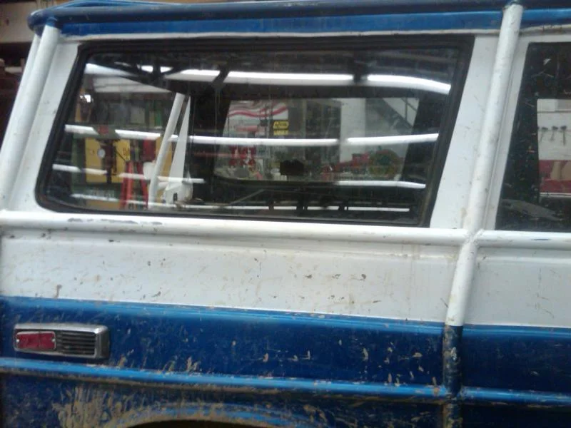

Quick turn around on the glass --did you pop it in yourself?
Reason I ask is I need to replace rubber in mine and wonder if you just did it devil may care style--Thx, Dave
Gumby,
I dunno...all I could see is he took his 4X4 labs sticker out of the window :meh: :grinpimp:
Gumby,
Just did the rope in the gasket thing. Side glass is easy.

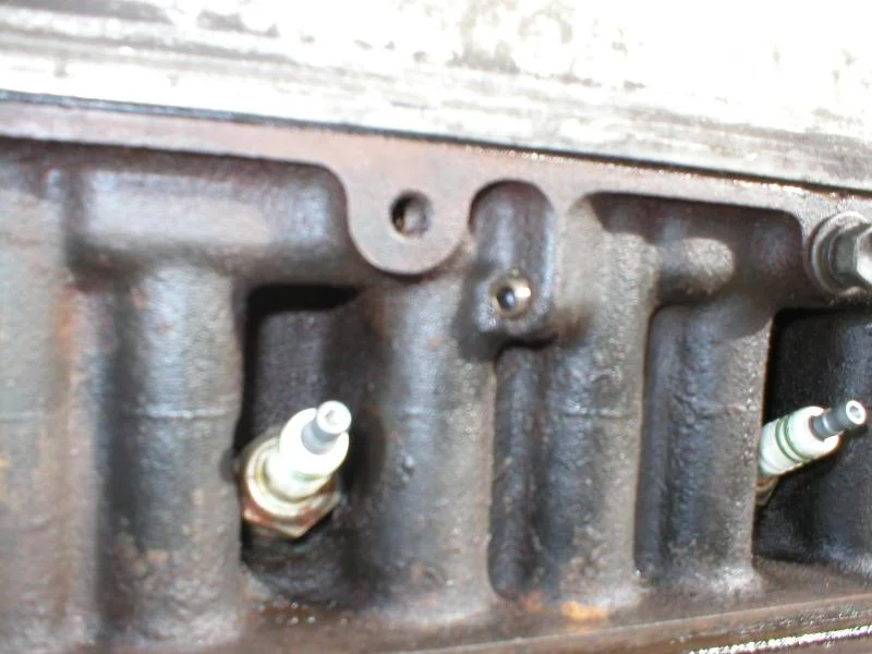

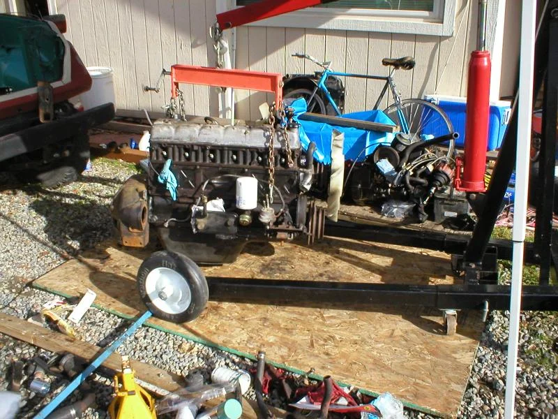

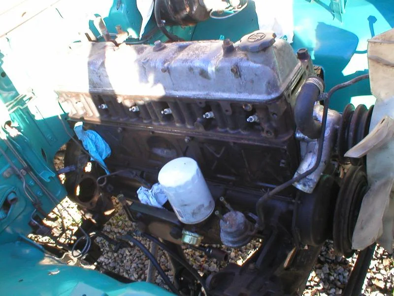

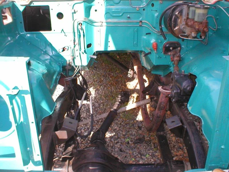

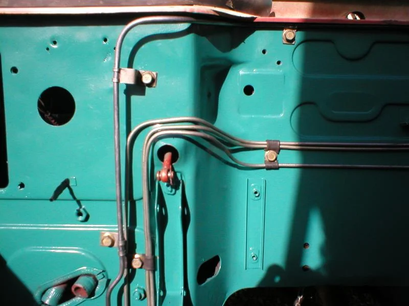

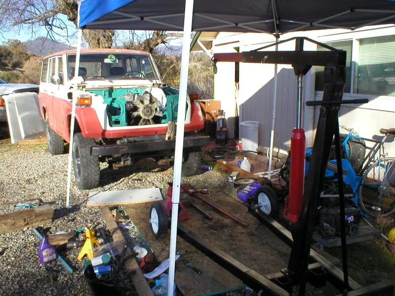

Covered hydraulic steel line supports w/ shrink tube and re-installed brake, clutch, and fuel vent lines to firewall. Re-installed clutch master and brake booster/ master. Cleaned frame and steering box. Drilled and tapped the 86 2F head oil gallery plug for a 5/16"x24 thread plug, cleaned hole and plugged it. Removed the 3F bellhousing, clutch, flywheel, and pilot bearing from the 86 2F, and installed new pilot bearing. Must weld some 5/8" rod couplings to my cherry pickers out riggers in order to bolt on the 10" solid semi-soft wheel barrow tires. Motor to go in tomorrow. Then will be pan drop and rear main seal.......
engine compartment...
4x cherry picker...
heart transplant...

Steel lines...
Oil gallery plug...
