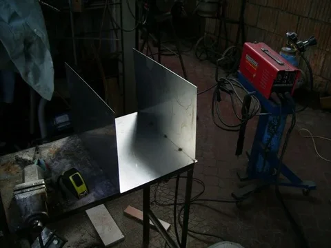

Yes Victor, tell us what kind of tank and where it's going.
Hi guys, that in the new main gasoline tank, made out 308 stainless steel, it is only 5 gallon aprox. the thing is, since I am going to set my piggie with LPG dual, that´s going to be placed on a bracket with an 85 LPG tank, on the big ald gas tank location, at least that´s the idea, I will post the set up photos of the braket and the tanks install.
my first idea was making out of aluminium, but at the very end I found the stainless steel, pre cuted on 40cm X 30cm, the tanks uses the original fuel sender, all you basicly need is a harbor freight tig welder ( I Need and AC/DC tig welder) and a 3 or 4 pepsi cans and a long aftermoon
