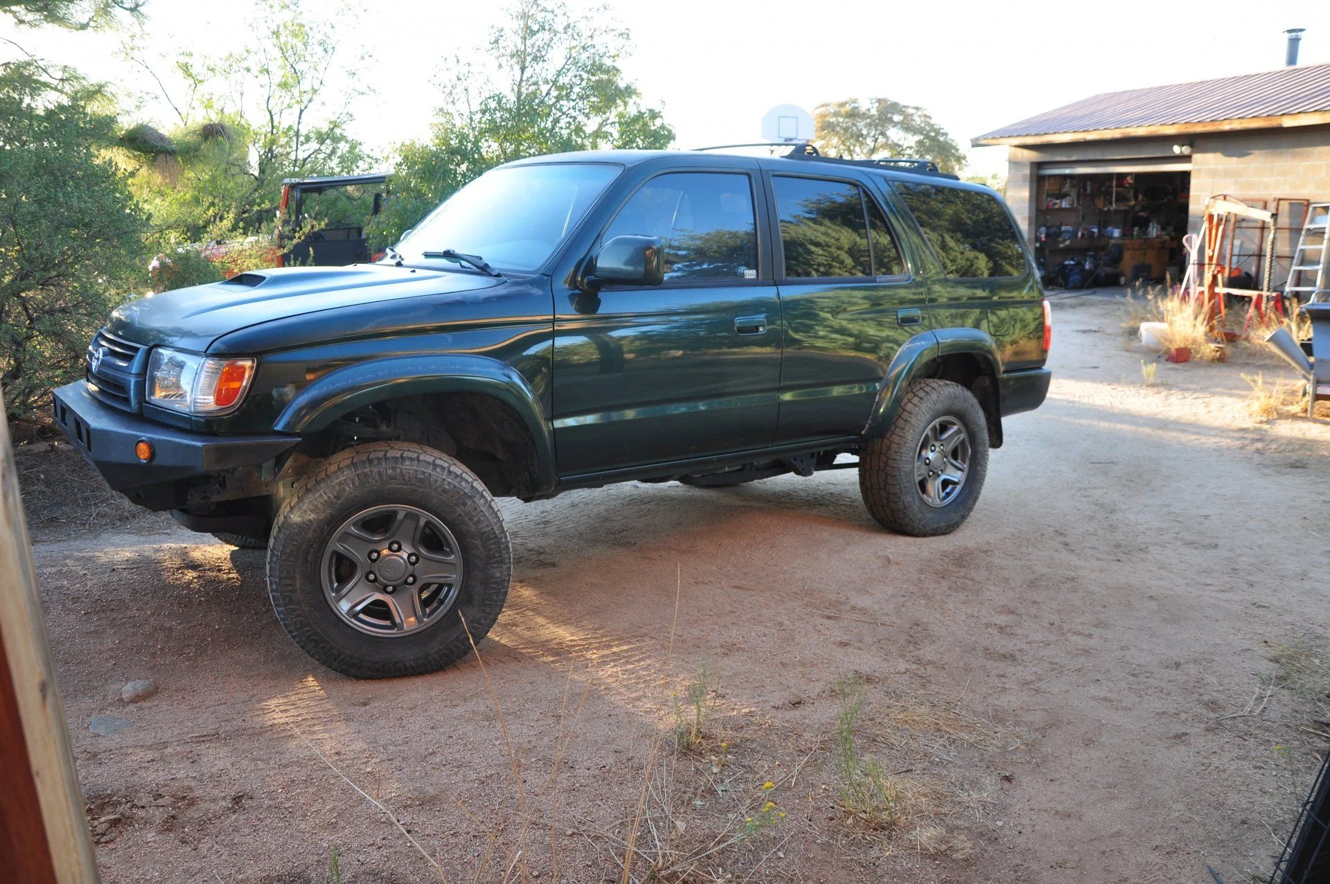

Did the brakes on the Subaru this morning and took the LC to get smogged, it failed :(

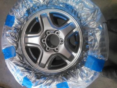

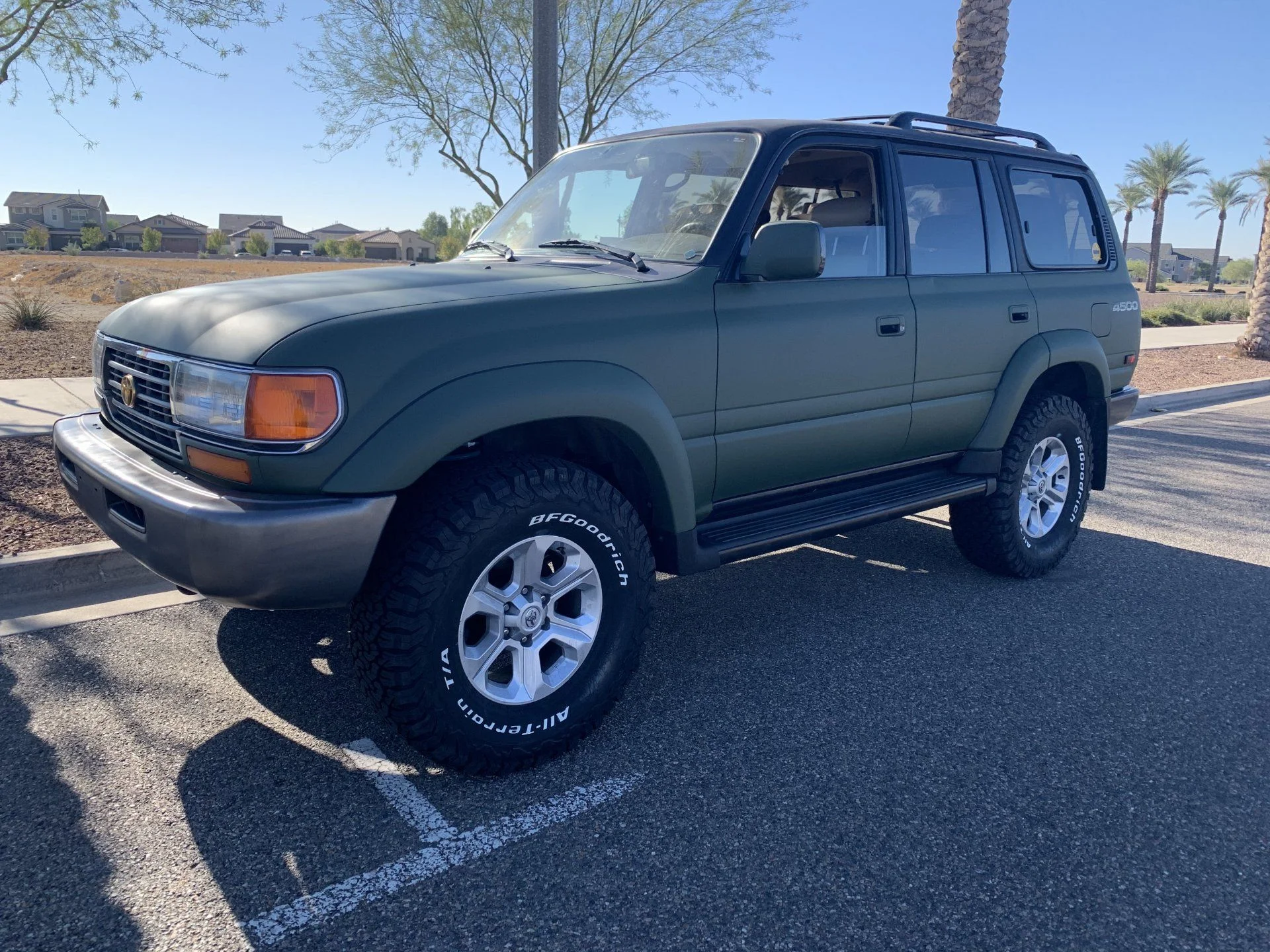

I have always liked the look of the 5 spoke limited wheels but didn't care for the finish.
Today I fixed that, and now I am happy.

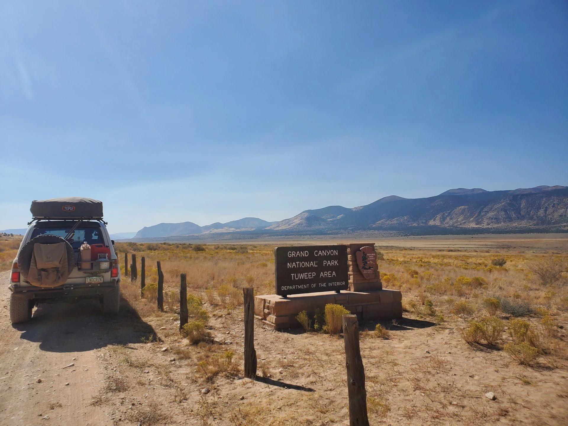

Just returned from Unit 30A rifle mule deer hunt in Cochise Co's San Bernardino Valley. A few gnarly old ranch trails; added more pin striping. More hunters than we'd ever seen out there; many more than there were bucks. Favorite night was bivying out alone under stars and waking, fixing my coffee in the field. Was grateful to harvest a young 2x3. We found some amazing petroglyphs (known to academic community). Careful observers will note my high-tech hatch prop....

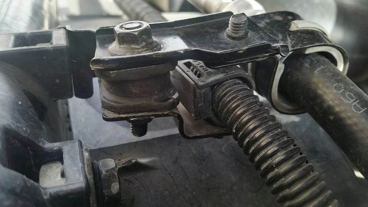

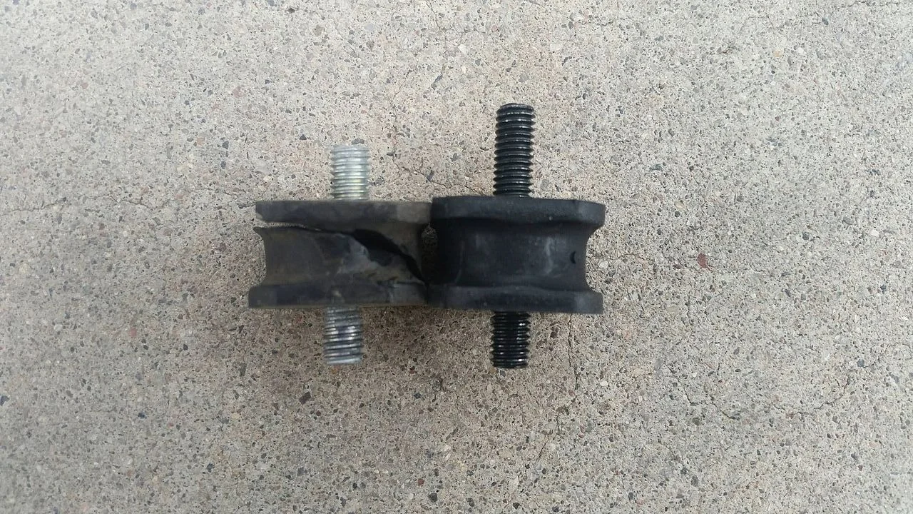

One of the insulators for AC line above the radiator broke and I don't want to pay $40 for 88718-60880. I found this Toyota part that works good enough for me. The longer thread on one side is not a problem for this application. Part number is 88467-30270. It costs $1.11.
insulator1-jpg.2491146
insulator2-jpg.2491147
insulator3-jpg.2491148
Did this!
