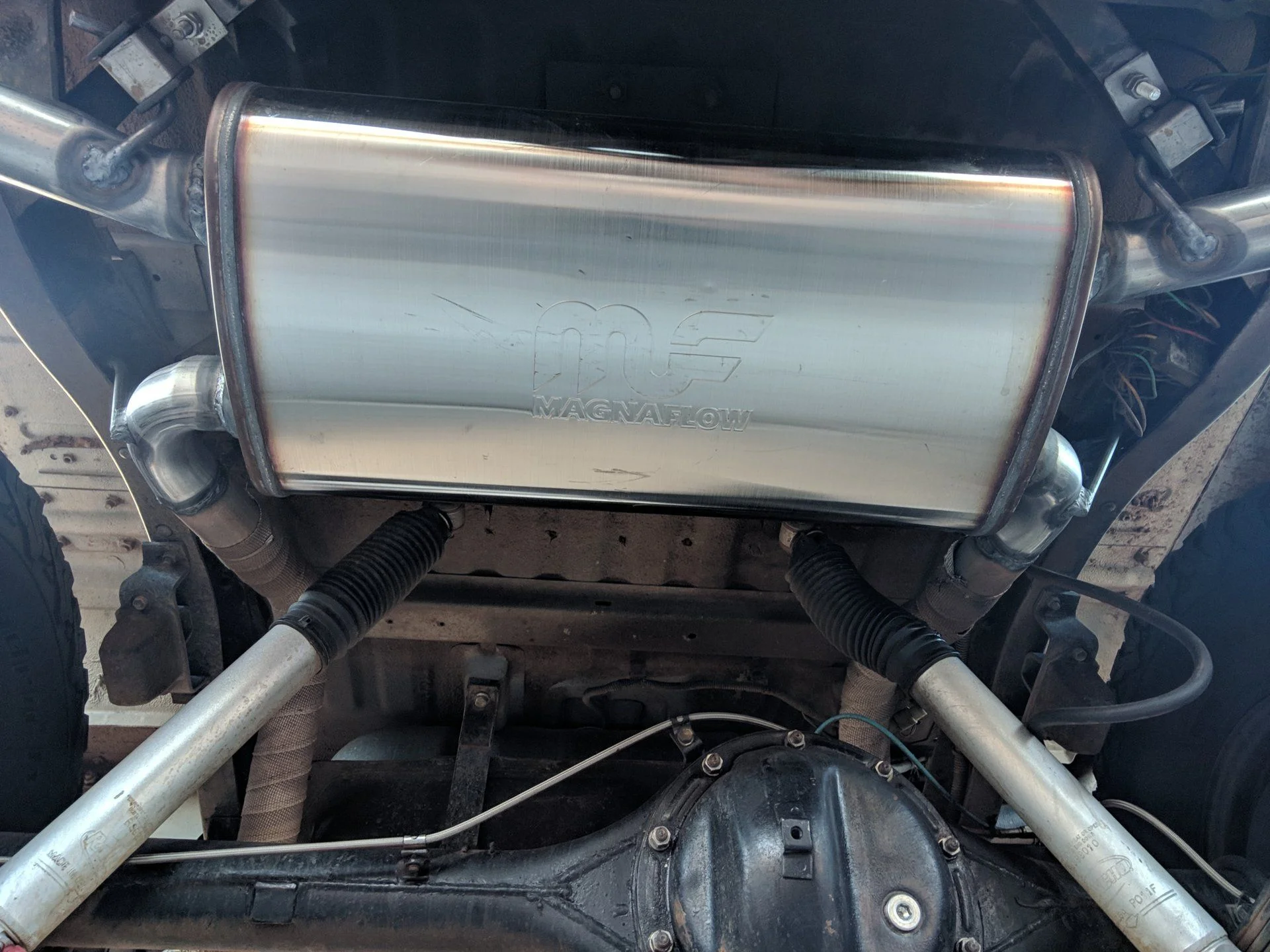

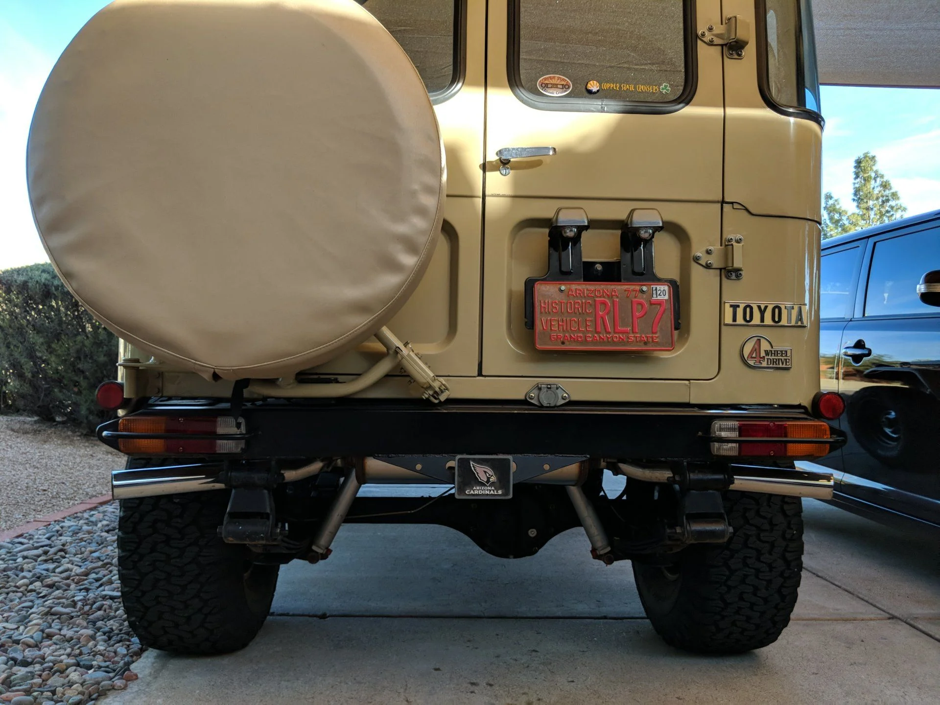

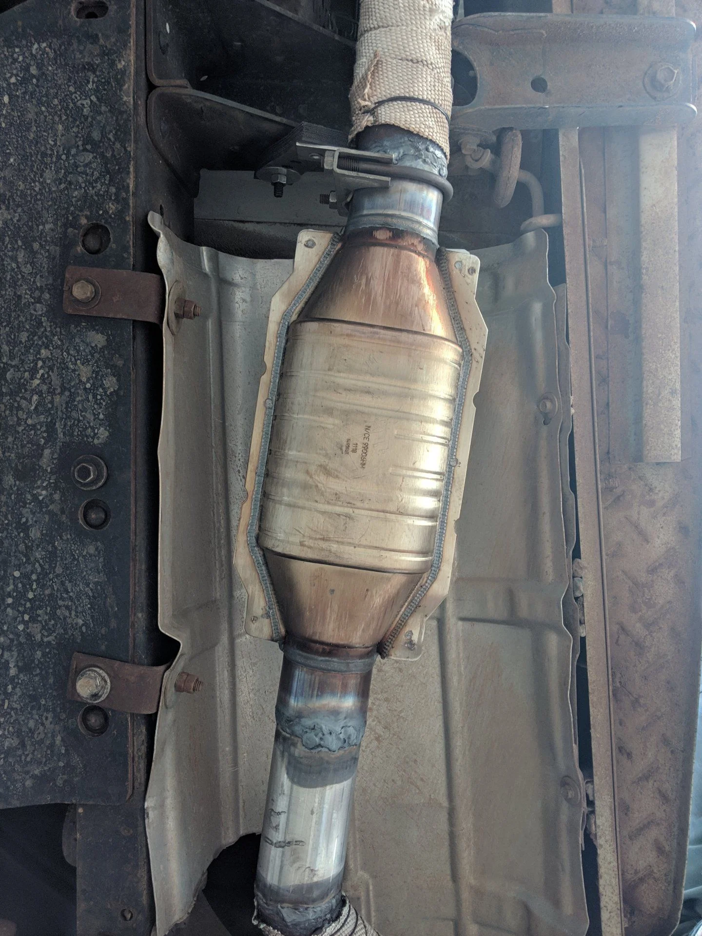

Pulled the trigger on what I now realize I should of done years ago to get rid of the constant fumes from the 5.7 tpi V8:
I had catalytic converters added to my exhaust system. Gary at Mighty muffler worked his magic and installed 2 Magnaflow cats where my mufflers used to be and a large free flowing Magnaflow 2 in & 2 out large single behind the rear axle. Also extended the outlets and a little more angle rearward and slightly down.
It has a nice deep tone at idle but everything above idle is even quieter than the previous set up and I don't have to keep a window cracked for fresh air.
This engine was originally designed to run with cats when it was in the early 90s trans am. Even when it's cold there is virtually no odor coming out of the exhaust. LCP would call it "wife approved"
It was never fun to come home and have my clothes and hair smell like fumes. As you can see Gary added extra hangars for me to help keep everything secure against repeated bouncing and vibrations from four wheeling.
