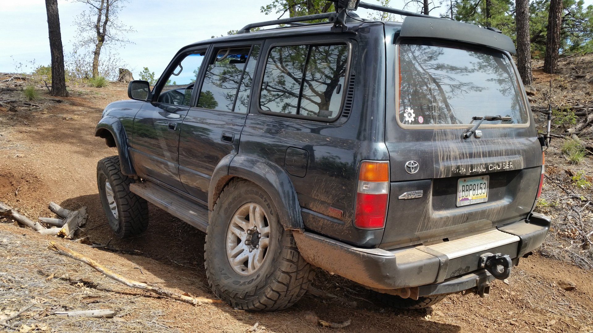

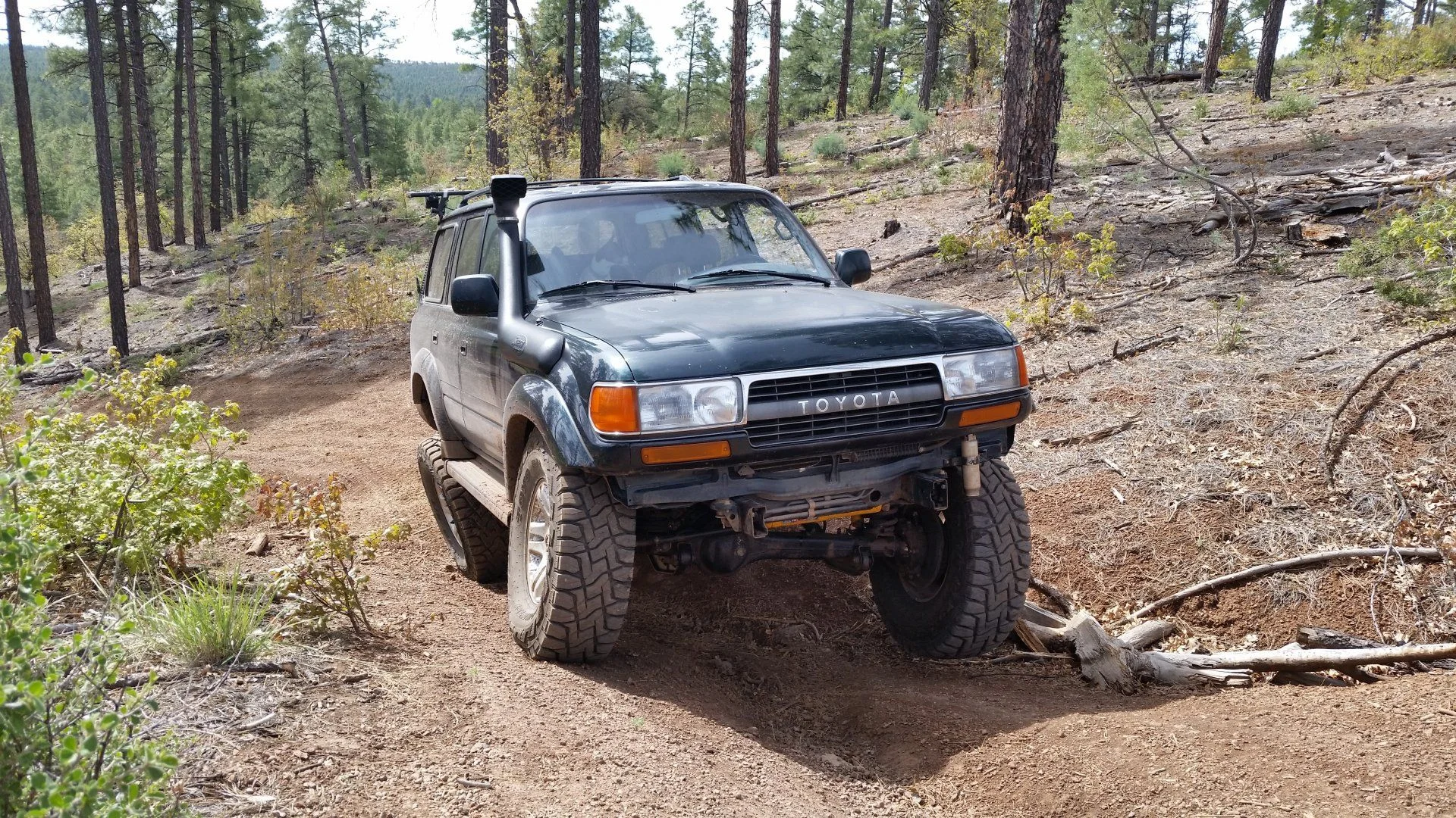

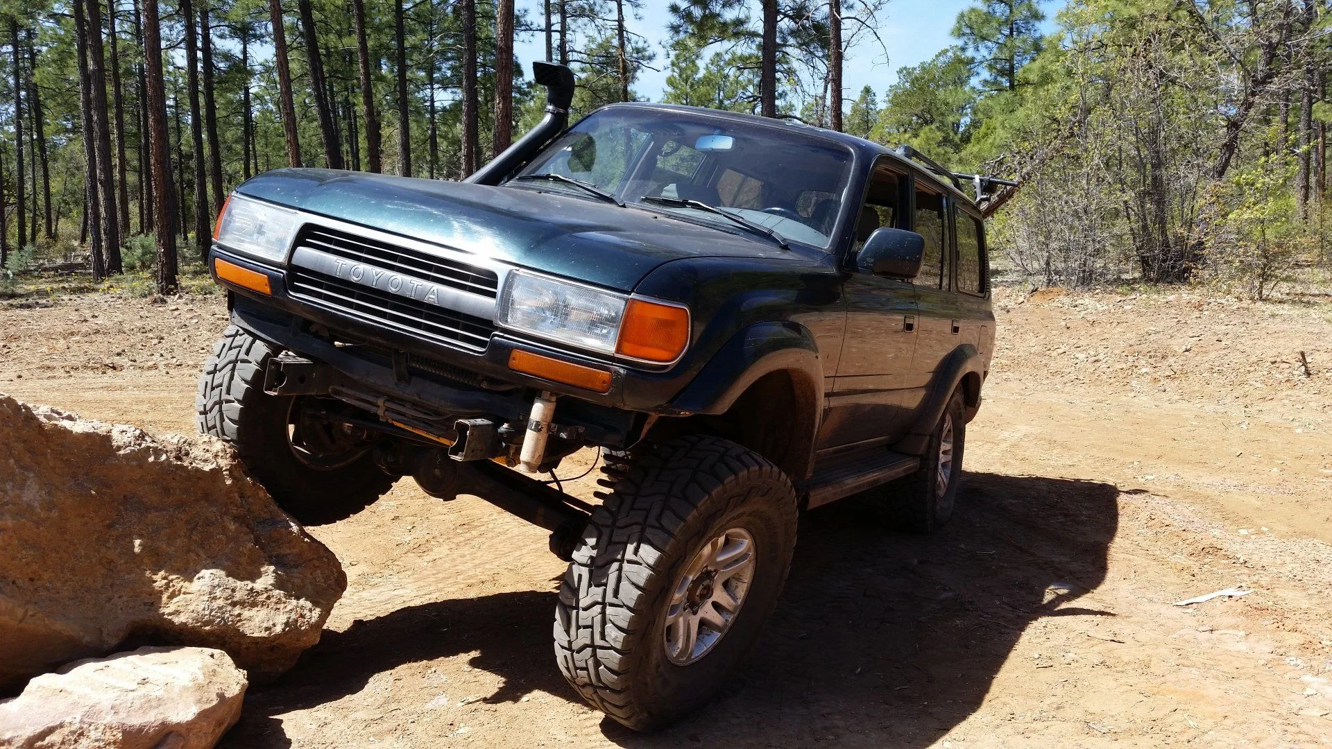

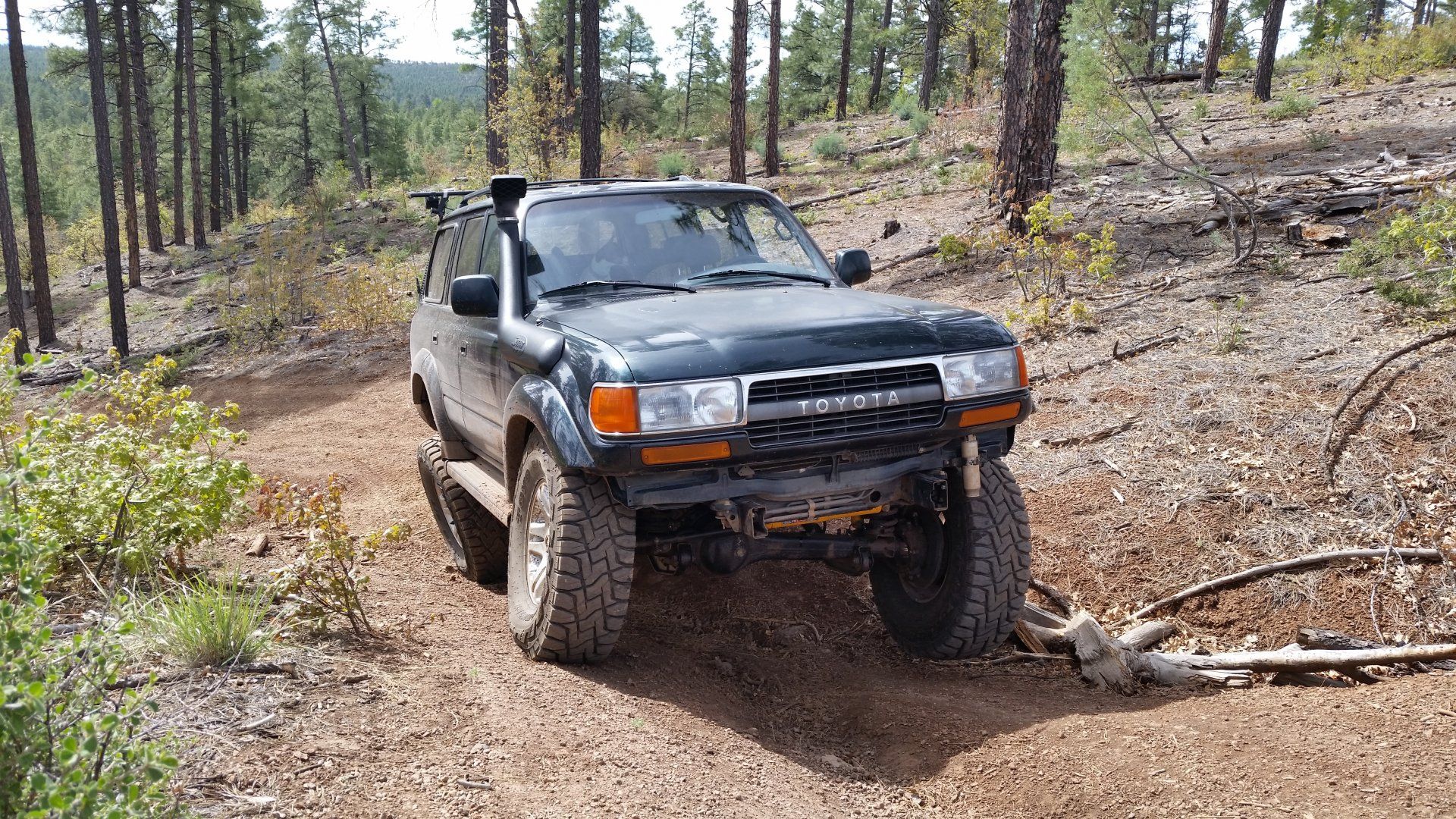

Testing suspension after removing front sway bar, back flexes nice. Definitely need some longer shocks. I'm on ome Ls now...
@LandCruiserPhil recommendations?
Yeah I'm gonna keep the rear for now, don't see it restricting much there, I'm also on some pretty heavy springs ome comp coils, I did notice some body roll but much smoother transfer going over small bumps.

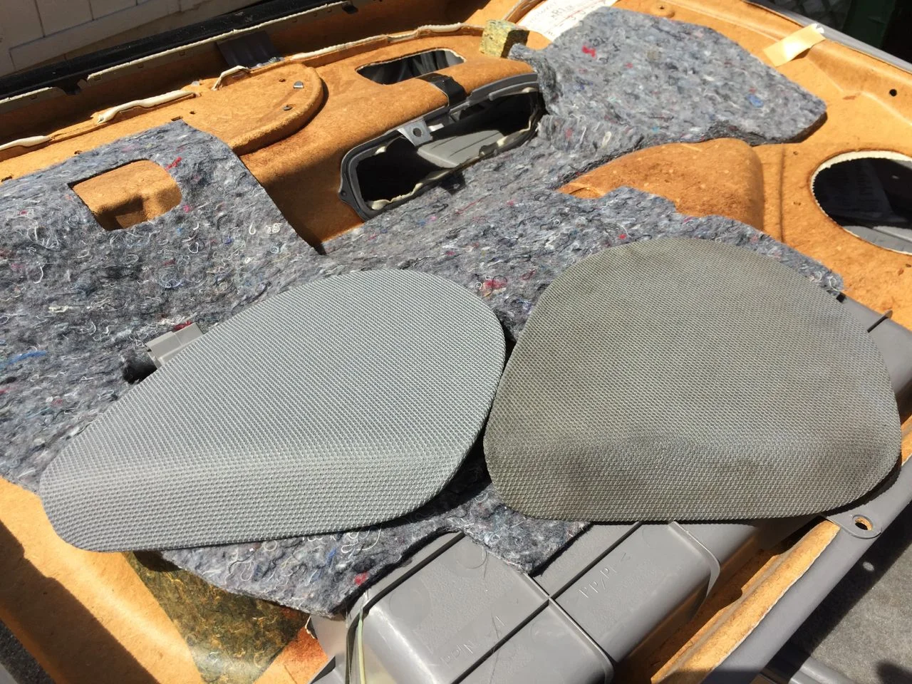

I changed out all the speakers and speaker covers in the 100. Only took a photo of the speaker covers.
Used Rockford Fosgate Prime R165X3 that I ordered from Crutchfield for $50 a pair. The job is very easy. Only need to trim two plastic pieces on the factory speaker mount. I probably did not need to change out the factory speakers because were actually in good shape, but since I had already ordered the speakers and had the doors apart, I did it.
CJ - The speakers in your truck were already replaced, so you simply need to replace the speaker covers.
Awesome. Thanks the speakers still sound good and I am glad to know they have been replaced. I will get some speaker covers at some point.
