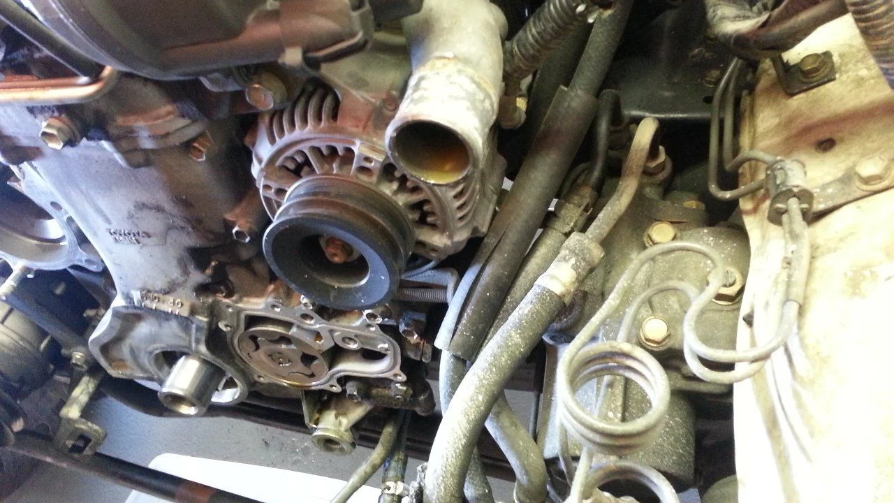

The hit list included:
Oil Pump Cover O-Ring/Seal - 15188-66020
Oil Pump Cover screws (x7) - 15183-66020
Front Main Crank Seal - 90311-52022
Water Pump w/ gasket- Aisin WPT-023
Fan Clutch - Aisin FCT-004
Thermostat - 90916-03117
Thermostat Seal - 16346-66020
Radiator - 16400-66040
Transmission Cooler Lines (x3)
Belts - Gates 7447M x2 and Gates 9360
A/C Idler Adjustable Tension Pulley - 88440-26090
Idler Pulley - 16603-66010
Radiator Coolant Hoses (HPS Silicone Performance) - 57-1218-BLK
Royal Purple Coolant
The whole thing went pretty smoothly and in the end, no runs, no drips and no errors.
The main intent was to address the oil leaks at the crank seal and oil pump cover but while all most all of these things had to come off to access I decided to progress with base-lining things.
The two pulleys were making noise so they had to go. The Radiator, Water Pump, Thermostat and Fan Clutch were all "you might as wells". Now I at least know the history of the parts. The good/used parts will go on the shelf so maybe someone in a pinch can have a part if needed. Big fan of "Paying it forward".
I had planned on replacing all the cooling system lines with the new silicone but the HPS kit I got is missing one of the preformed lines so until I can do them all, just stuck with the main coolant hoses.
Still have to sort out the EGR issue and when I have time, the lift and all new bushings everywhere.
