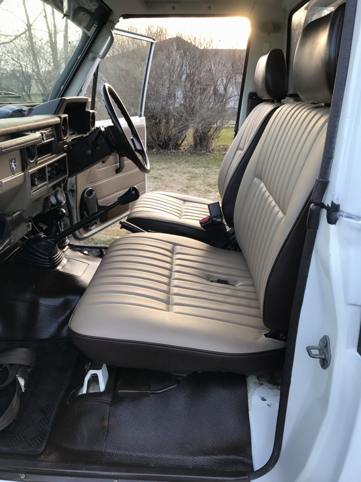

First time I've seen front seats configured that way.
Awesome upholstery.
60/40 was common in pickups. We also have an Aussie FJ73 with a 60/40.
Finally got the interior cleaned up and put back together which included newly upholstered seats. It drives much better now...

I need to get this done badly. the PO was a rather large fellow and me being small in stature seem to gravitate towards one butt check depression and then the other. Would you mind sharing approx costs so i can budget? I need to find someone local that does that work. I can PM if needed
Probably not helpful, but I paid $200 to get a vinyl dog-proof seat cover for my rear seat.
I wish it had been a straight forward removal of the seats, get them covered and then re- install them. I also removed the floor mats to clean up 25+ years of crud. That revealed that the felt backing of the floor mat had degraded and stuck to the rusted floor boards. I had to wire wheel all the old felt to remove it. I then dealt with the rust. Ground it down to clean metal, primed, painted and installed some dyna mat to compensate for the lost insulation. Far from professional work but the floorboards are now protected. I then re-conditioned the floor mats and made them look new. I'm happy with the way it turned out.
Those seats turned out very nice.
Thanks, Charles. I wasn't sure what to expect but I think the the guy did an awesome job.

Thanks! Before I had the seats done, I looked into converting to bucket seats so I could have a center console, as there is very little room for storage. And I also wanted one of those fancy new cup holders all the bucket seat guys have recently purchased. I found out it isn't a direct bolt up so I kept what I had.
I shopped around for quite a while but I live in a limited market without much competition so I think that inflates the prices. Prior to finding the guy who did the work, I had quotes from $700-$2000. I got them done for $500. That was a good deal for me.

My concern with the felt backing was the fact that if it got wet, it stayed wet for an extended period. My Ute had a small water leak (seam along the bottom of the windshield) that kept the right floorboard moist. When I replaced the mat and cleaned up the corrosion I placed some 1/4" rubber strips between the felt and floor so the felt could breath and dry quicker in the event it got wet again. At a minimum, peek under the mat from time to time.
