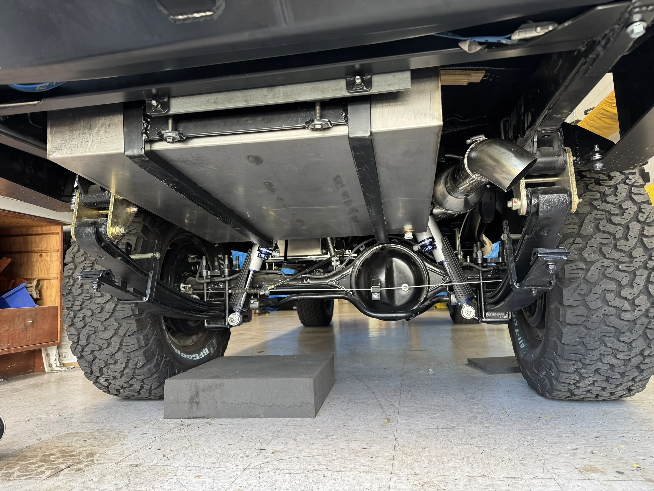

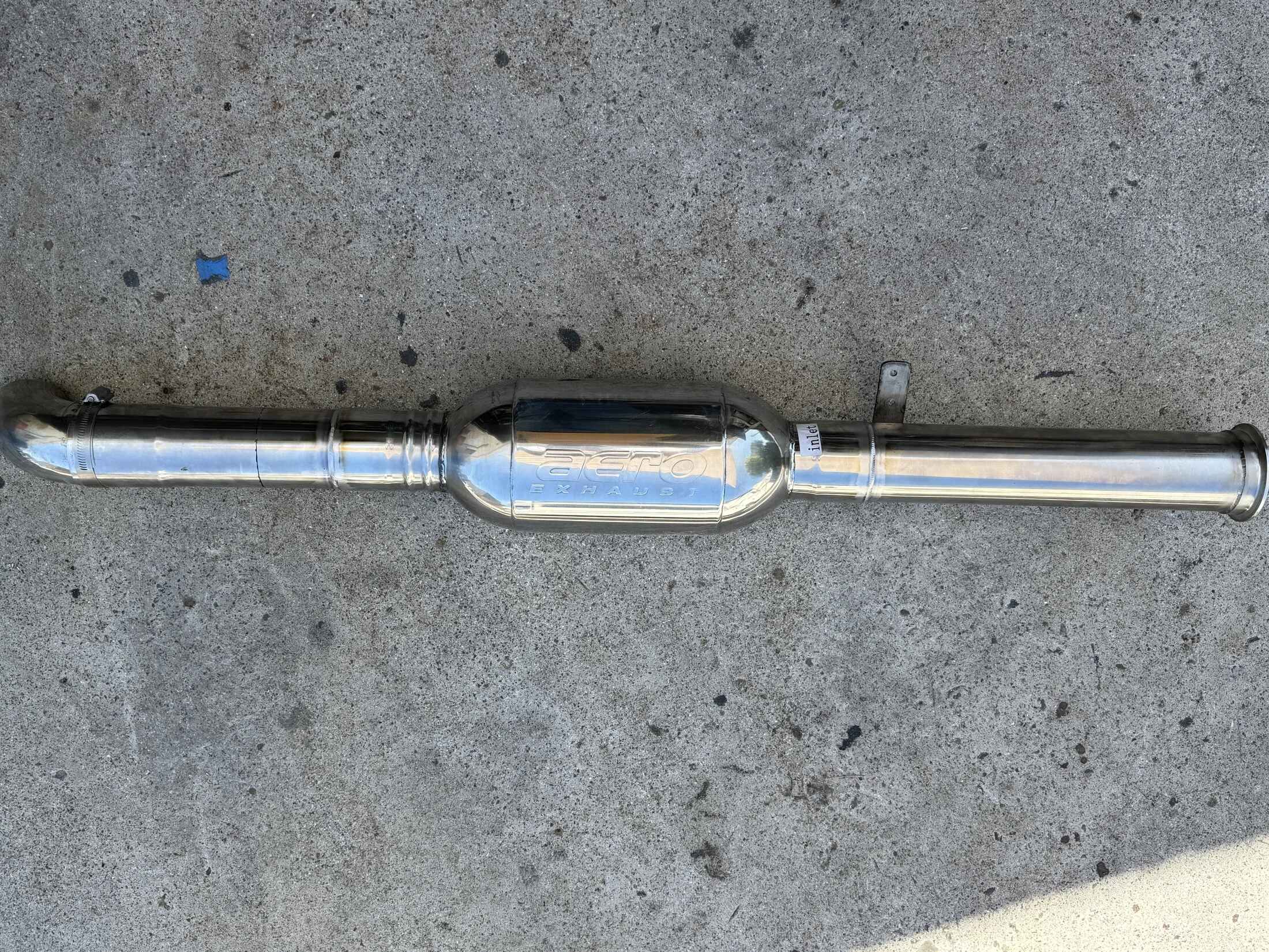

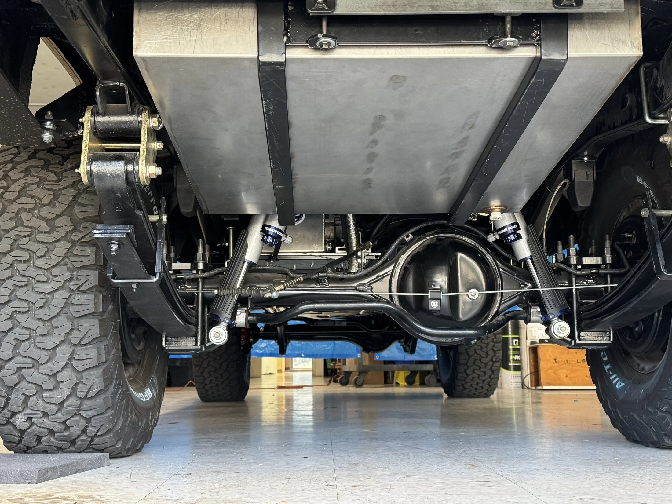

While the exhaust being TIG welded, I struggled this morning with the 32 gallon water tank. I think it will work leaving 7” on the side for the 6” muffler. It’s tight.

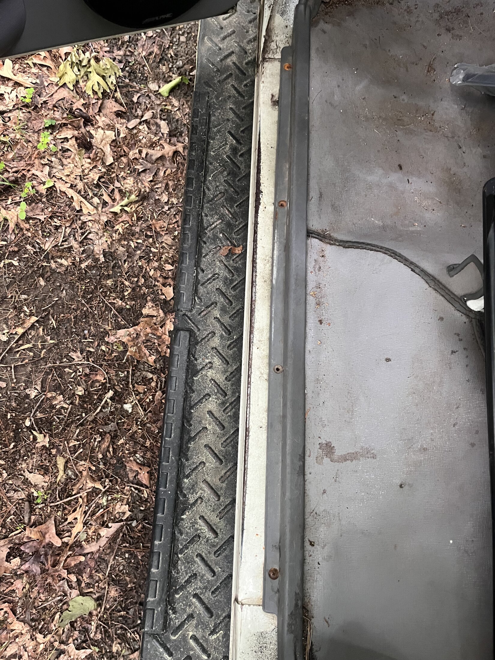

Those are nice looking, might have to look for a set.Black stainless sill plates. Had to source screws myself, I wish they came w the black stainless screws as advertised on 70seriesstore.

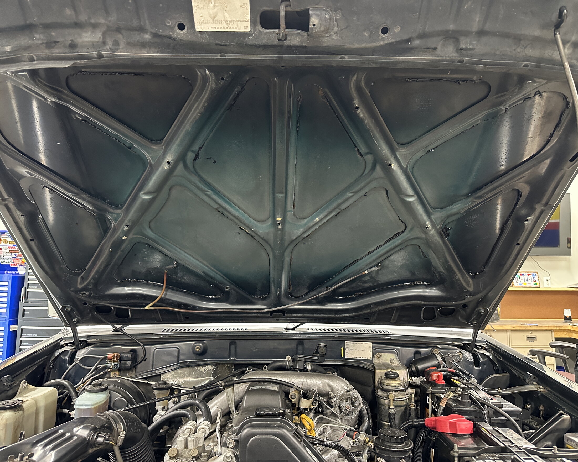

Removed the hood liner and applied Sikaflex seam sealer between the supports and the hood. 18 new clips to put the liner back on (90467-09014).
Yes. Hood vibration is gone when driving. Also no more resonance sound when I close the hood, sounds solid.Was this done to reduce the hood shake that these are known for? Did it work?
Interested to see how this works out long term because I'd like to do the same. Every example I've driven, including our own, has this hood shake.Yes. Hood vibration is gone when driving. Also no more resonance sound when I close the hood, sounds solid.
