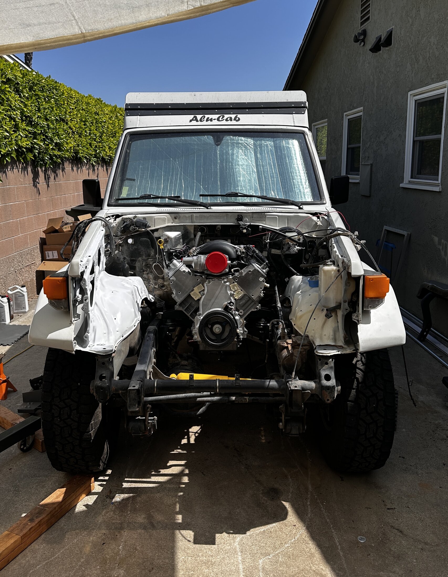

LS3, i went with "connect and cruise" just to simplify a bunch of issues (and some of the big downsides like loom being long doesnt bug me). At the core of that decision is wanting to swap in a 6L80, the aftermarket ecu support for the 6L80 isn't super mature yet is my understanding.
Got it fully mounted, my big hope was that the adapter meant for 80-series would mount up correctly and space things correctly. That totally worked which was huge, now onto wiring, fuel, cooling, steering, etc. Self imposed goal is to have it ready to go for expo PNW so feeling the pressure, I think in a good way 😬
