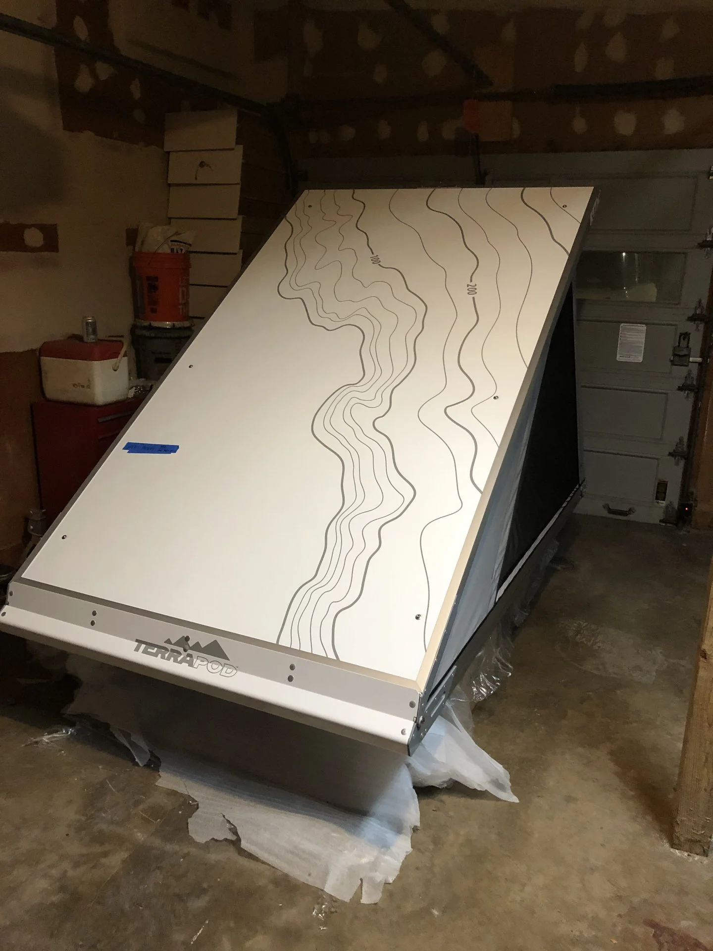

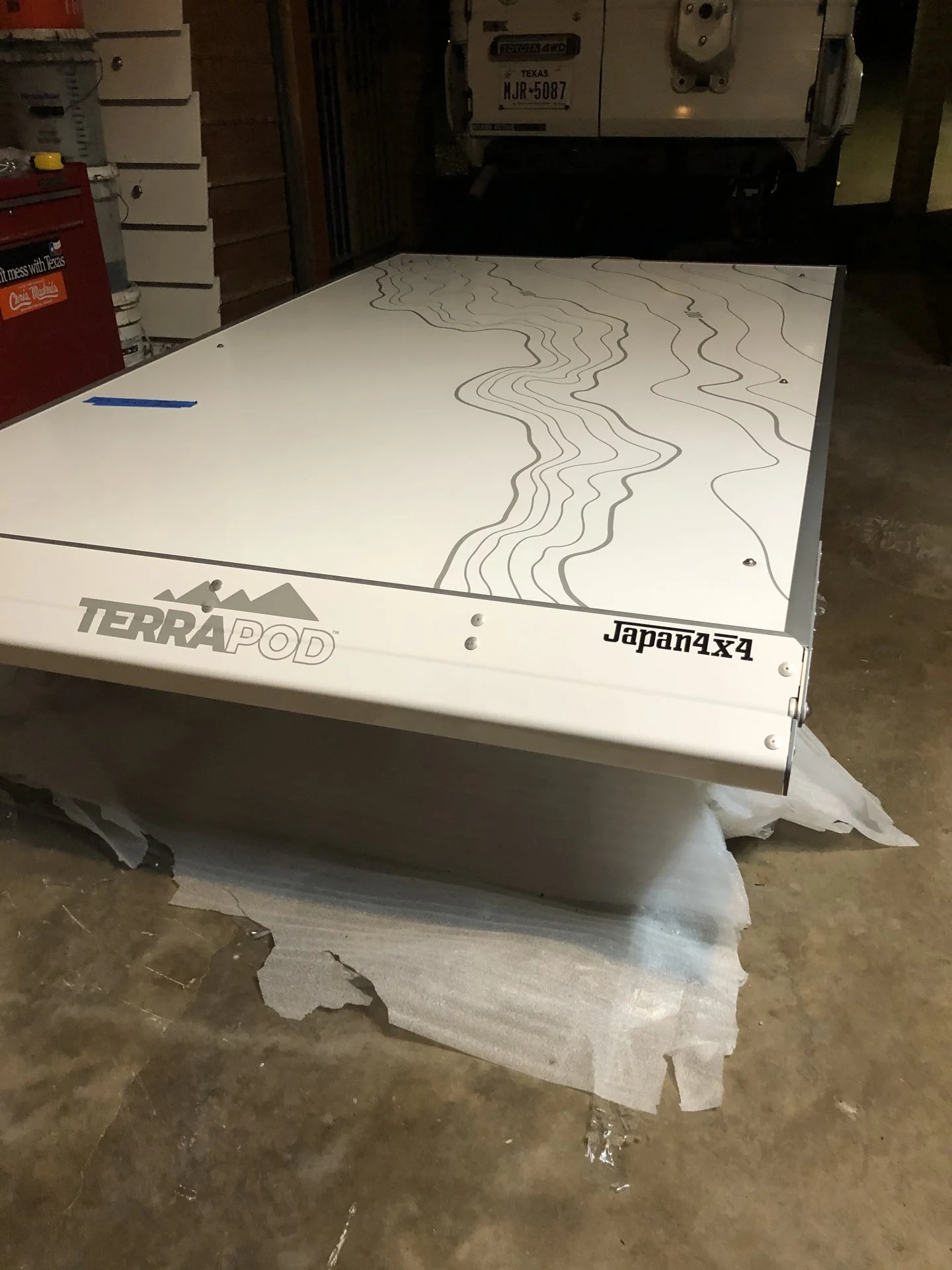

This arrived recently for the 77. It was actually ordered before Covid-19 became a thing but finally came. I am working on some other projects at the moment so I will have to wait on installing it but I did put on a Japan4x4 decal on it at least.

BADASSSS! I want to do a troopy style top on my BJ74 in the future

Is the length of the 74 under or close to 94" from the end of the FRP top to the top of your cab where the windshield is? If so, I could see it being possible with this RTT. I am thinking there will probably be overhang though.
Nope. It's 82~83" for roof length.

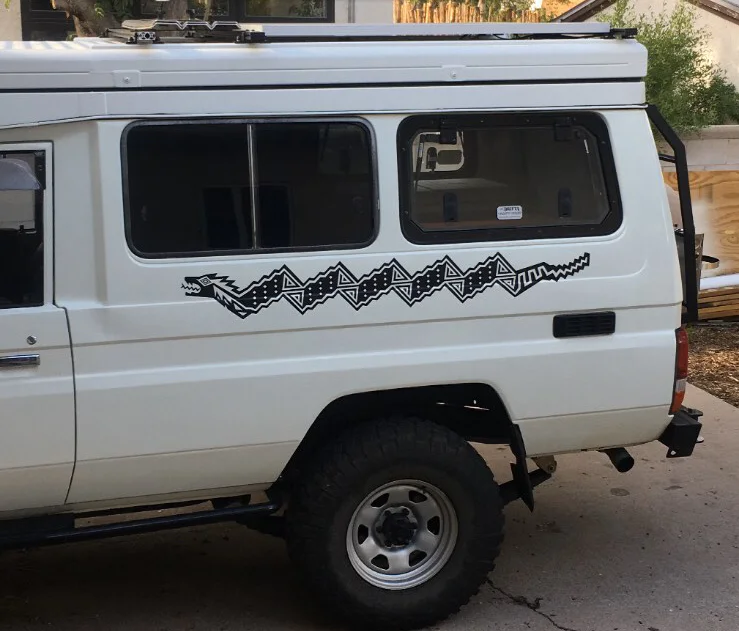

@SeanBJ74 I have a spare top and at some point I'm looking to upgrade it into a pop-top style setup. here is the thread and a bunch measurements on the tops
BJ74 Poptop, modular top camper or something - https://forum.ih8mud.com/threads/bj74-poptop-modular-top-camper-or-something.1214677/

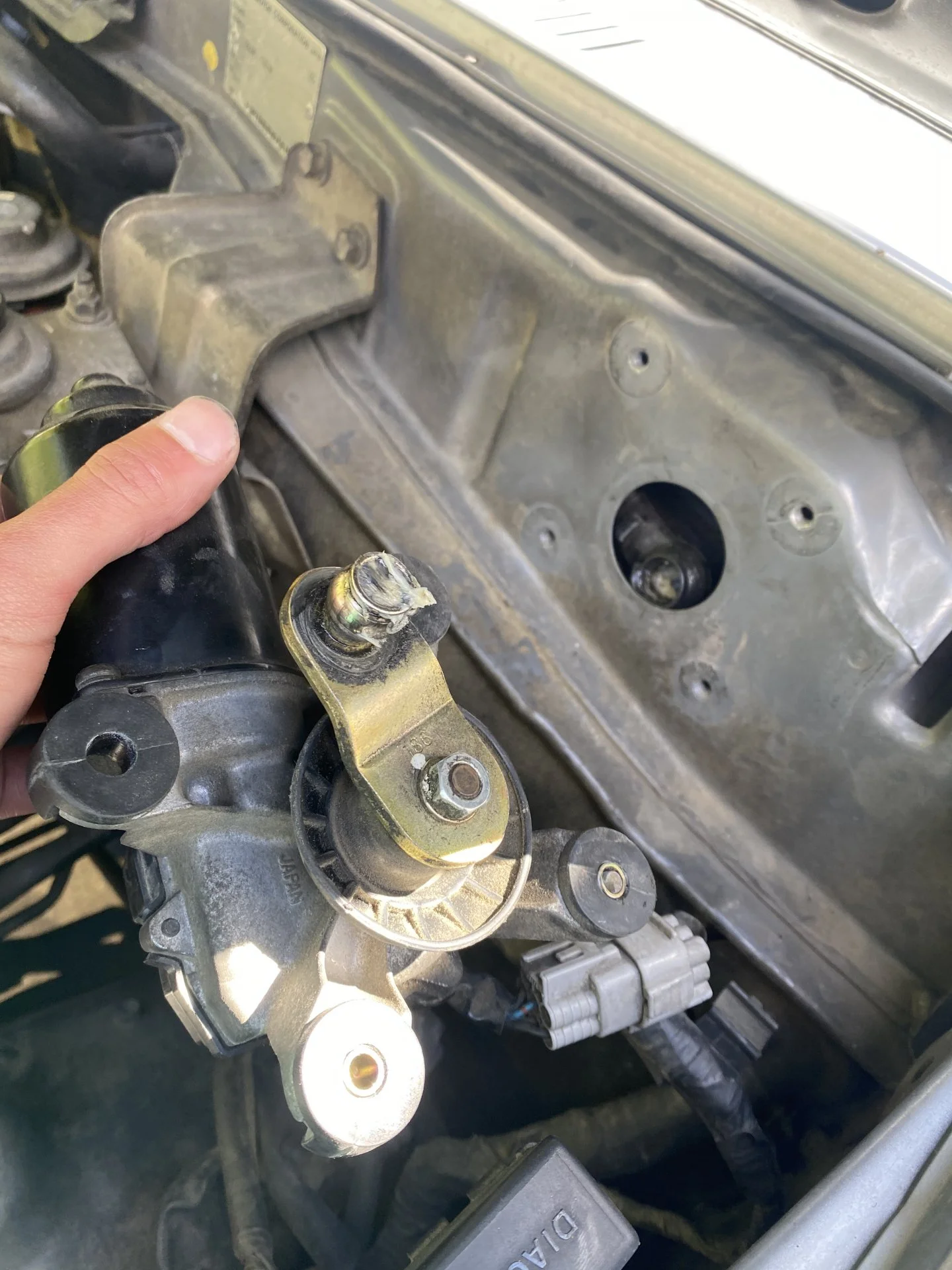

Went to a local trail for a nice cruise in the rain. On my way out I was testing Metto on some obstacles, nothing too crazy, but my wipers got stuck in the up position. After a drive home in the rain, stopping every so often and manually wiping, took a closer look. Ended up knocking my wiper link assembly off the motor. Weird. Oh well, fixed now. Glad it wasn’t electrical.

I was always wondering whether there is a way to lube the wiper linkage. But I never figured any way to get even near it.
Any suggestions?

Once you remove the sheet metal, there’s 6 screws on the LJ78, you’ll see some access points to connect the linkage to the wipers. It’s tight but could work.

Hello,
In a nutshell:
  1. Remove the wipers.
  2. Remove the grille below the wipers. Six Phillips screws.
  3. Unplug the wiper motor.
  4. Remove the wiper motor. Four bolts and some prying to release the ball joint.
  5. Remove the left wiper stake. Three bolts.
  6. Remove the right wiper stake. Three bolts.
  7. Carefully pull the linkage out,
There are four joints in the linkage to lubricate.
Once you lubricate the mechanism, install the linkage, motor and wipers, starting from step 7.
Hope this helps.
