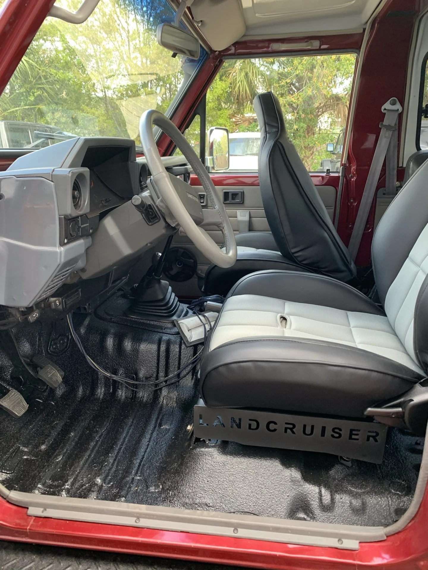

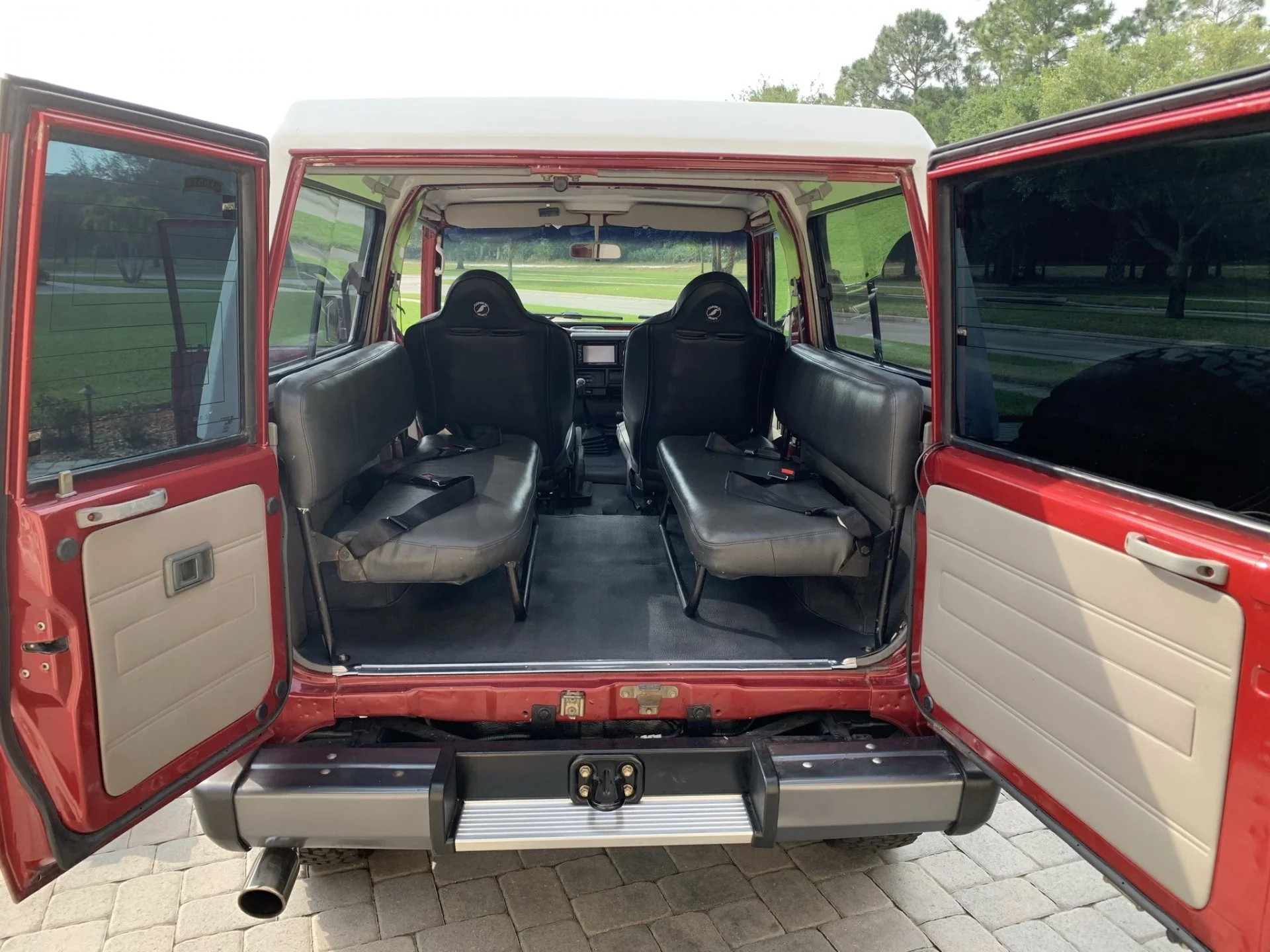

Just installed new seats into my FZJ73. Had to get the seat mounts for the new Corbeau seats designed and fitted by RCI Jeep in Melbourne Florida.
View attachment 2668749View attachment 2668750View attachment 2668751View attachment 2668752View attachment 2668754
Where did you find those vinyl aftermarket mats ?
I'm not sure if you saw, but Cruiserparts (I knowwww) is selling complete, basically brand new, 79/76 series grey vinyl carpet sets for DIRT cheap. You'll also have to get that cup holder up by the shifter cause its from the 2007+ models.
Are they LHD or RHD? Last time I looked around that site, they were LHD?
A lot of Cruiserparts sources originate in the Middle East so I’m guessing the bulk of their items were removed from LHD Land Cruisers.
79 and 76 are different floor pans . 76 might work kinda on a 73 if you trim it here and there , shifter holes won’t line up neither
I thought they were the same second row and front .?
73 has a H55 and most of the 76/79's come with either R151 or H152 and the shifter locations are different , floor panel between front and second row will be completely different between 73/74 and 76/77

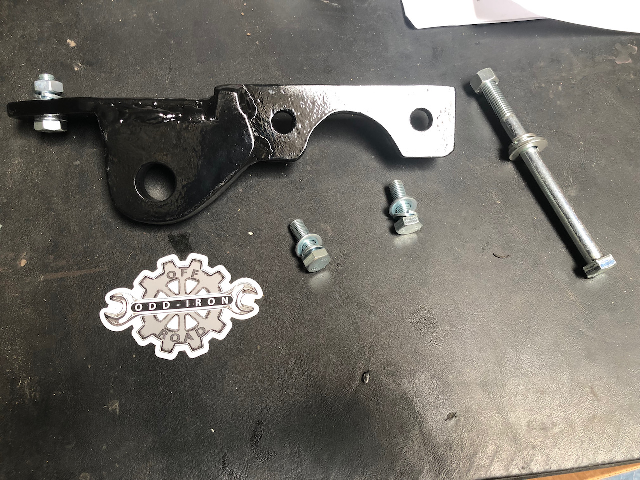

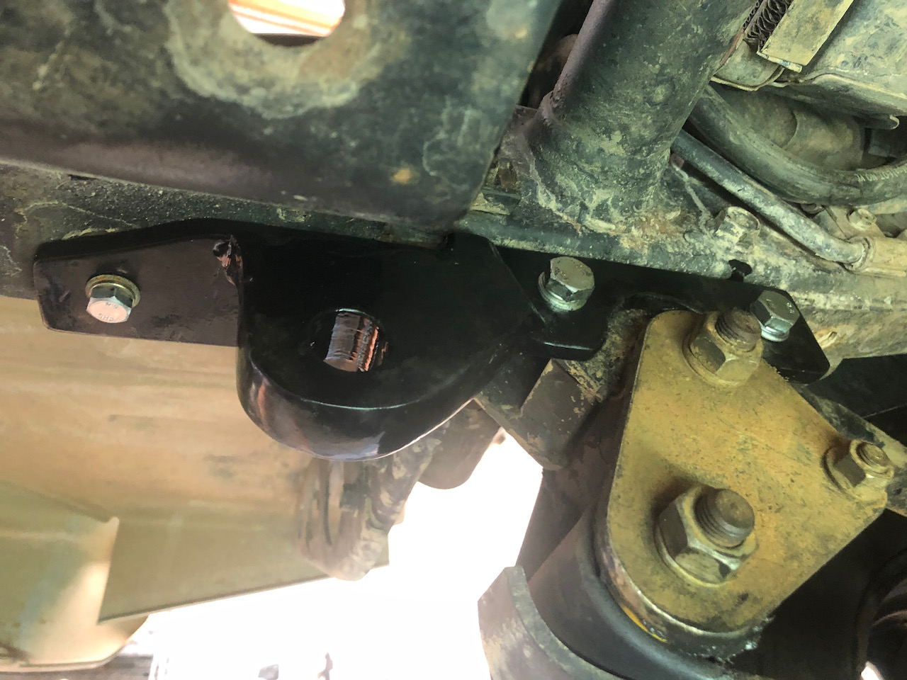

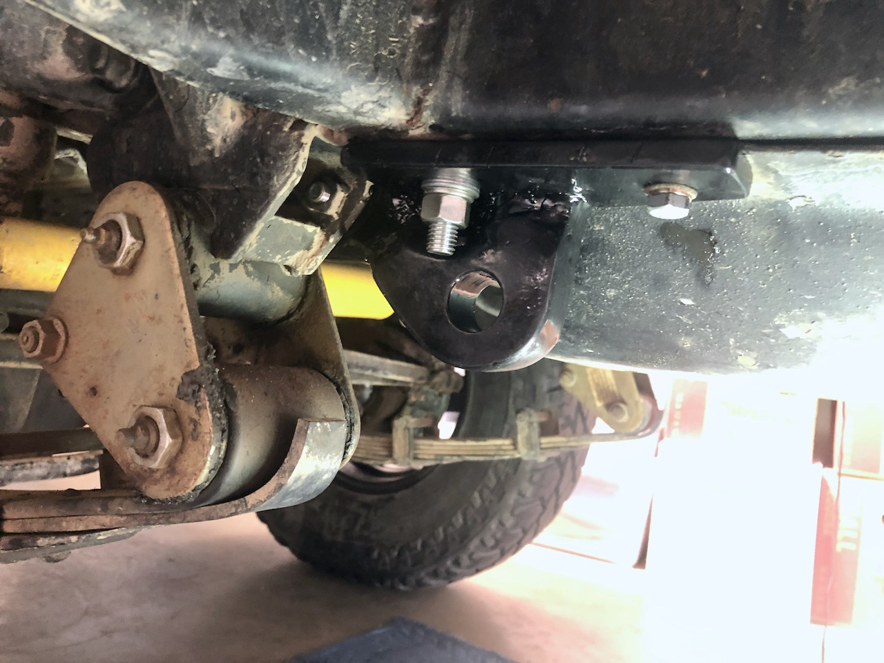

Added an Odd Iron Off Road recovery point to my BJ74. Probably should have read in more detail before pressing the buy button...and bought 2 recovery points. Until I get another on order, I'll just make sure I only need to be recovered from the front right corner!
Rob made this specifically for trucks like mine with the front porch and factory PTO (as opposed to those made for ARB bumpers as discussed elsewhere by @Gun Runner 5 and others).
10 minutes later
By far the cleanest part of the truck

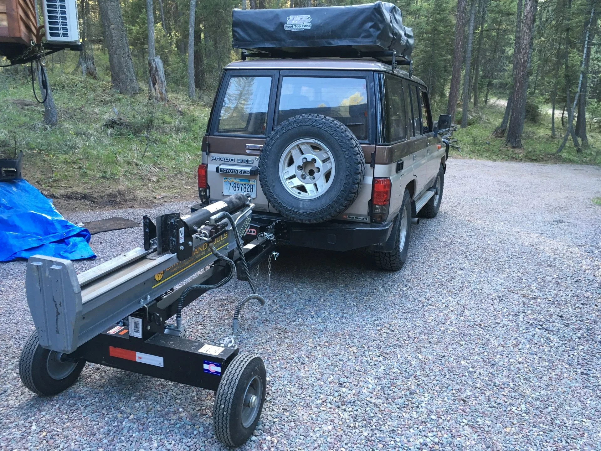

Got to try out my new hitch for the first time.

You need to get some dirt on that recovery point. 😊
