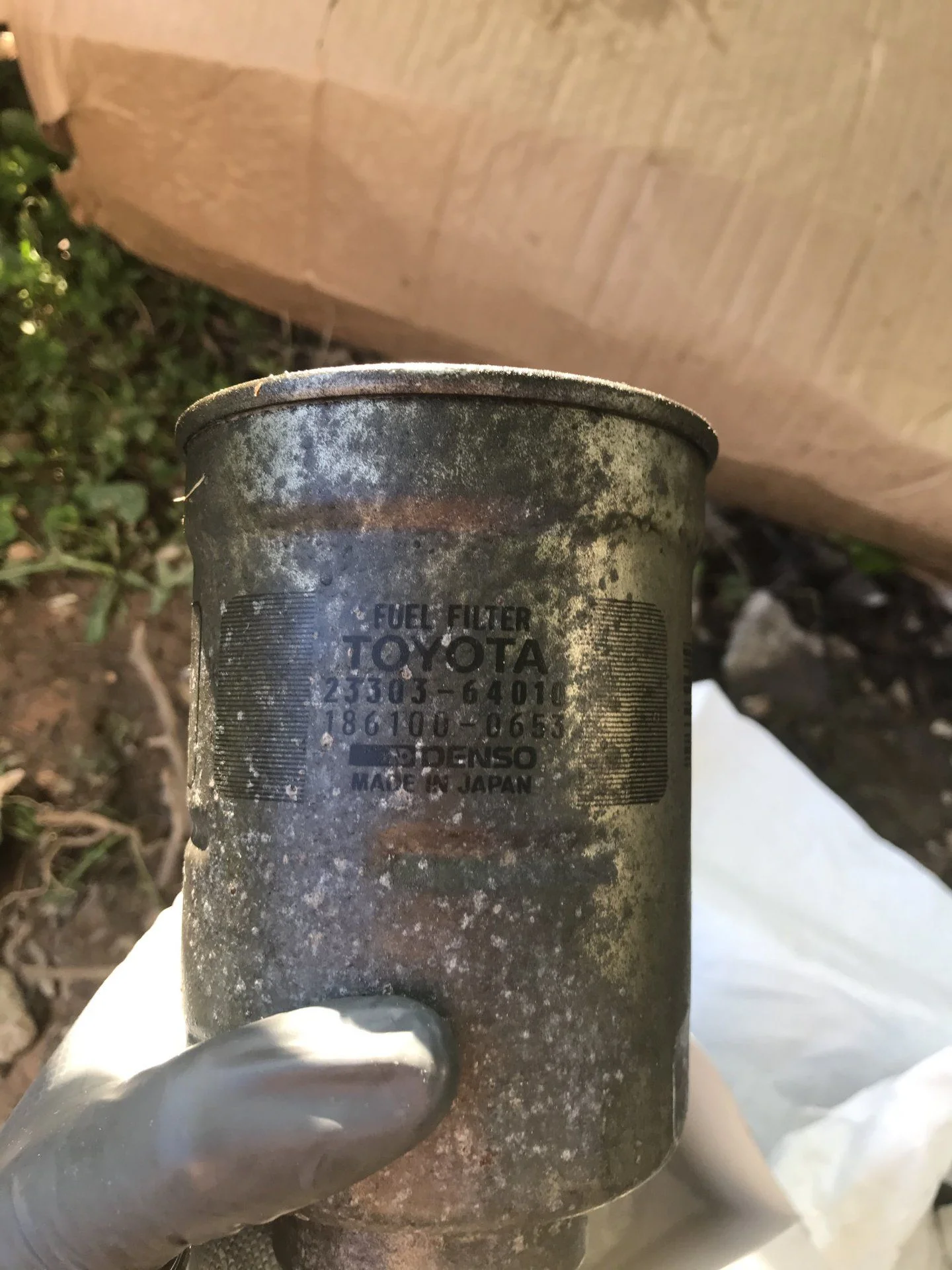

Replaced my fuel filter. I know, I know, it’s not a Toyota brand filter. :deadhorse:
It was way overdue.

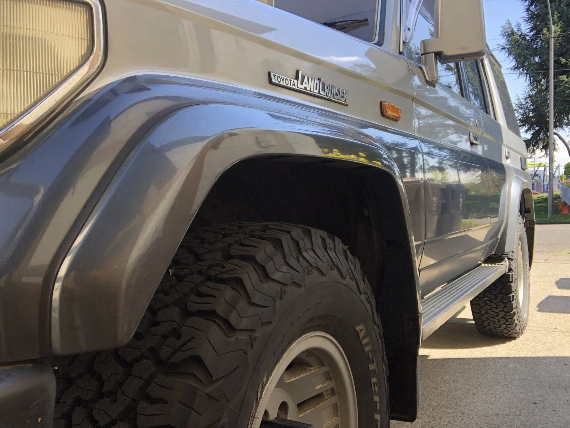

Slimmed up the look some. Removed the side paneling and side steps. Glad I did, some minor rust that needs some cleaning up. Prepping for new bumpers and sliders soon.

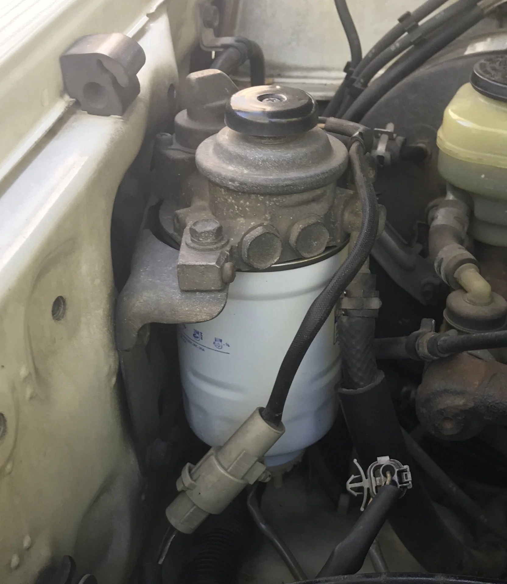

Link to that tool? I used an awkward strap wrench - hadn't seen that one in looking around and much easier to fit in the tight space!
worth every penny!

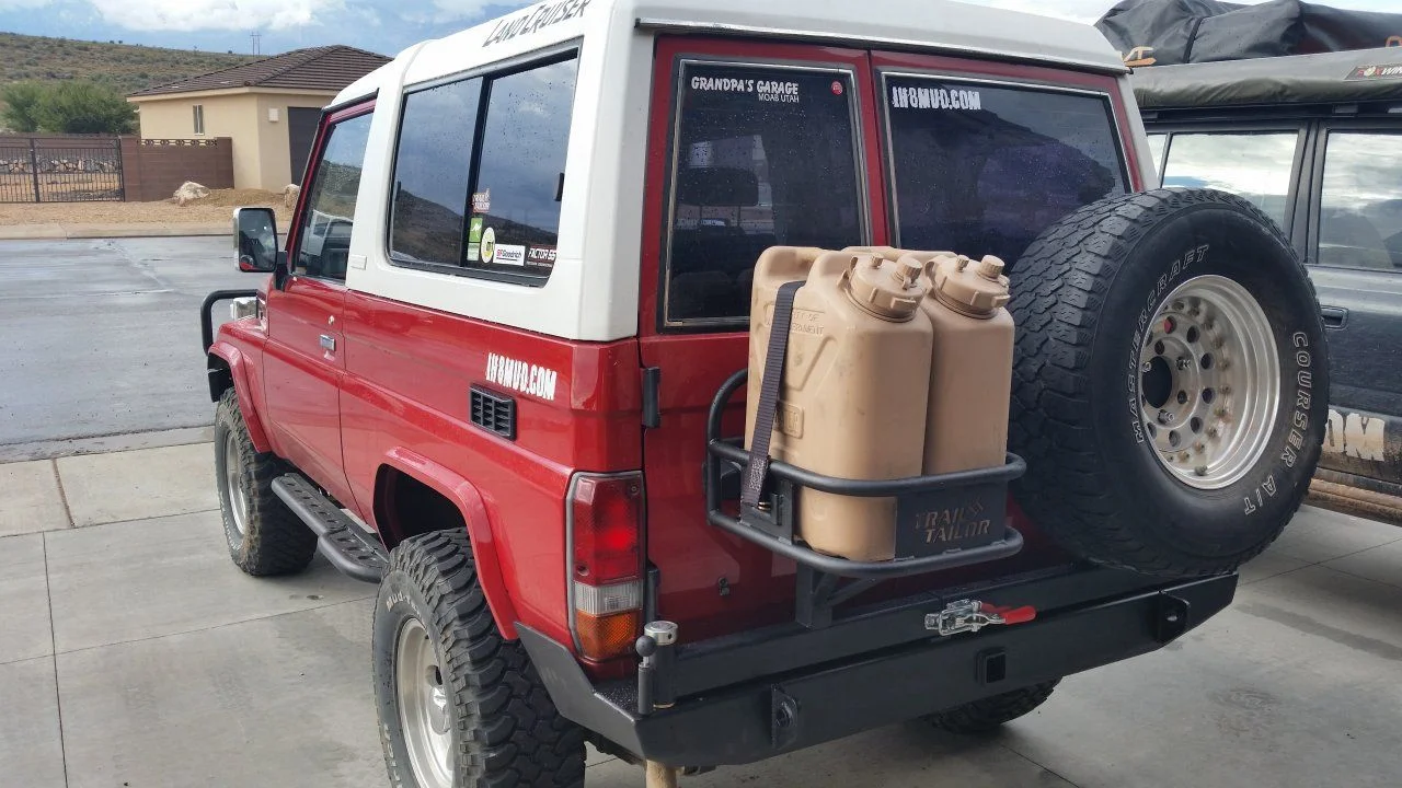

Getting some parts in trade for R&D. Since we moved to CA I constantly get requests for 70 parts. We will design as much as possible in the time we have it. But the bumpers and sliders are the main ones.
Secondary are tow/recovery points, skids, additional suspension items and interior panels.
Jason
Like that bumper. It's similar in function to what I'm going for, but looks better than mine will. One thing I plan on doing is when I make my swing out in front of the small rear door I'm going to make something so that if someone has to open the door from inside to get out that the door will hit the release latch on the swing out so they aren't trapped inside.
Jason
Very few bumper/slider/skidplate options currently for the 70 series Jason. You might have a good market.
Hopefully... I built a dozen or so of these bumpers and then crickets for months.... Maybe with time and more being imported there is a market now. I'll roll the dice one more time for a while and see what happens.

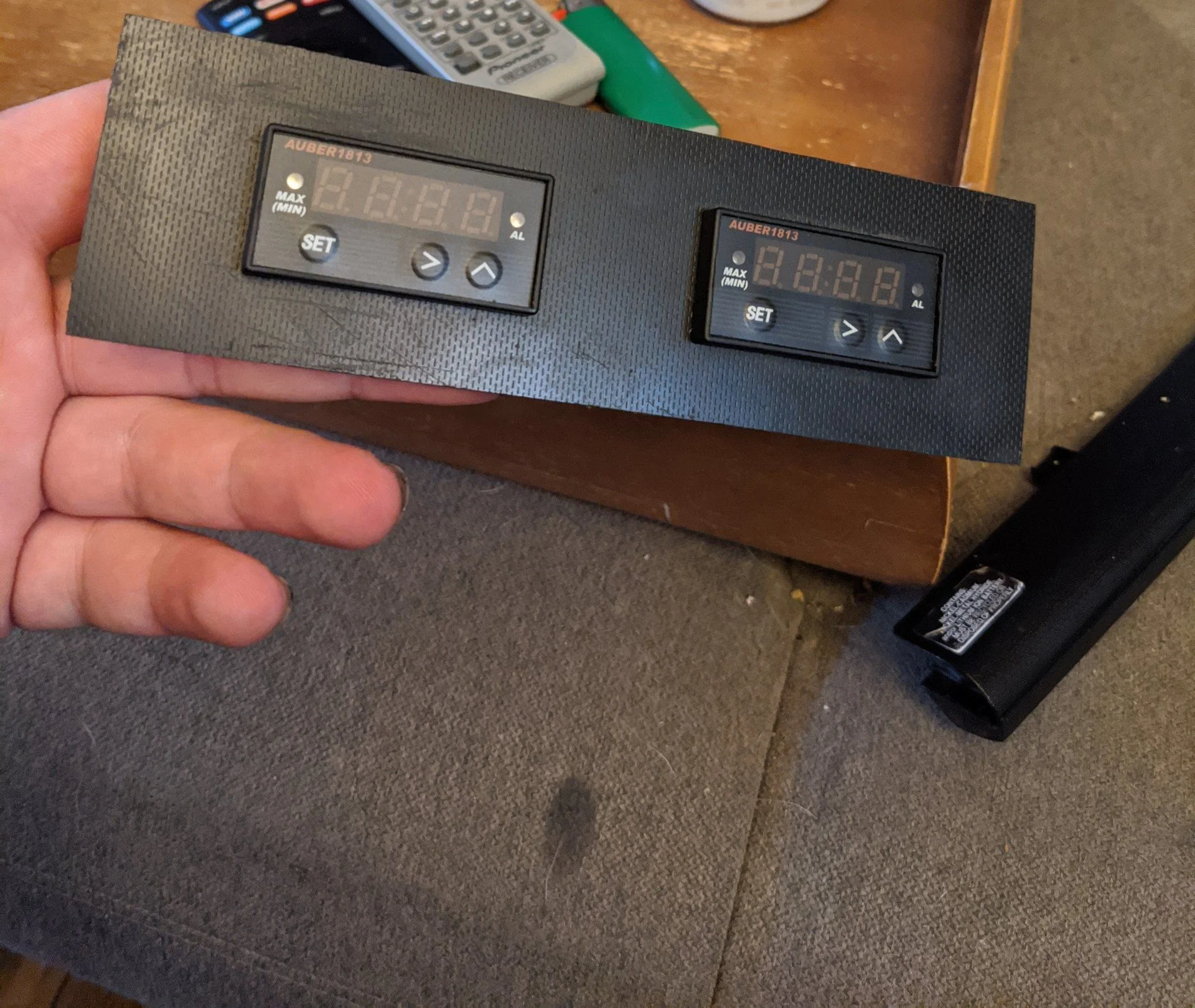

Made a plate to hold auber instruments gauges. Egt + boost. Material was taken from a non functional laptop I found. Cut it with a heated exacto blade and mounted it with some screws that held in the motherboard. I think it looks pretty good considering it's made out of trash.
